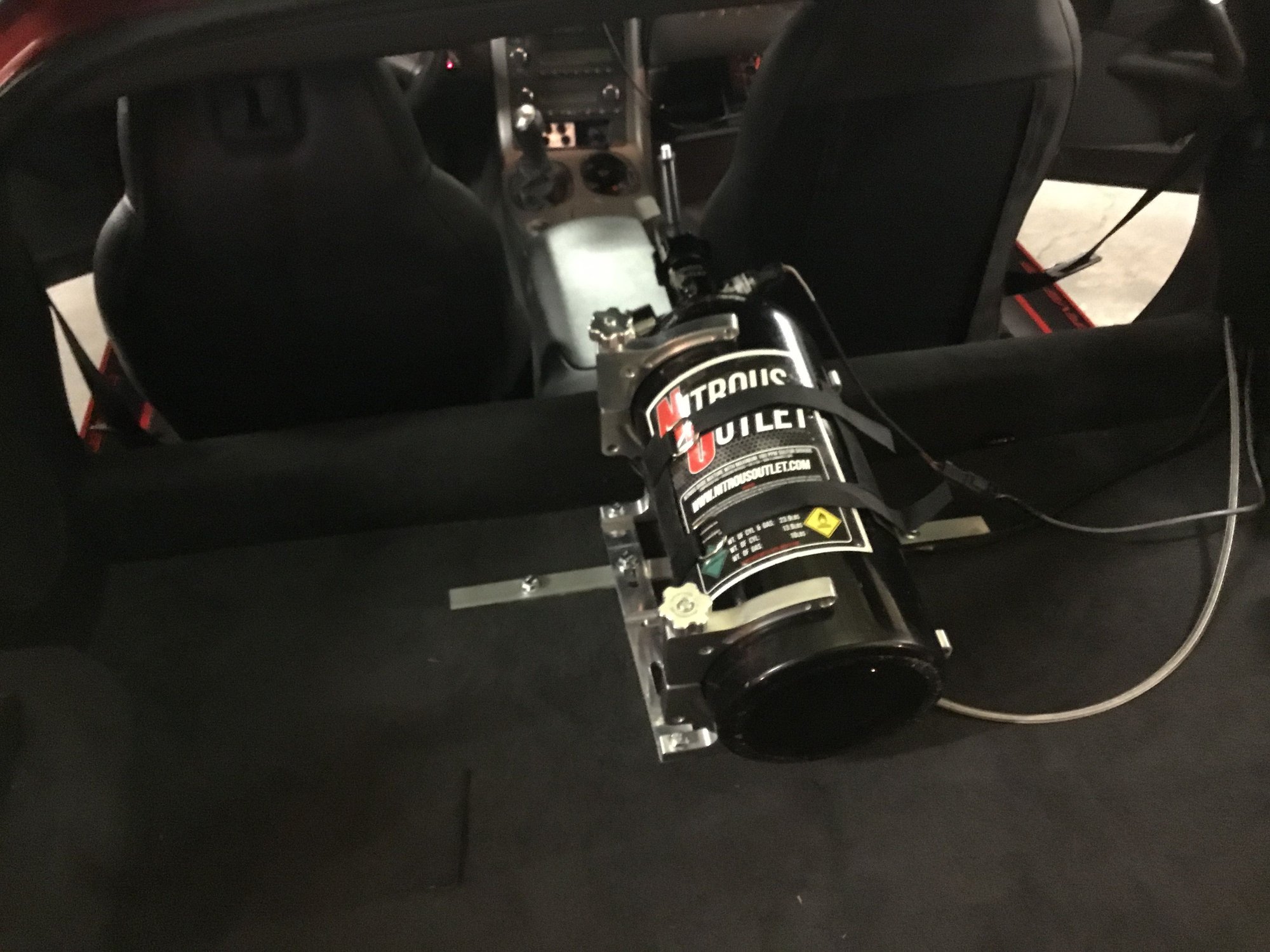

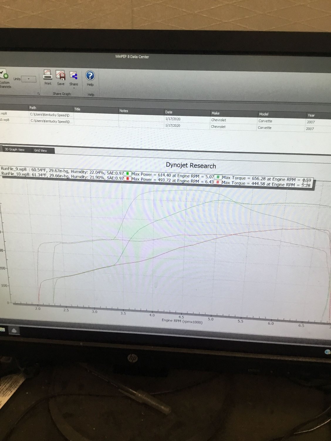

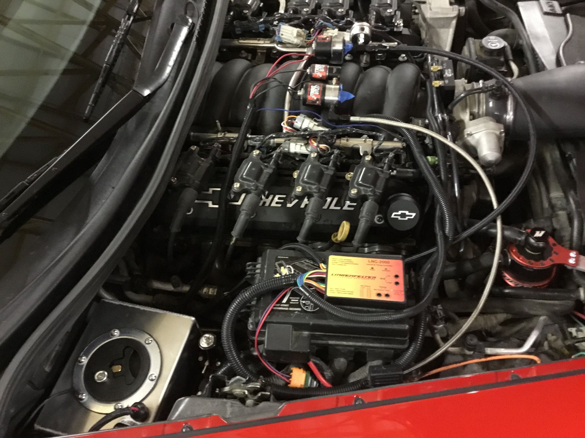

if I don’t this’s bottle will take care of it /the dyno run is on my ls2 Thru a 4.10 on a 150 shot on a conservative tune 8 degrees of timing pulled
