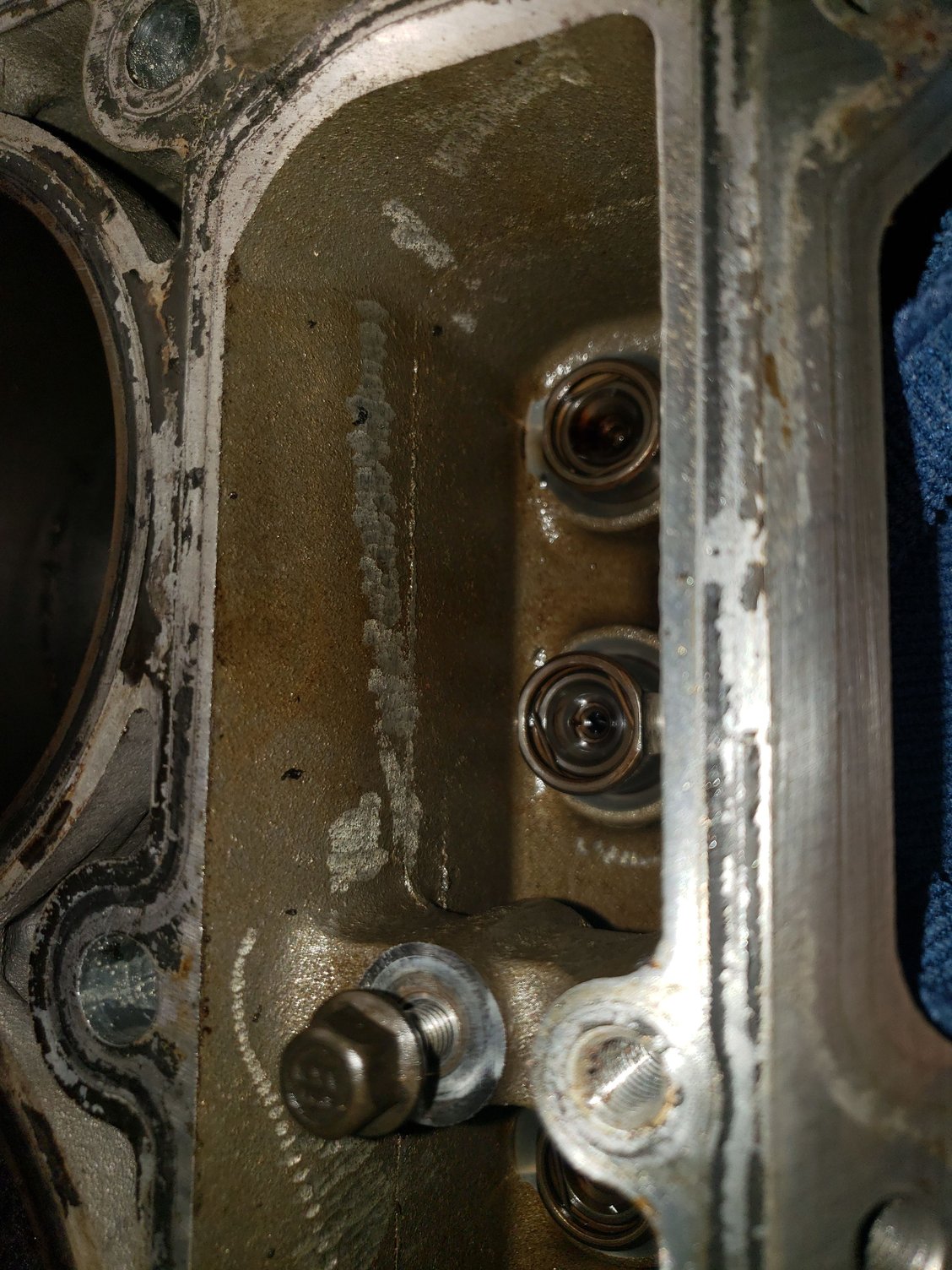

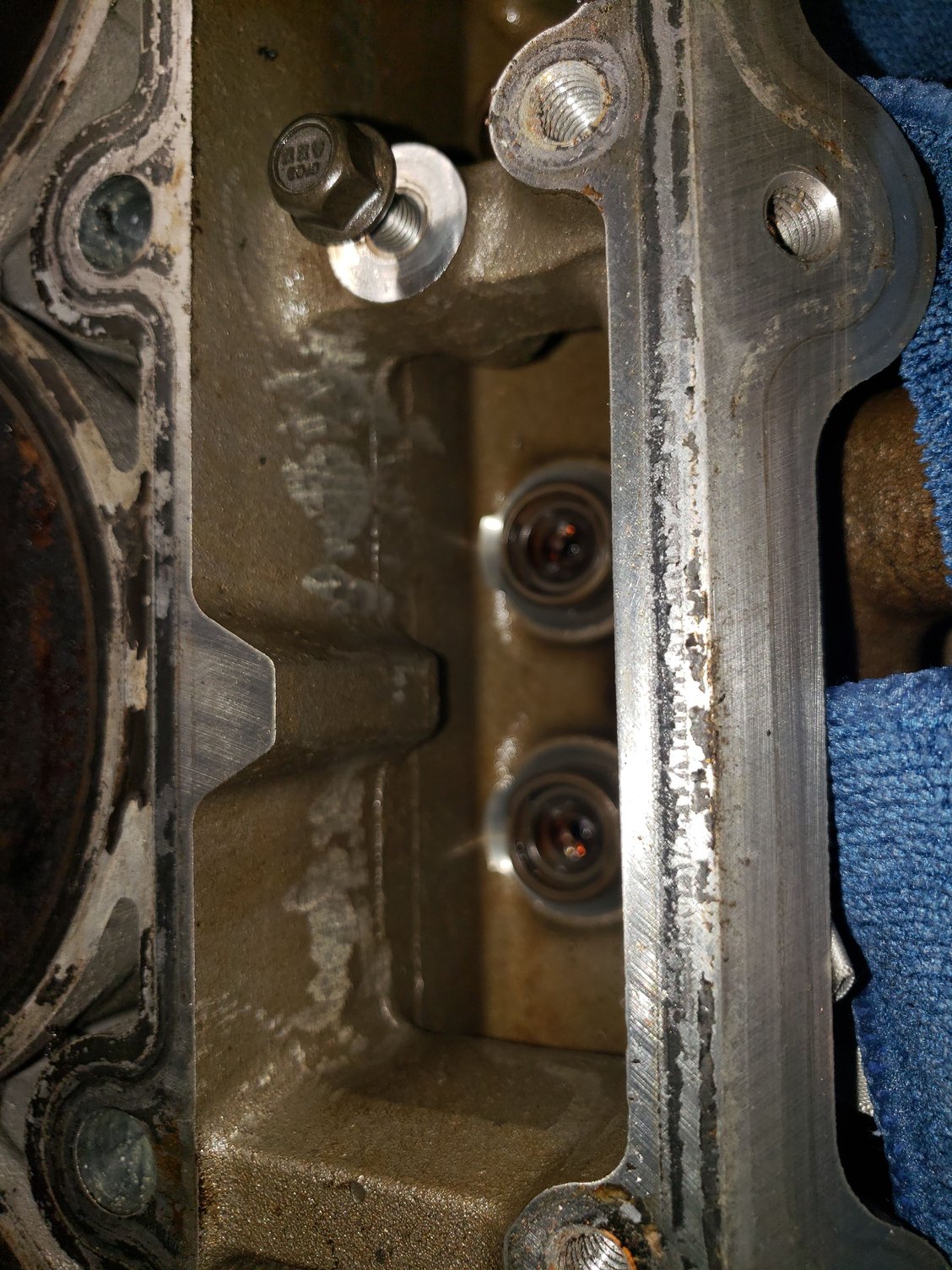

Found these pulling the heads off the ls2 I've had laying around. These normal?

Looks like someone went in with a burr and tried a little clearancing.

those are normal, my LS3 crate motor looks similar

Alright thanks. First gen 4 motor I've had. I figured it was something from the factory. Just trying to understand the history of the motor.

That de burring is done at the foundry. Every block has that done to get rid of casting flash which can end up in the oil pan.
