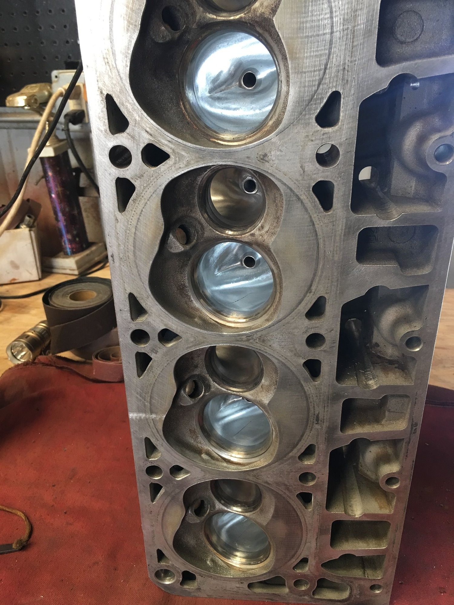

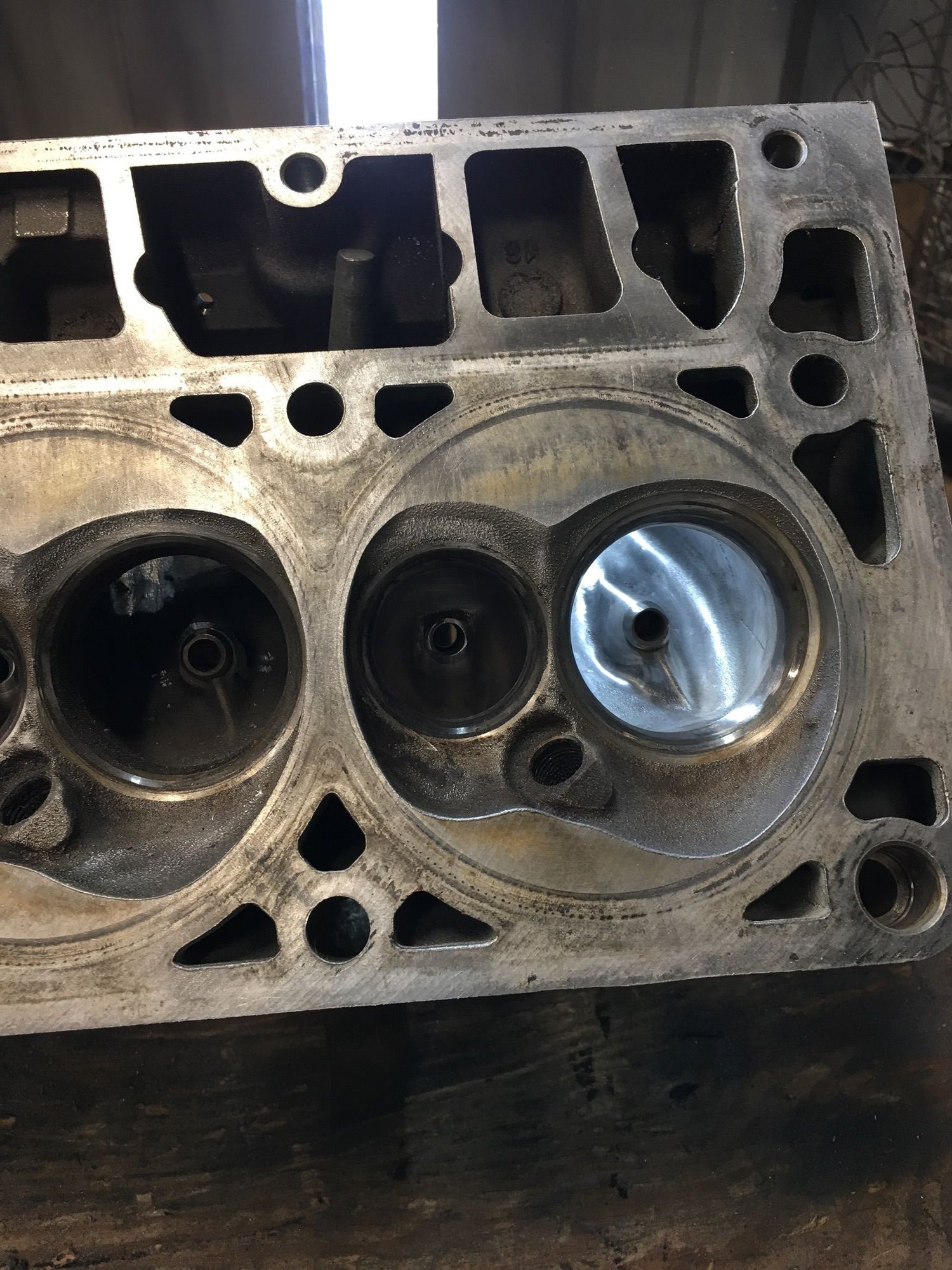

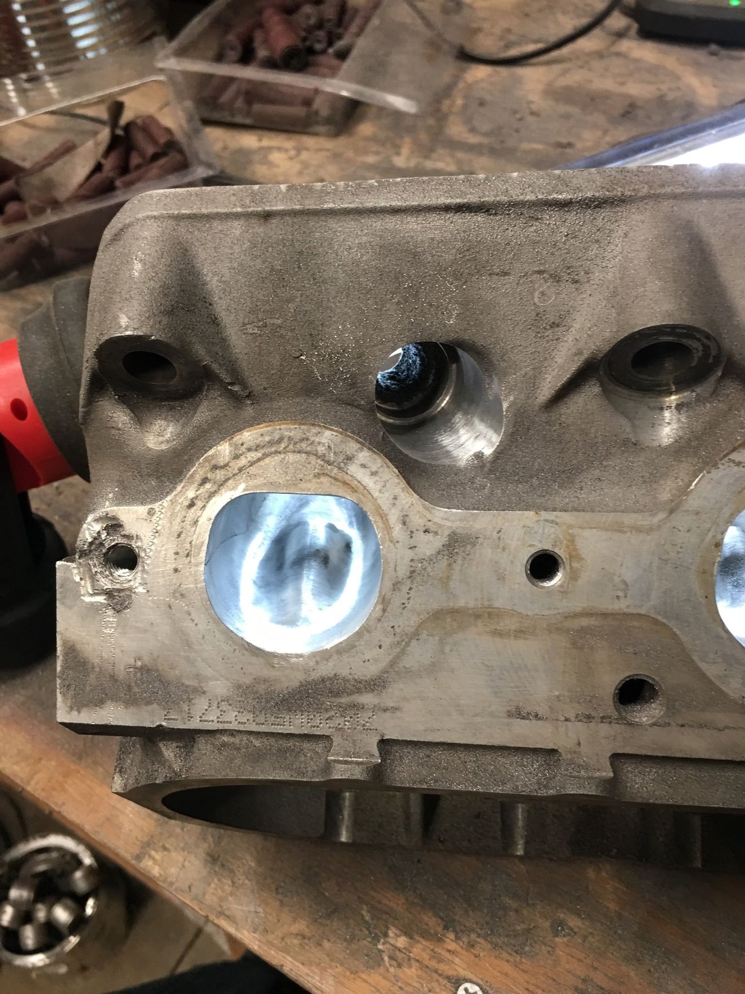

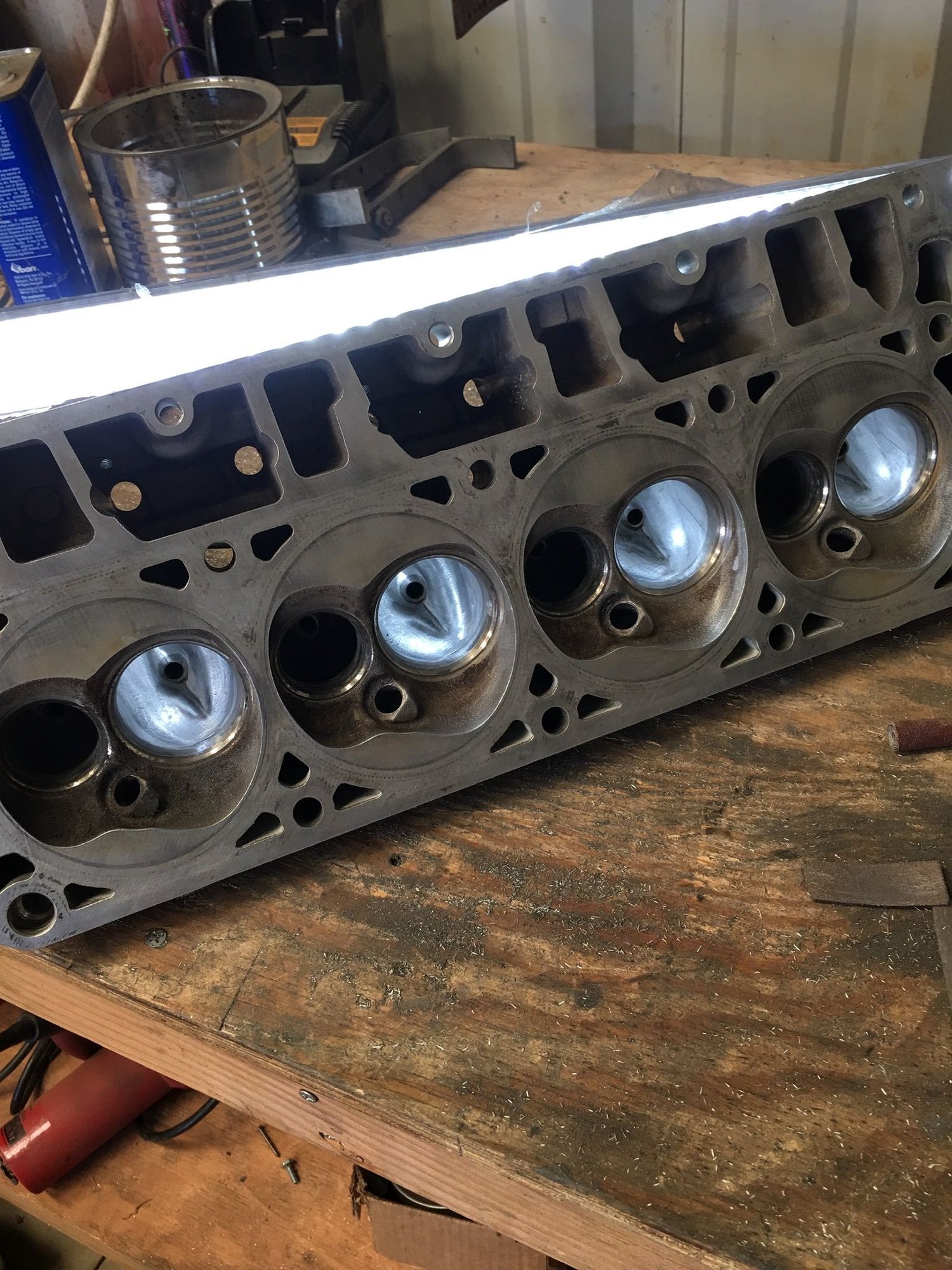

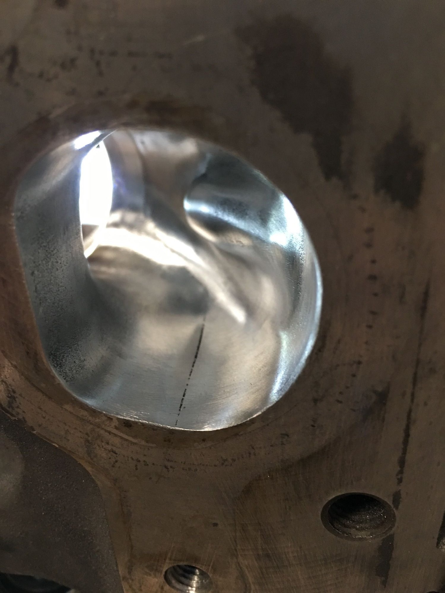

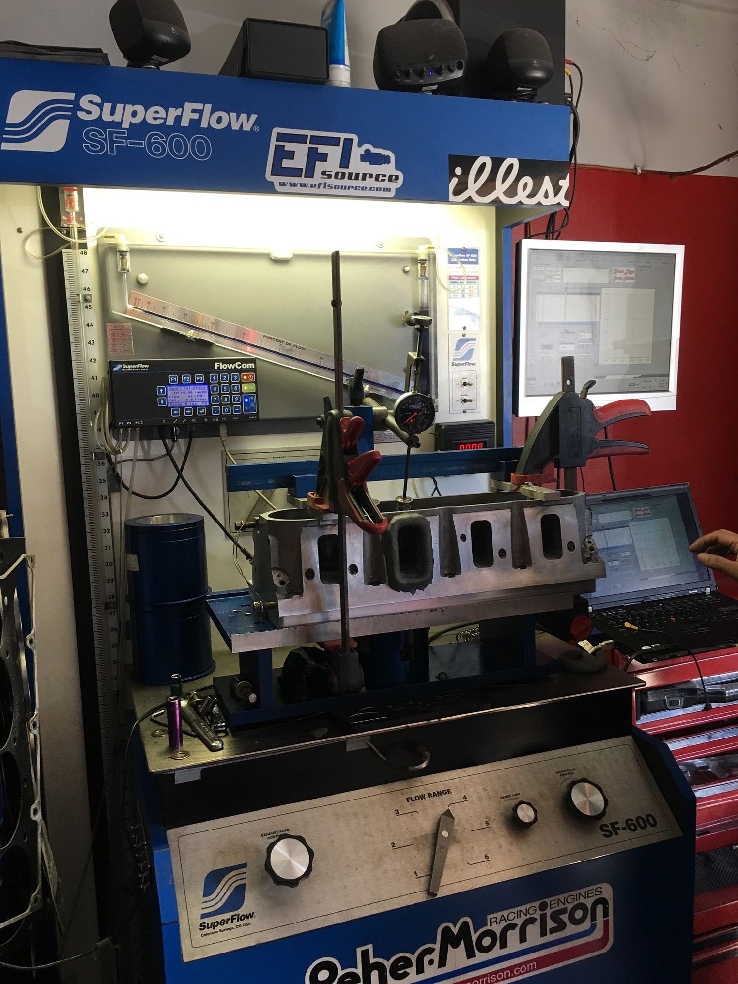

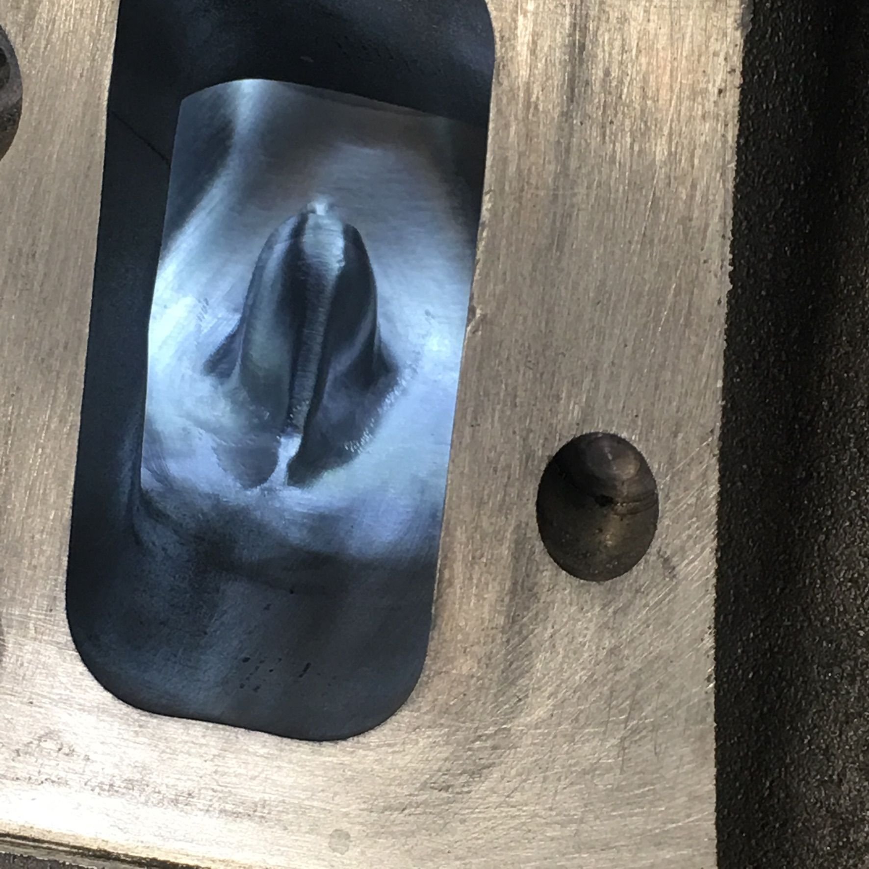

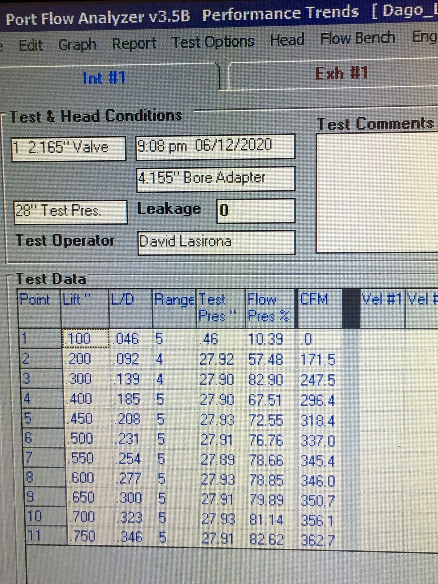

This is a set of hand ported 823 L92 heads for my 377 6.2 build. These were flowed on a SuperFlow 600, the benchmark of the industry . This machine does have a swirl meter and analysis/summery software. This head was flowed with 1/2” radius rolled clay but nothing on the exhaust port. CFM is in the far right column.

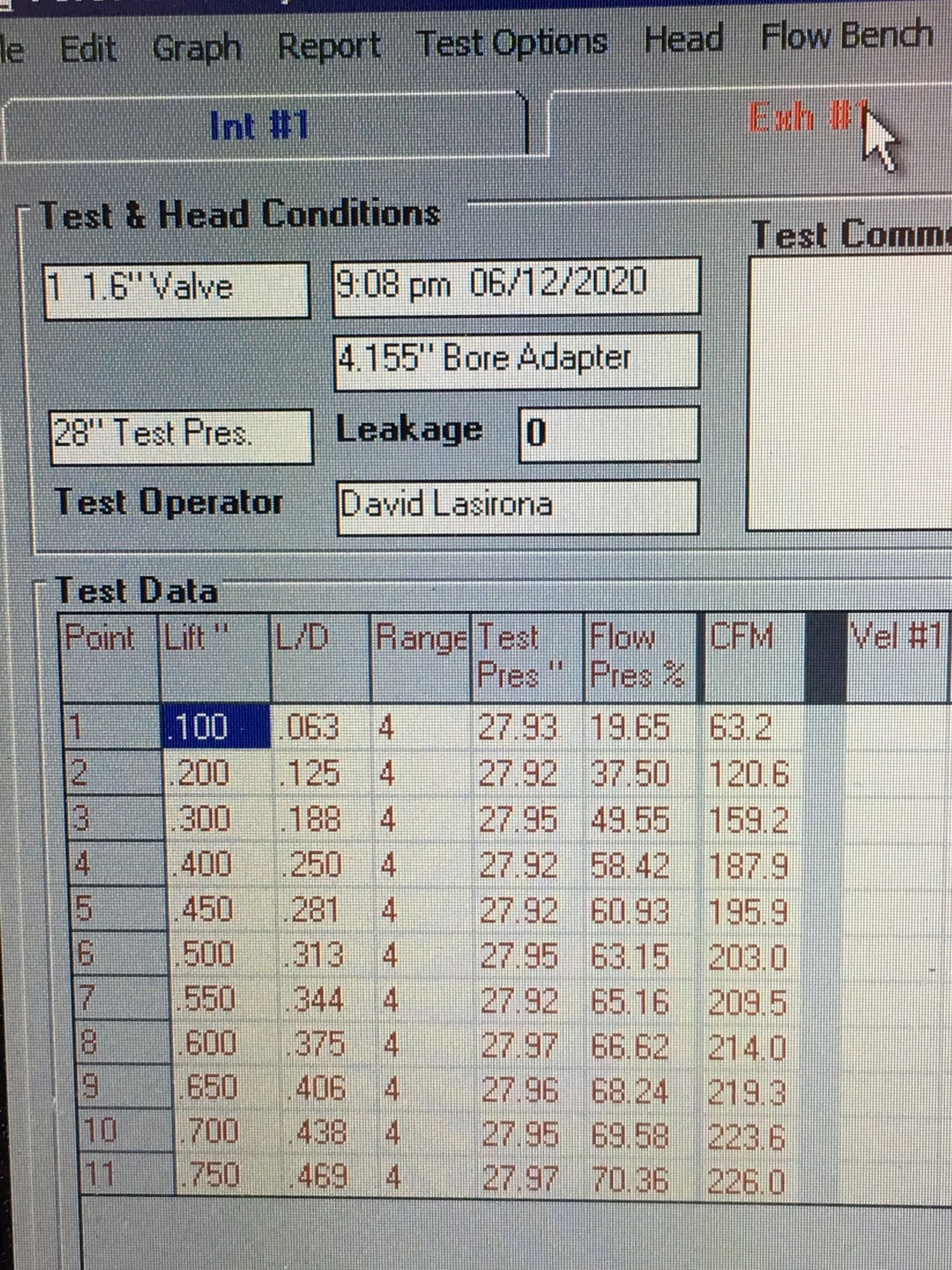

The exhaust.

The reason I wanted to share this bit about hand ported heads was the exceptional .300, .400 and .500 numbers

The exhaust seem a bit hopeless for the amount of time you could spend on them there’s very little return.

Thanks for sharing that good information.
The exhaust flow is certainly quite weak especially with a 4.155 bore plate.
What cc is the intake and exhaust after porting?
That's a 62% intake/exhaust ratio which will require a cam with a good split.

I see that FlowCom on there. You fancy.
How big did you hog out that throat?

I might, the bench owner told me I was welcome to retest the head with out added cost. He also explained to me that a 2” pipe on the head would add additional exhaust flow, maybe 10-15cfm, so maybe a good valve job and headers will help the exh. port flow. I have a machinist that uses a Serdi machine that gives the exh. seat a full radius cut and that is supposed to enhance flow some.

No hogging out, I left the intake runner cross sections pretty much stock size, I removed the many bumps in the port including the huge one on the S shaped wall, streamlined the guide bosses, blend the bowls 360* land leave the short side drop alone, just smooth it. I think it’s a good plan now that I’ve seen the results. That .300 number is ridiculous.
