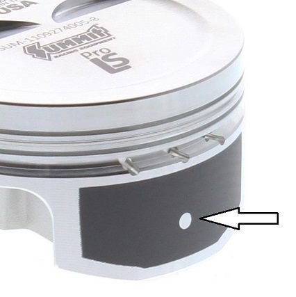

As the title says. Are the stock liners in a stock LY6 ( 4th gen)
any longer than a aluminum block? I know 4.0 stroke pulls the piston out the bottom on 6.0L and 6.2Ls, just wonders if the same is tryy it e for OEM iron blocks too.
thanks,
Jim
The piston is going to be pulled below the bottom of the cylinder with a 4.0" stroke on pretty much any block you go with. With the piston being barrel shaped, what is important is that the largest diameter of the skirt stays in the bore at BDC, not necessarily the whole skirt. Buy pistons from a reputable source, and the skirts will be designed correctly for any of the LS blocks with a 4" stroke crank.
Summit Pro LS pistons, just as an example, show you where that spot it.
