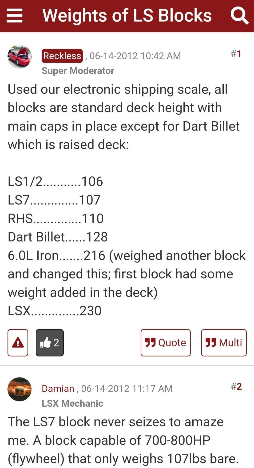

@ez2cdave the 4th and 5th Gens would have been much heavier with an iron block. Add another 110+ pounds just for the block. For every ~100 pounds of extra engine weight according to All Corvette's Red, another ~100 to ~200 pounds of weight gets added in car design for structural reinforcement, cooling, braking, fuel capacity etc at the the OEM manufacturer level. The 4th & 5th Gen would have been between 200 to 300 pounds heavier still with iron V8's 😳
weights-ls-blocks
All the modern tech adds weight it seems. Dual air bags, ABS, better stereo systems, traction control, stability control, more standard features, seats with lumbar support, car area network, (computer controlled ash trays anyone?) etc...of course most of the new car buying public wants lots of tech and nice comfortable options etc.
