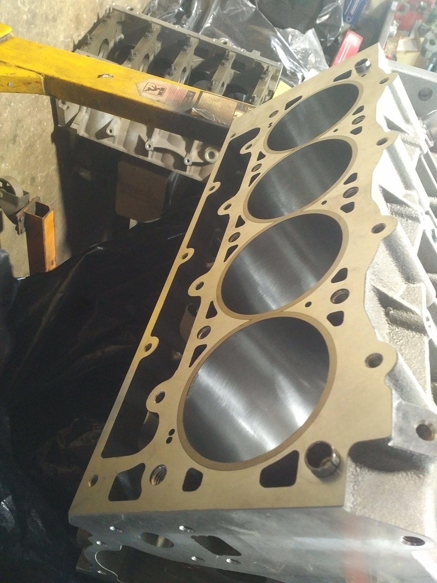

Here you go, this is what you should buy. Dart LS Next Alum block. Around 5k for just the bare block, but worth it. iMO, the Comp Dart 427 is overpriced. It's a nice Dart Iron block stuffed w/ China crank/rods and off the shelf pistons. Assembly is IDK. You have options, though. Another thought is a lightened Dart SHP iron block, there is a shop that CNC's up to 70lbs of iron off to get the weight better. It's $$$, and close to an alum block by the time you are done, but not horrible. Just depends on budget. IMO, you can just build a 416 LS3 block and put some small bore LS7 heads or 11 degree LS3 heads on it and let it rip. Easy, simple power.
Damn you guys are lucky with the pricing of that block.
That same block down here is $7100 USD bare.
