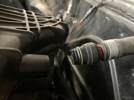

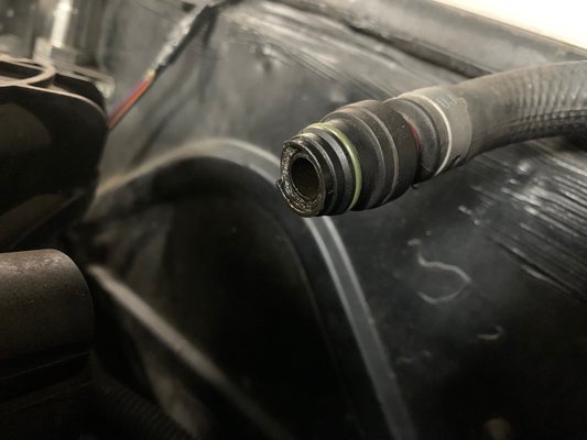

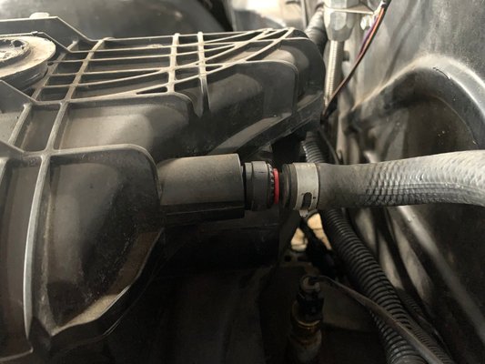

Noticed after seeing a lean condition that this port on the back of my L92 truck intake is "broken" where it connects to the brake booster. After a bit of digging, there doesn't seem to be a replacement for this part available (only the part that goes into the push lock), which is weird because there is an o-ring on this part... Any advise on how to fix this short of gluing it in? Or, am I now in the market for a new intake?

Not sure if the dealer can help you, but you could easily pull that part yourself from any yard with a similar intake. No need to buy an intake.

Tap the hole with a pipe tap and screw in a hose barb.

Nothing to fix. Again, the barb that’s broken is a removable piece. You slide the red collar toward the intake, and the barb pops out. It’s a quick release mechanism. You could pull the piece at a junkyard in like 2 minutes. Easy peasy. I might have one here. I’ll check tonight. If so, I’ll PM you and send it to you for free.
Thanks man. Yea, let me know. Take a look at my pics again. The removable piece that fits into the red push lock connector isn’t my issue. It’s the housing that the red push lock connector lives in that appears to be broken and now just wobbles inside the intake. It’s this housing, that I haven’t been able to find a replacement, and mine is the only one I’ve ever seen detach from the intake.

JB QUIK works great on many repairs so i would JB QUIK it to piece back.
