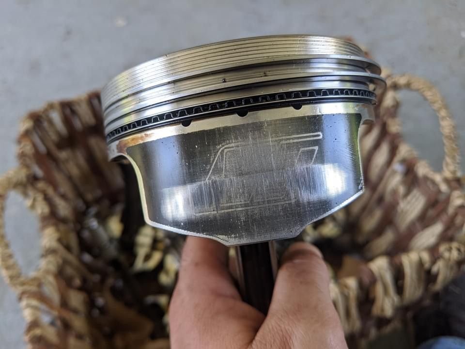

I saw a post on facebook where a guy posted this:
”Stroker skirt wear post. Yes the skirts come out of the bore on 4" stroke motors, yes the skirts wear out but it's not as bad as some would make it seem. This motor was built back in 2011 and ran hard for 9 years. Numerous road trips and street cruising/beatings and probably 40-50k miles. Here's a pic of one of the "bad" skirts and a pic of a better one. 403ci lq9 with l92 heads made a little over 1000whp with an 88mm turbo. Motor finally gave up with a spun rod bearing last season.”

Summit LS Pro pistons for 4” stroke applications for the win!
Great example here of skirt wear in a properly setup stroker application. I’ve seen way more wear in 3.6 stock stroke engines with similar mileage. Piston design has come full circle for stroker applications as manufactures have found how to design the barrel of the piston properly. Wiseco led the way in this a decade ago, or more. Great post!
