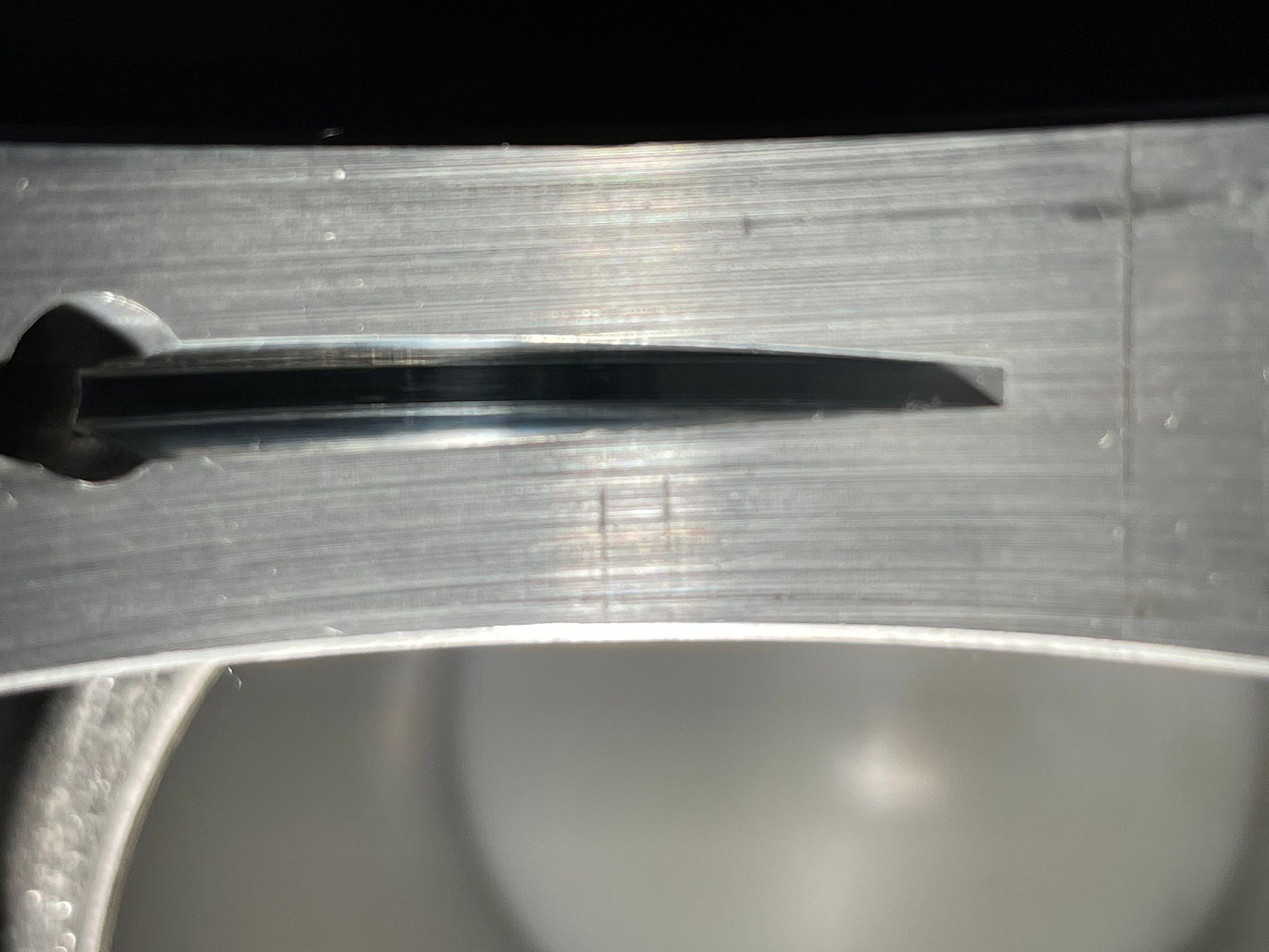

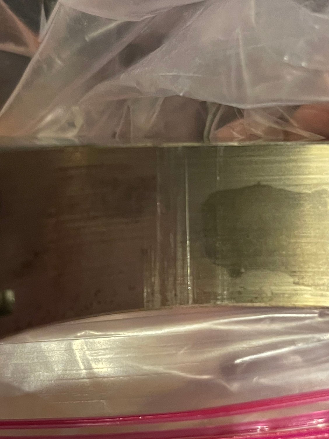

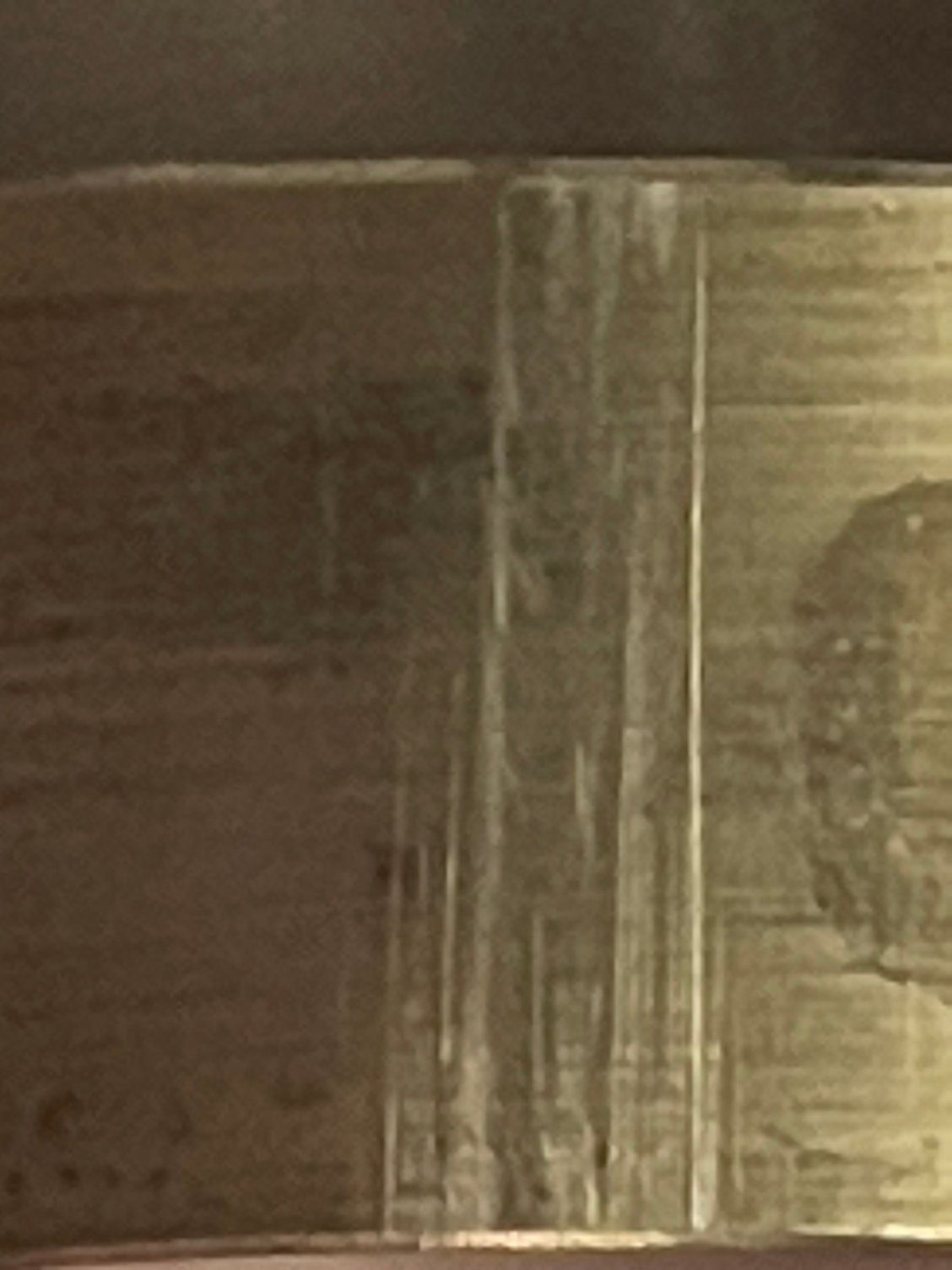

I recently noticed that, after having my block bored, there are scratches on the bearing saddles of my number one and five main caps (which would have been used to fixture the block to have it bored)
There are also some slight scratches on the block at the rearmost main saddle.
The machine shop says this is nothing to worry about, and that they can just be sanded down. However, these scratches on the main caps are directly in line with the cylinders. In other words, they are the spots that will receive the blunt of the blow when the cylinders fire. This is probably not the best place to have a low spot (ie a void) under your mains. Should I take my block to a different shop and have it align bored to correct this (which would also allow me to run ARP main studs!)?

Polish them out with some emery cloth. As long as the bearings seat in them you will be fine. Align boring or honing .not necessary or even desired

I would lightly wet sand those with fine emery or 600 wet dry using WD40 or similar snd see what you think.
If not happy, a very light line hone would not hurt.
I’ve noted that shops are not careful enough with alum blocks. It’s very easy to scratch the machined surfaces.
