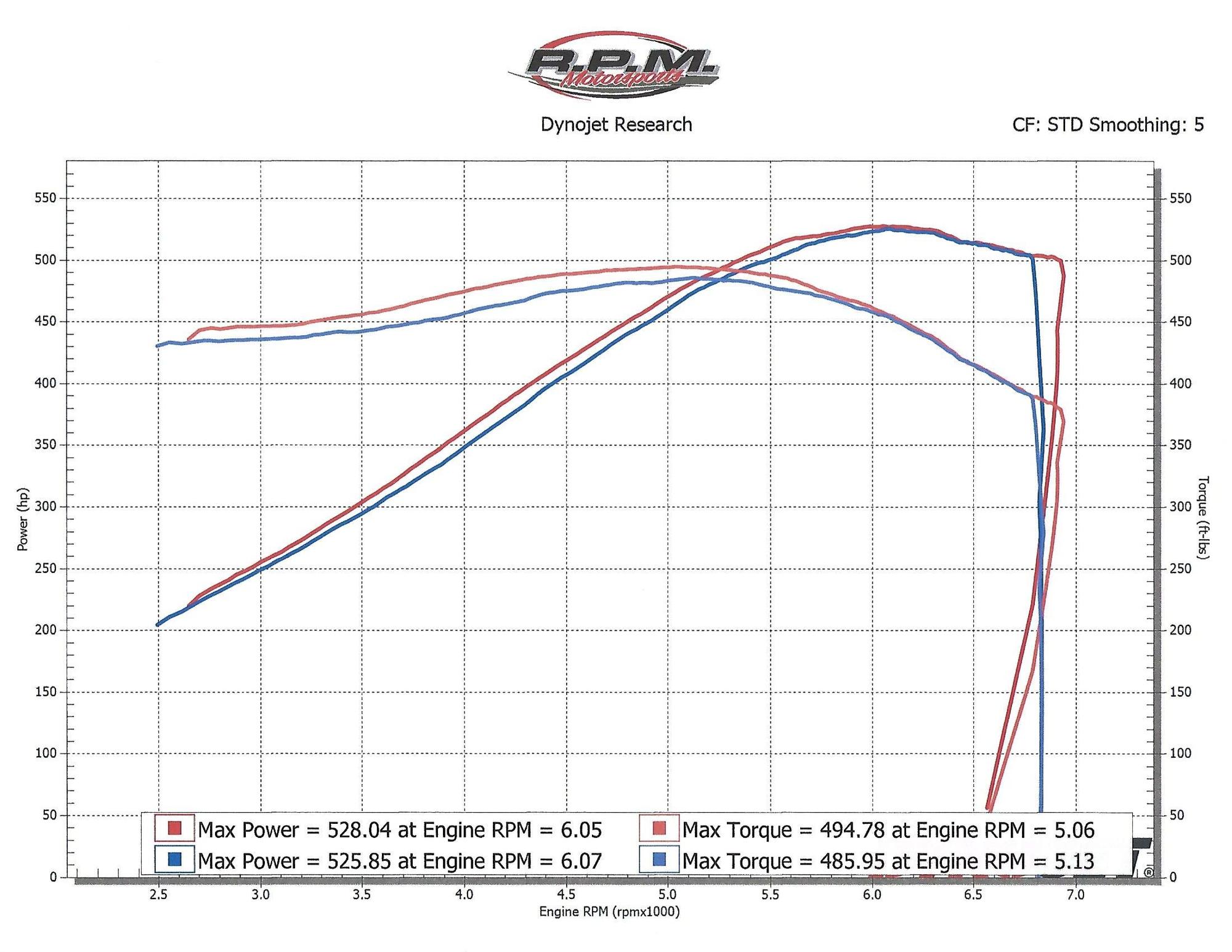

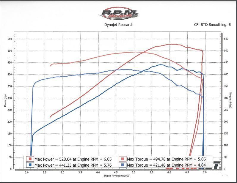

Results:
Changes/Updates: Gutted Cats (gain) and Richening the A/F from 13.2:1 to 12.5:1 - or - .90 lambda to .85 lambda (loss).
SAE Numbers Were 520/485
Driving Impressions:
The car looks like stock, sounds like stock, drives like a very angry version of stock (made more power than expected). Between 3.5-6K RPM its a totally different car, the 345 Michelin's are not up to the task in first gear and second gear requires some 'care' from 3.5KRPM up. Putzing around town, the car is more punchy/ fun in 2-4 gear from 2-4K RPM. Gutting the cats made a tremendous difference in throttle response/ how freely the LS7 revs (+15RWTQ from 2500-5500rpm). First gear is not usable, needs some Nitto NT-01s.

Funny I did a stock cam build with AFR 205 heads on a c5 zo6 and made right at 405 whp SAE which was the rated flywheel number. You did a similar build with the LS7 and made 515whp SAE vs 505 flywheel. The LS7 exhaust and cats on my C5 sounded fantastic, but I also like the sound of headers.
I can confirm these stock cam builds are super fun, and really easy to drive and live with every day.
Driving Impression:
This feels like even more than 15RWTQ and 10RWHP throughout the midrange. The LS7 revs much more freely, feels more like my old LS6 (a shorter stroke lighter rotating mass engine).
