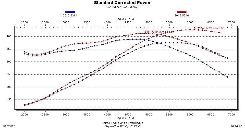

If you are keeping the stock torque converter the tried and true 5.3 cam 212/218 112 or 114.
https://www.texas-speed.com/p-5002-t...-camshaft.aspx
