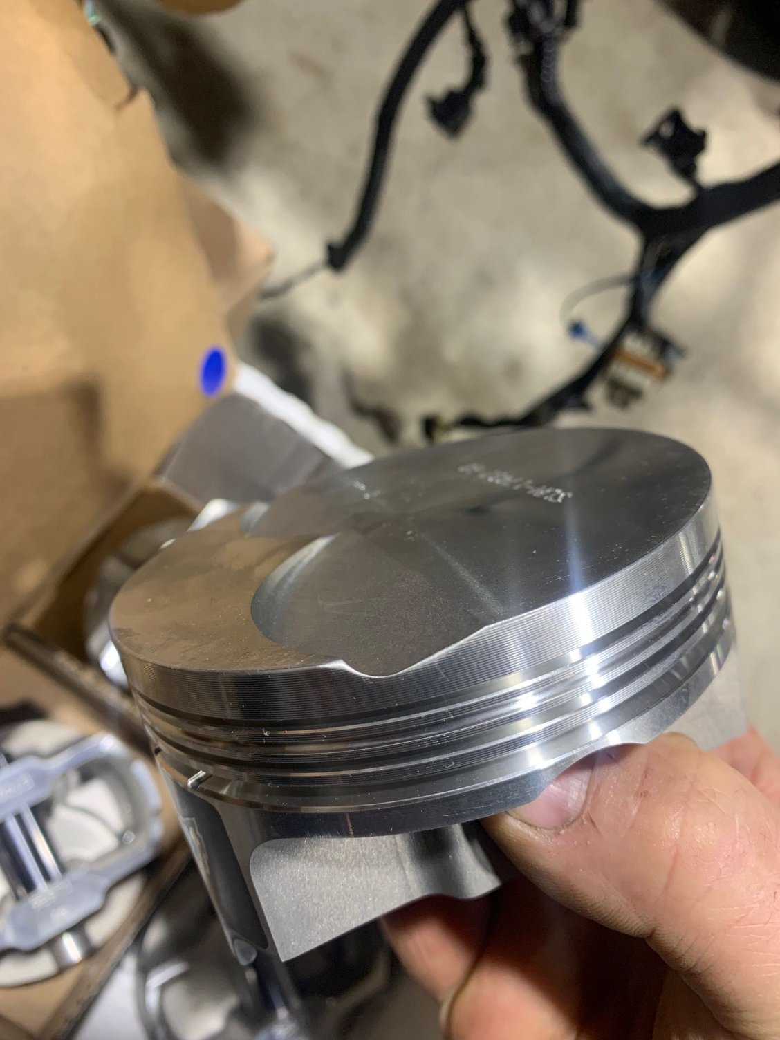

Hey, i am in the process of ordering parts for a ly6 built, stock stroke with a 2650 supercharger, street car with a small cam and ported heads, pump fuel in a toyota landcruiser
I was looking at https://www.summitracing.com/parts/s...make/chevrolet pistons, because they are well priced and in stock. I didn't really want to go to a 2618 piston. Any feedback on how well these are made, or how they compare to Mahle 4032 piston or similar.

They dont offer those pistons in a .010 or .020 and i think .030 is starting to get too big for boost. PLus i was hoping to avoid the rattly forged short life pistons as its primarily a street car. I think 4032 have their place in boosted street cars, its not like people are going to be putting them in naturally aspirated motors. More interested to hear how they stack up against other brands with a similar composition.

Yeah cool thanks Fishmaster. The summit pistons look nice, i wasn't sure about the valve relief cutting down the side of the piston top but it should be ok. I certainly havnt heard anything about them being failure prone.

Looks like a NA design. Not much skirt to be boost friendly and valve relief will surely be a soft spot.
