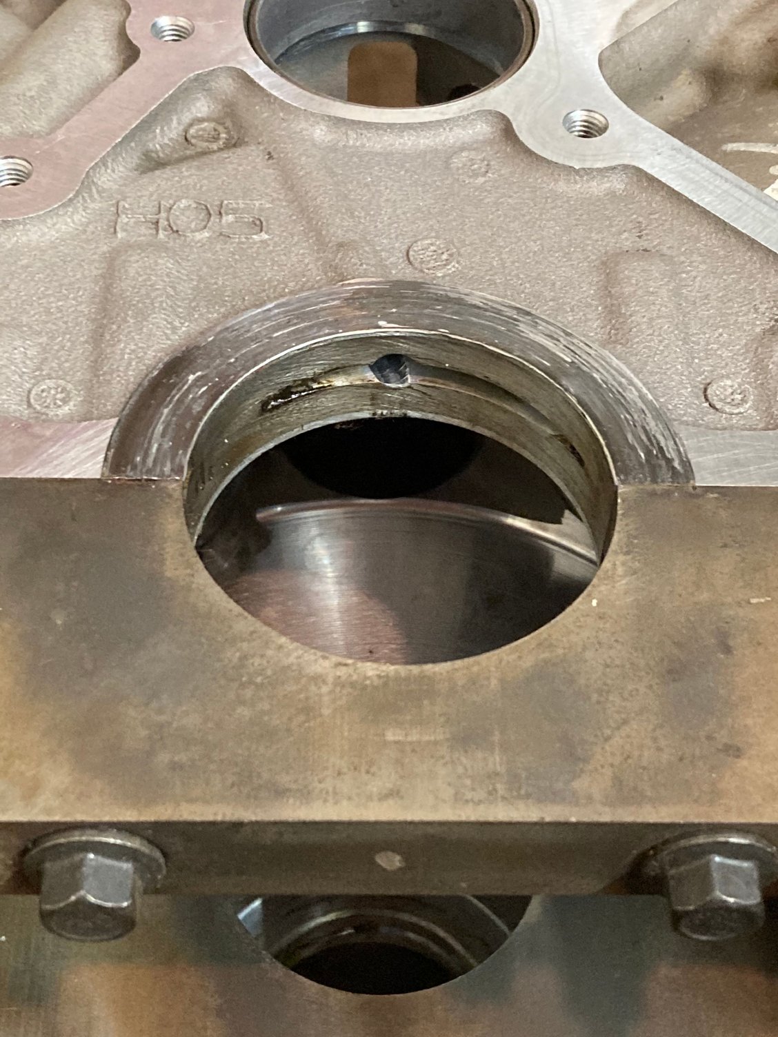

So LC9 block I bought as a spare in case I bust my L33.
I didn’t look it over real close, but spotted this when looking for the casting number.
Inside the rear cover. Machined surface, but doesn’t really do anything.
Cant imagine what caused this? Any ideas?

Flywheel bolt[s] too long?
Thrust gave up, and the bolts hit the block?

Possible thrust failure. The bearings were removed. Didn’t hit the cap, but ya never know on a used deal like this. Thx

After further review, thrust bearing failure is spot on. I can see that the crank throws hit 3 of 5 main bulk heads. 5,4, & 2.
Saw this on my buddies 6.0 when it lost the thrust.

Is the bock still good?
Yes, but not w/o a little effort.
I bought this thinking a great spare, good bores, ect. I was wrong.
What I get for trusting folks, in this case, an engine builder I gave a lot of help to.

Hmm. That's interesting. I do remember that at one point in time someone offered a service that drilled into the oil galley that supplies oil to the main saddle that the thrust bearing uses, thereby feeding pressurized oil to the thrust bearing. I'm thinking it may have been Kurt Urban performance. I think Kurt is at Scoggin Dickey now. I'm sure he could help if you desire that service.....
