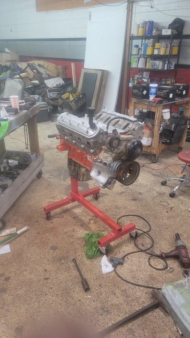

Default It is done
So after lots of research and much help from the community here it is complete will go In in a couple of days 2008 stage 2 cam dod delete new crank main and rod bearings new rings and had to replace some of the rods
