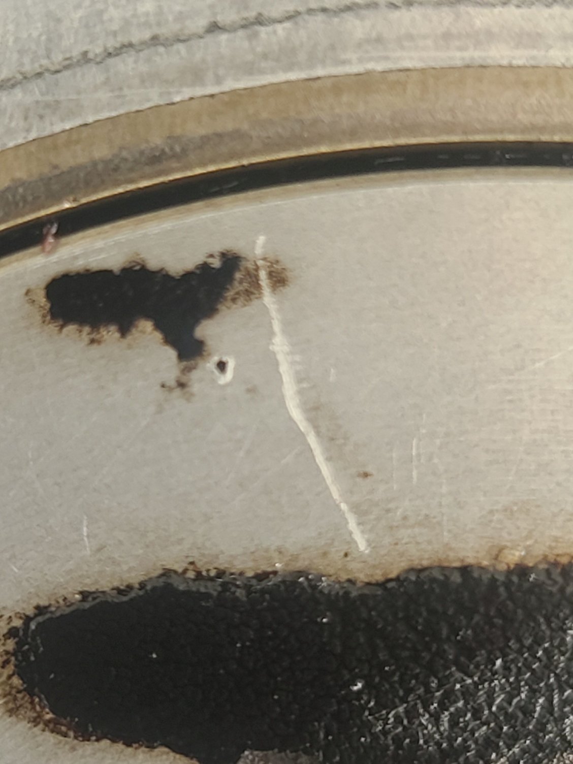

I was cleaning the carbon from my pistons and accidentally scratched one of my pistons. My nail will catch in it. Will this piston still be good or am I gonna need a new one?

All good.

Not to worry; smooth the edges if they need it and it'll be fine.

No worries. It'll be covered with carbon soon.....

This is neither a mating surface nor a bearing surface. A small scratch like that is not NEARLY deep enough to be a problem. Plus, as others have said, it will eventually be covered with carbon. It’s nothing to worry about.

You could take a roll-lock scotch brite disc, maybe blue, and just blend it out, but either way will be fine.
