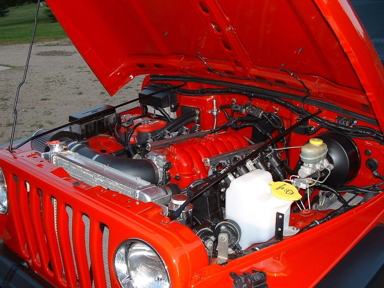

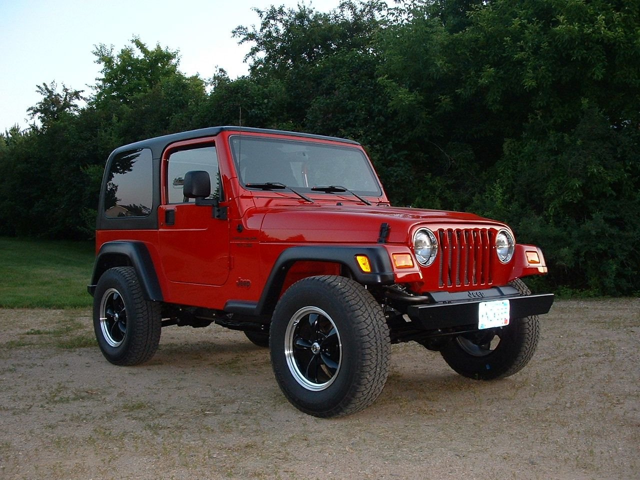

Man that's a tough call on gears. I like my 4:10's. Makes my Wrangler pretty quick off the line. But I have no plans to drive it 4000 miles. Couple of pics of my Wrangler. 14 years and it's been a great swap.

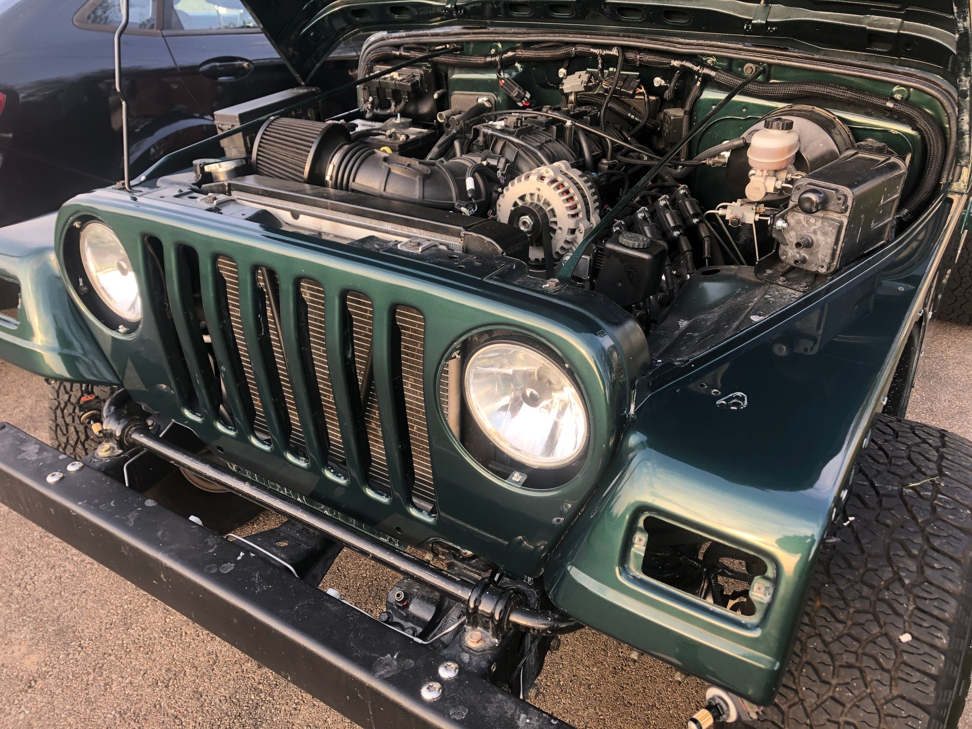

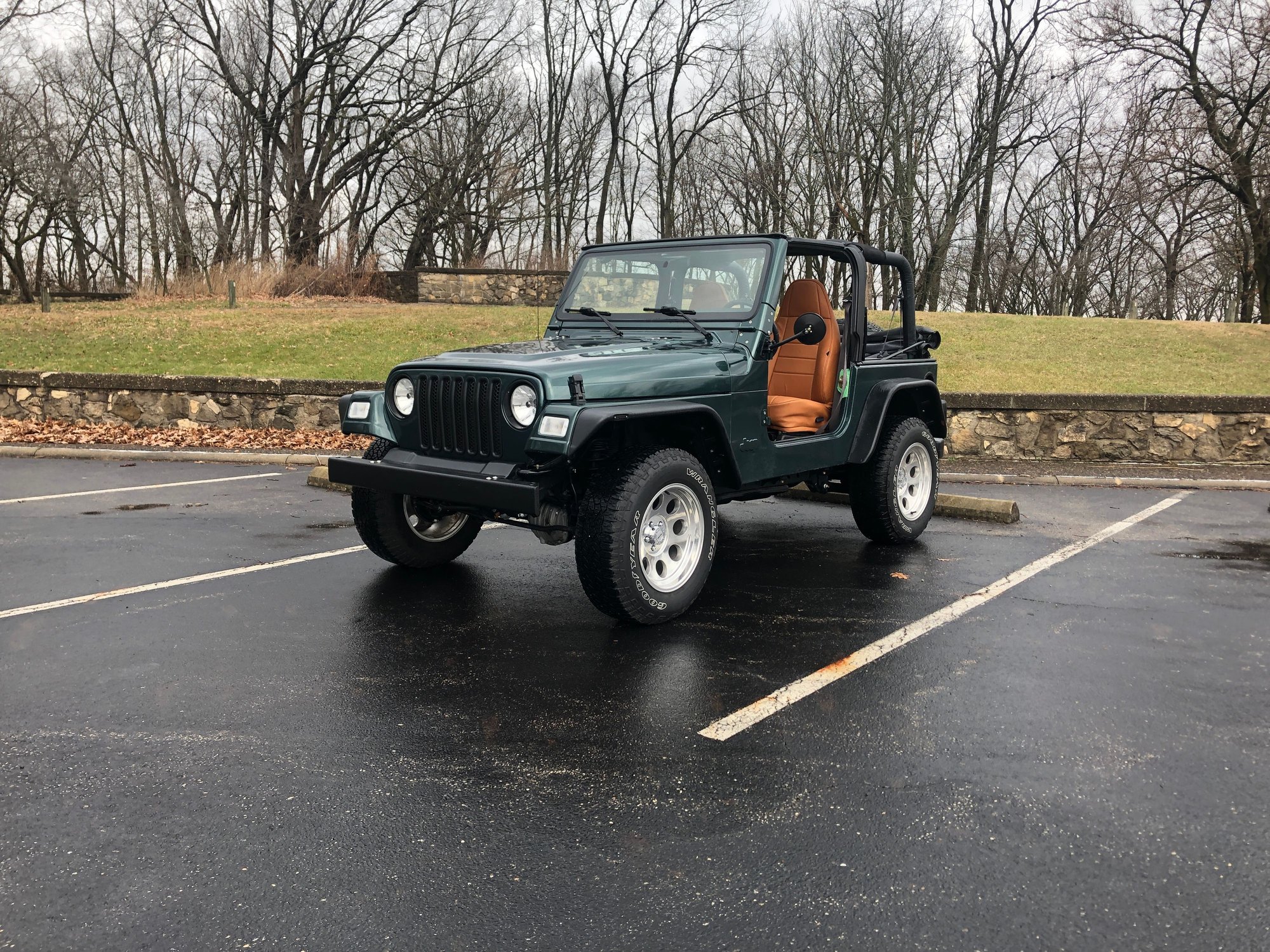

That is a beautiful Jeep and swap! I did have a 3.73 Posi 8.8 from a LS swapped XJ I had for a bit but ended up selling that since I got a great deal on a D44 with 3.73. Non-posi, but the amount I paid for it I could get a Tru-Track LSD and still be ahead. This is my swap as it sits with the 5.3/NV3550.
