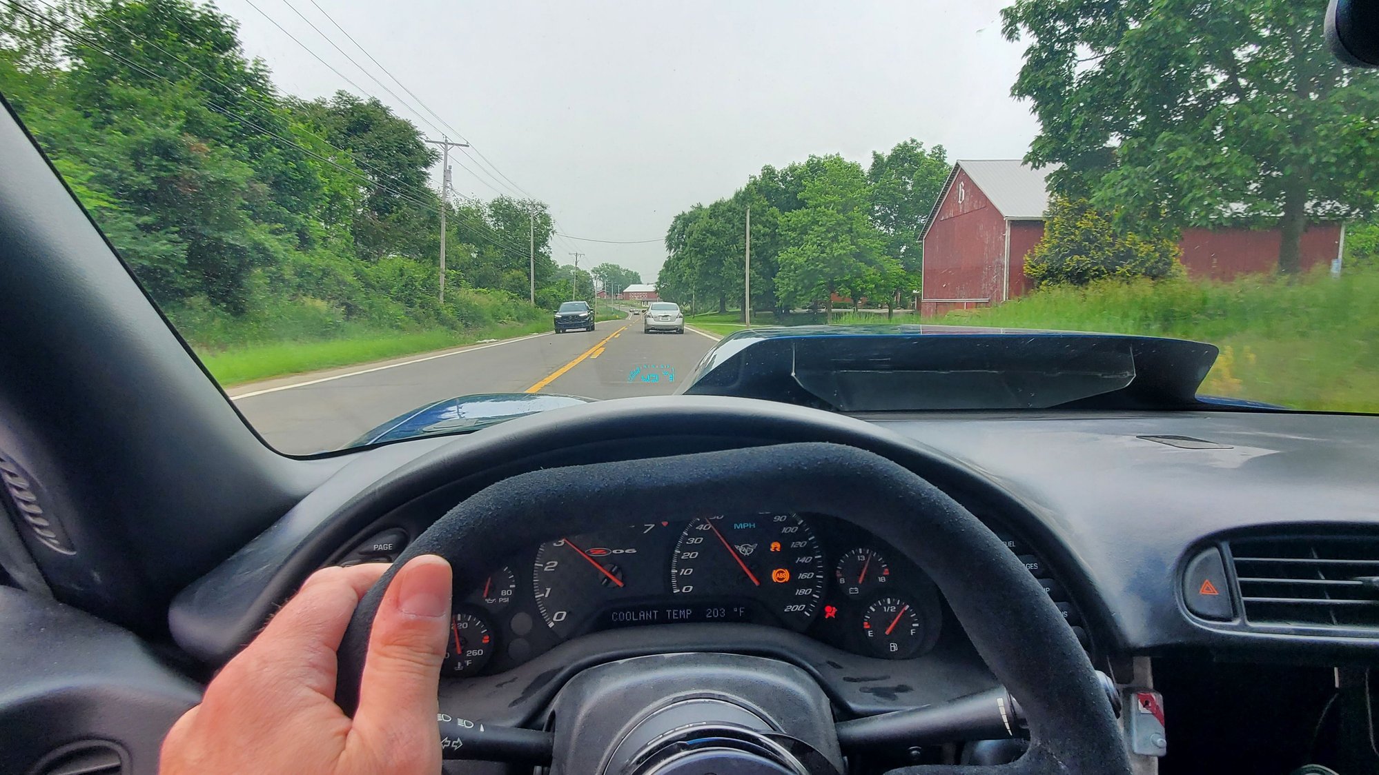

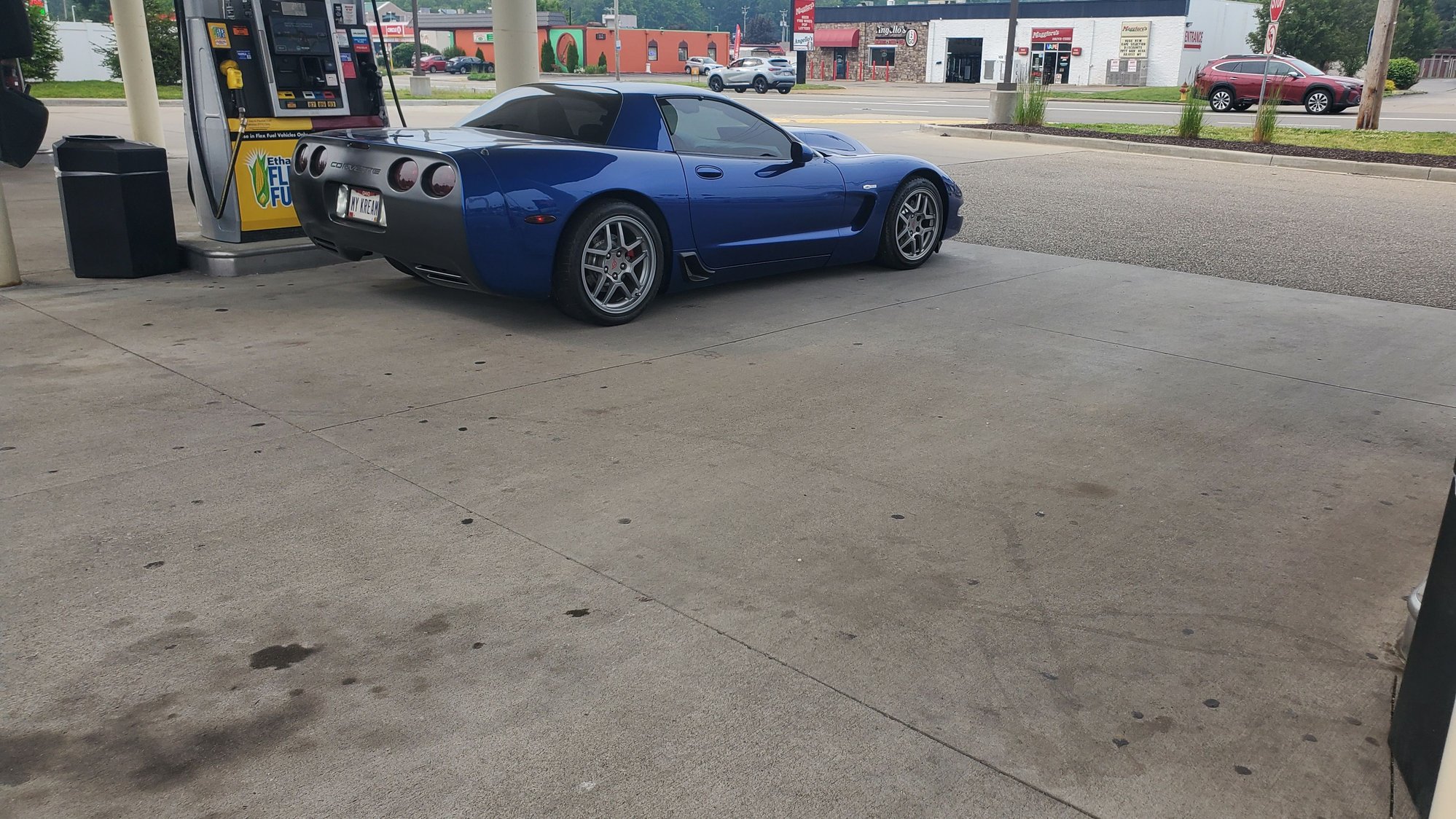

Today was the real, first trip out in the car. Took Taylor for a ride first, got into it in 2nd a couples times... Let's just say she doesn't quite care to get back in it for a little while 😅. Took another drive a little later, stopped and filled it with some of that gourmet maize fuel. Had a few people that wanted to act up a bit around it, but with no tire under it yet, I'll refrain from those activities 🙃. Need to change the oil and get a fresh set of plugs in it, but wooooh, is it fun. Thing pulls like a freight train!

Like the cowl induction view there.
Don't ya!?! That's the best view in the car!
