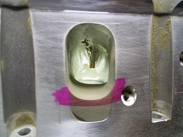

Here are a set of 706 heads I did some basic porting to. The intake valves were enlarged to 2.00 and the throat was adjusted to 90% and blended into the bowl. The exhaust is stock valve size. Basically a good cleanup on the exhaust. I did make the exhaust guides more aerodynamic and raised the roof a tad. This was also flowed on a 4.00 bore with no pipe. Biggest difference compared to yours is the .300 exhaust number and of course the intake flows.

I think Eric's video shows that stuffing the largest valve in the head isn't always going to get the best result.
