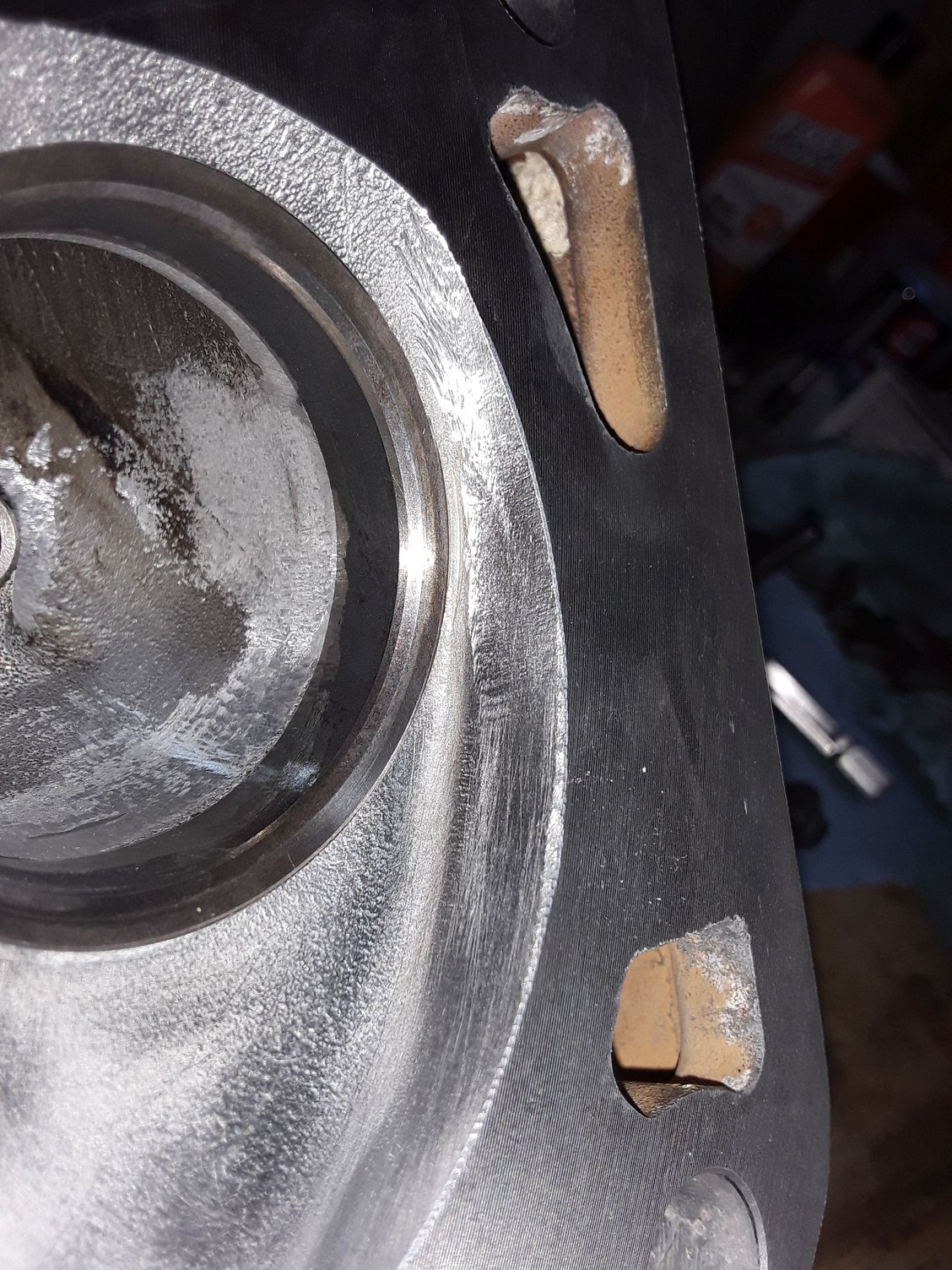

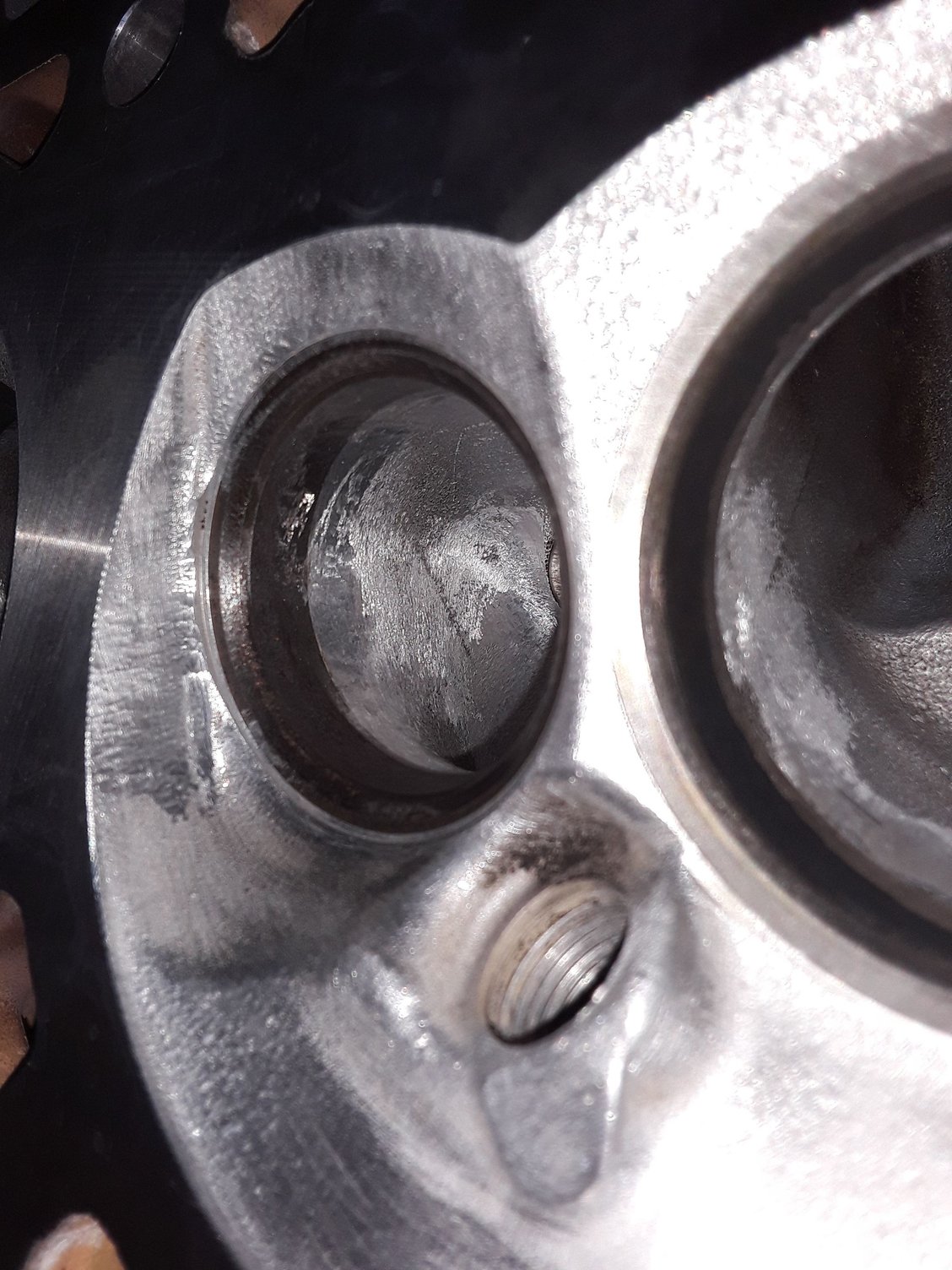

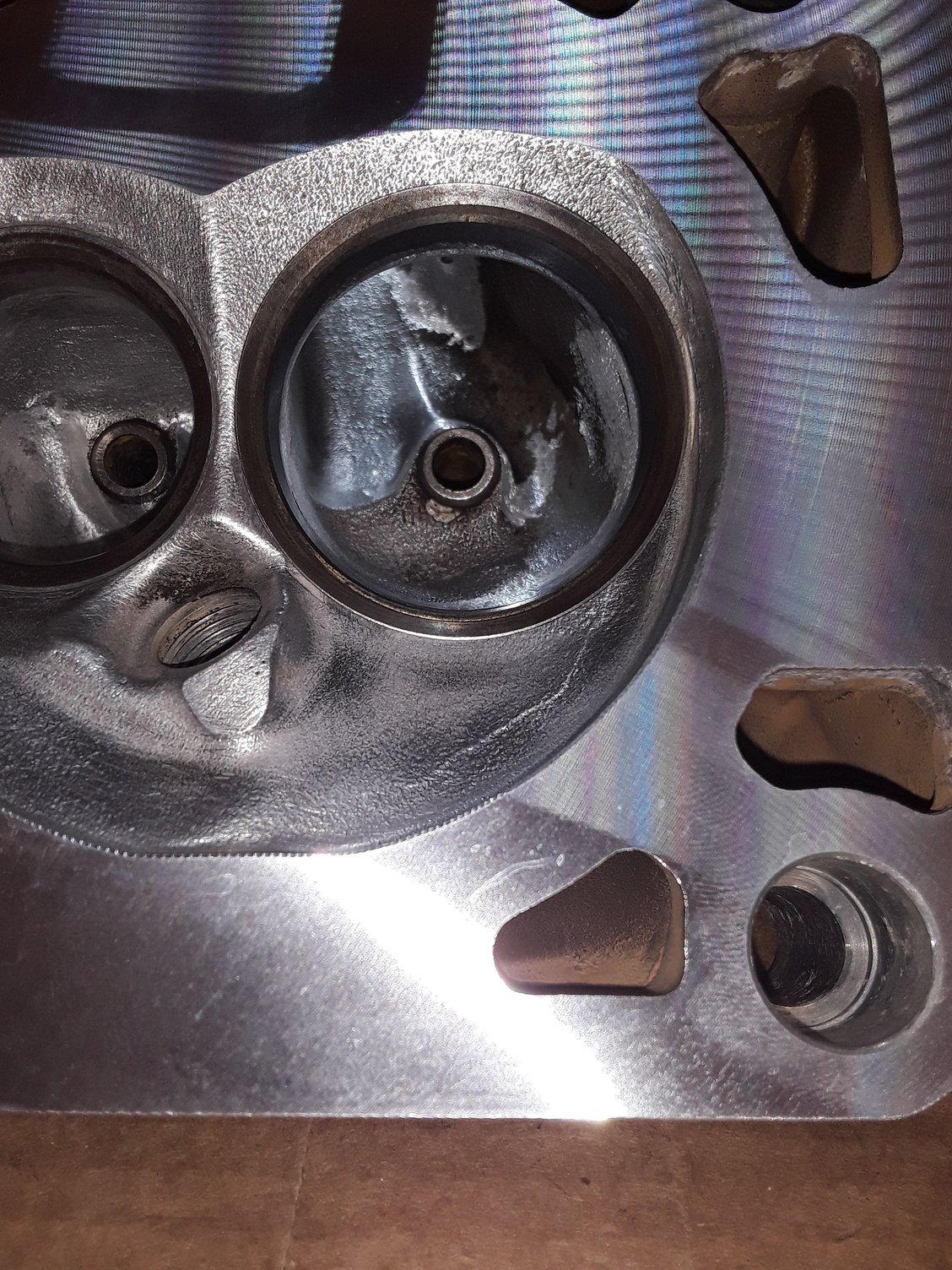

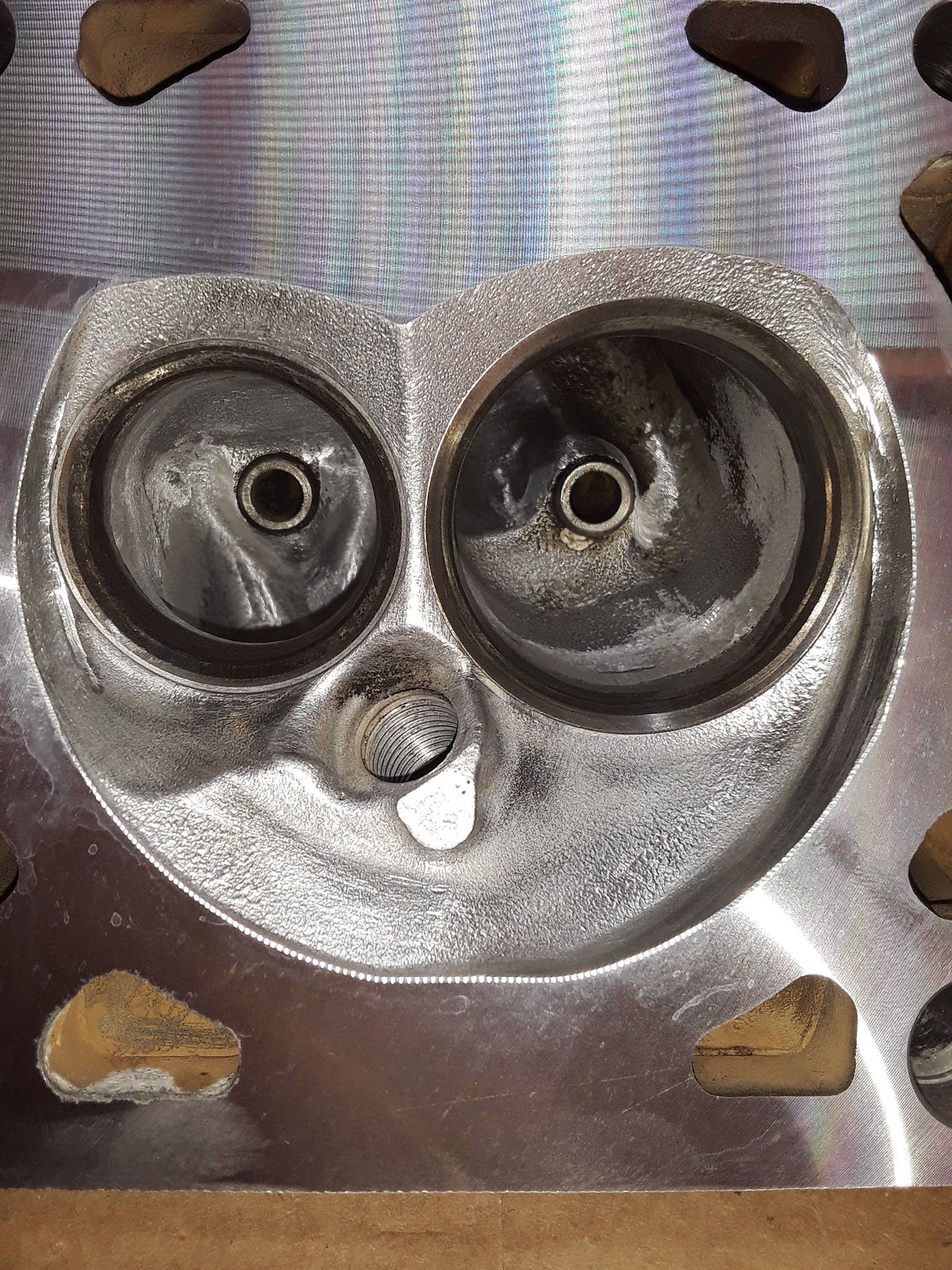

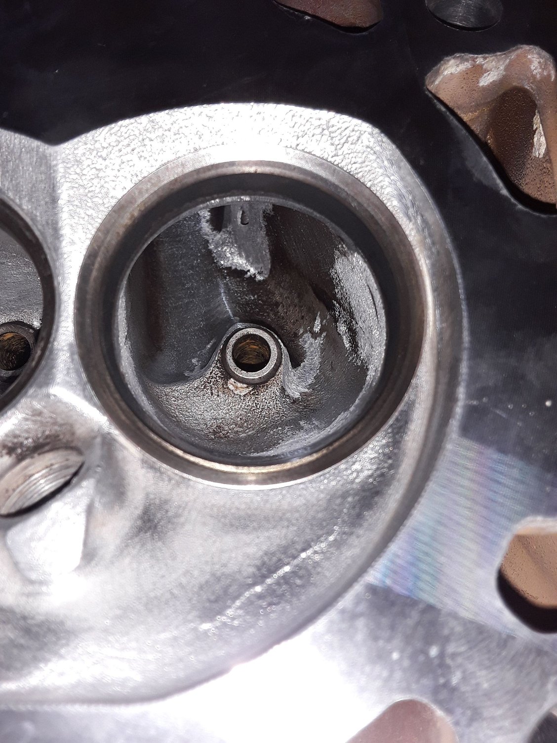

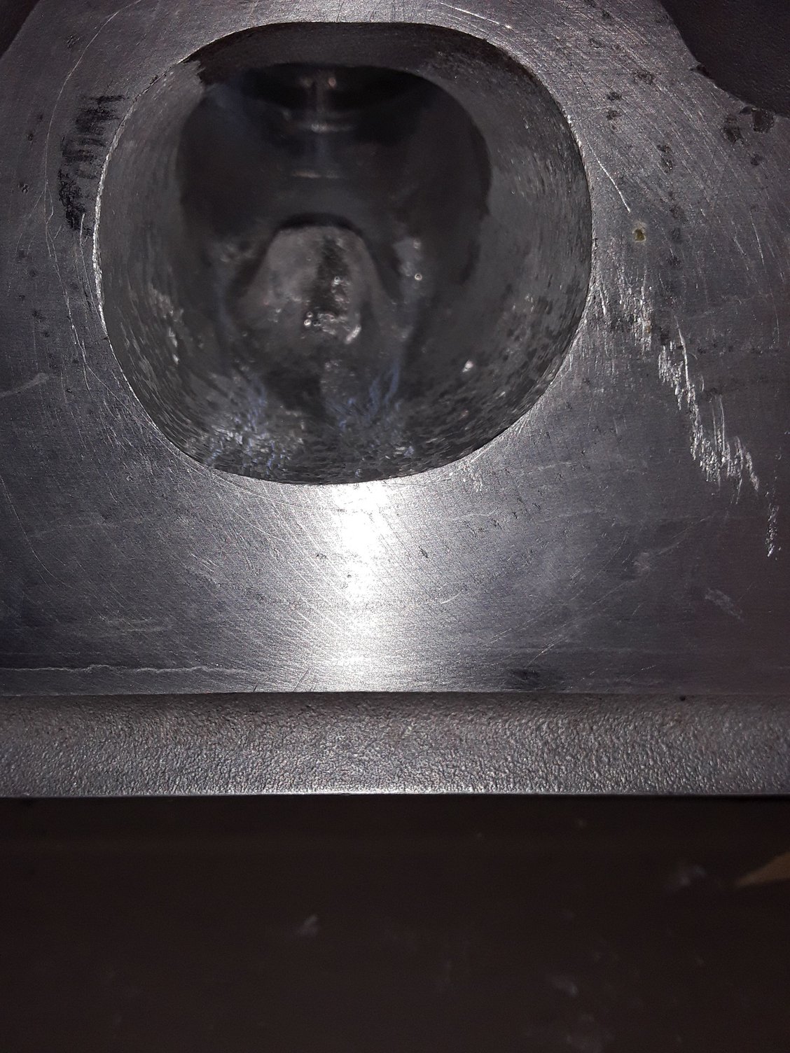

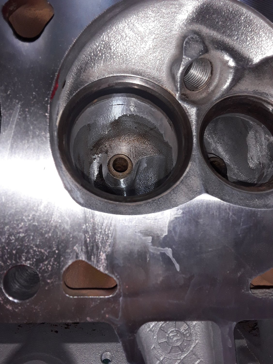

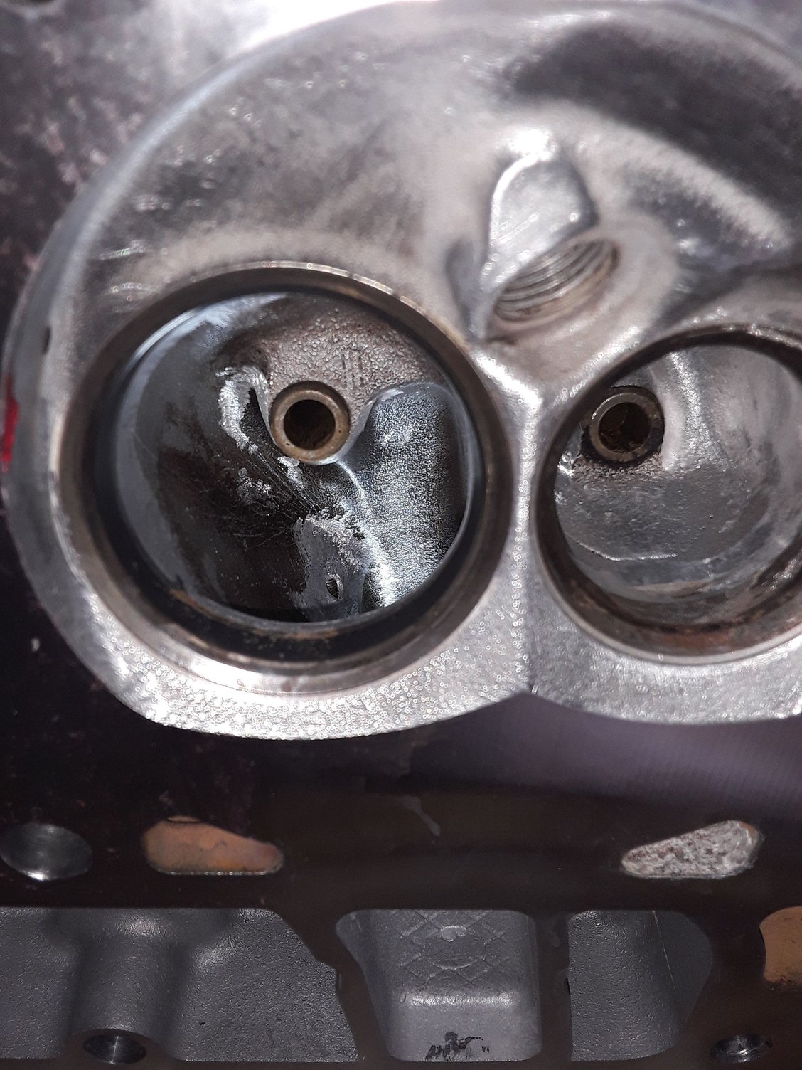

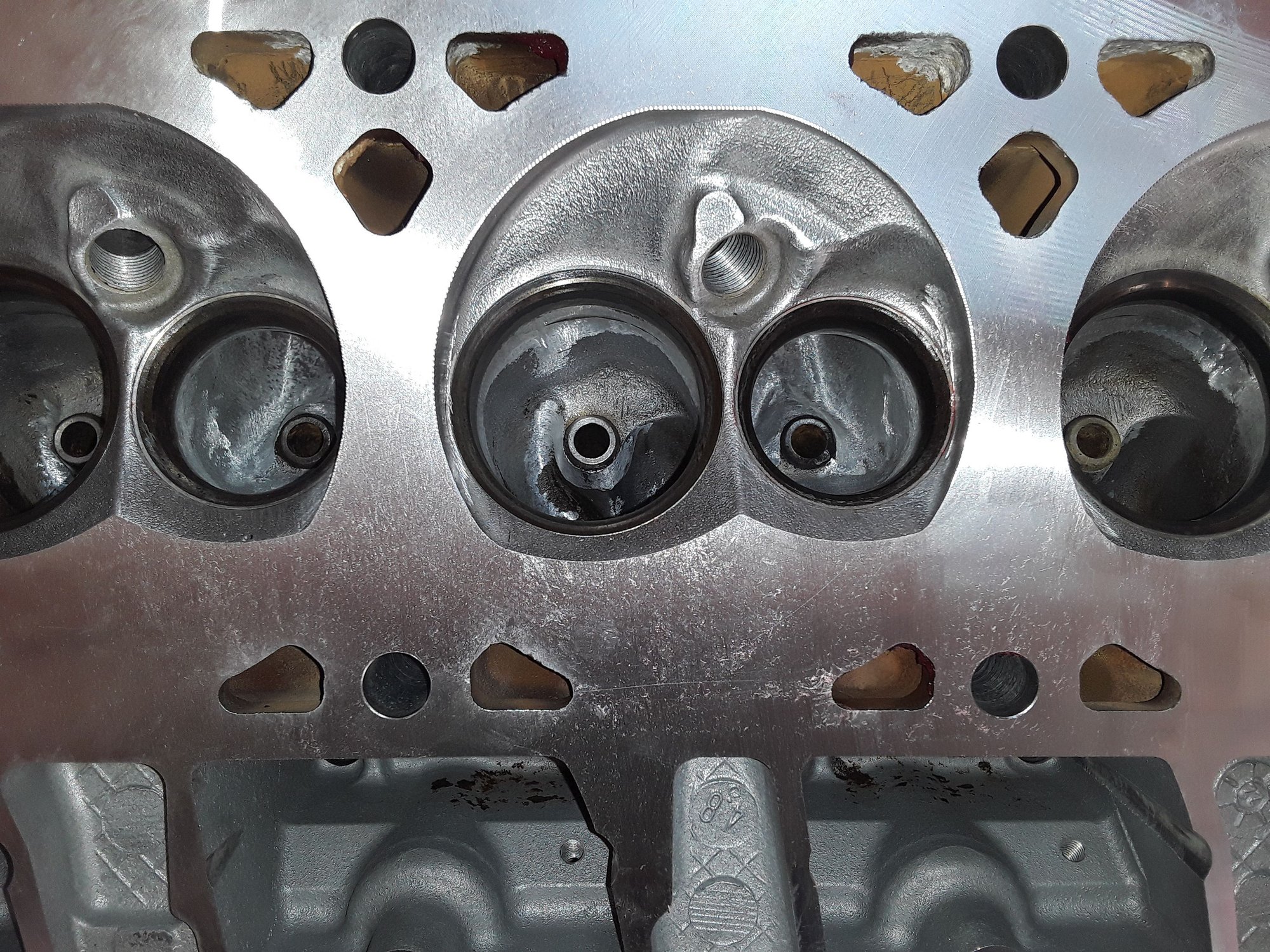

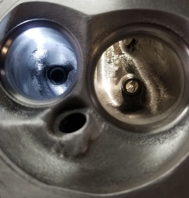

Here's some recent pics.

Originally Posted by Utinator
Yeah, I basically did the same thing. I watched those YouTube videos that you mentioned. I'm not real sure about the "throat" area. I didn't make a tool to measure or check if it was perfectly round, or what size it was. I just tried to smooth out the transition from the steel valve seat to the aluminum. I guess that's the throat area. I just went by feel. I ground down the valve guide boss. I left the swirl ramp alone. I didn't widen the intake ports. I just did a little blending on the casting lines. On the exhaust, I ground down the valve guide boss. I raised the roof about 1/10in. I could have gone 1/4in, but I wanted to make sure it wasn't bigger than the stock manifolds. The gasket is bigger than the manifold, so I used the manifolds for a template. I did some grinding on the side walls next to the valve guide. That made the port a little wider, and transitioned into the raised roof area. I also did some work in the combustion chambers. In the "valve shrouding" area, I made the stock cutouts longer, and slightly deeper. I think I ended up with a max diameter around 3.81in. The head gasket is 3.83in, so it should be fine.
There must be someone in Houston that can flow test LS heads. We have a few places here in San Antonio.
but of course we got someone to flow heads in Houston... Also your question of does a smaller Bore flow less? Yes it does..
if you had a bigger than 3.8 bore here's a idea just 4 you.
Btw I love cylinder heads and I can say this: your a Better guy than me. I ported the plenum of my own SV 4500. Something I'll Never do again and the thought of porting 8 runners. Just get the gun and shoot my hands.
Thought about what you've did and said to self, What would be another gain with this head 🤔
https://ls1tech.com/forums/generatio...00-valves.html

Looks like you did good work on the intake and exhaust. I have a set of 862 heads that I ported in a similar way to my 243 heads including going with a 2 inch intake valve. I polished the exhaust port; that's something many do on ported heads.

On the throat percentages I think they are stating you want the bowl just under the throat to be WIDER than the actual throat, and then the valve seat area where the sealing angles are cut is also WIDER than the throat. This supposedly produces a venturi effect. Think hour-glass shape with the bowl being under the pinch point in the middle, and the valve seat area being above the pinch point area. The pinch point (throat) supposedly speeds up the flow of the air/gas mixture as it gets constricted into a smaller space the velocity increases. That's the theory. Supposedly just having the bowl the same size as the throat is a no-no. Also, I believe the hardened metal valve seat just under where the sealing angles are cut is the throat area that is supposed be touched only to make it perfectly round, or reduce the ID of the throat area to 87-90% of the actual valve size. Again... without having the equipment to literally test after making minor changes it just seems like a guessing game. I believe that buying CNC ported heads may be the easiest way to move forward. They take all the guess work out of it, and you know they have the equipment to test this stuff and they know for sure what works... and what doesn't. Maybe studying a CNC ported set of heads would shed some light on what they do to improve the flow.
