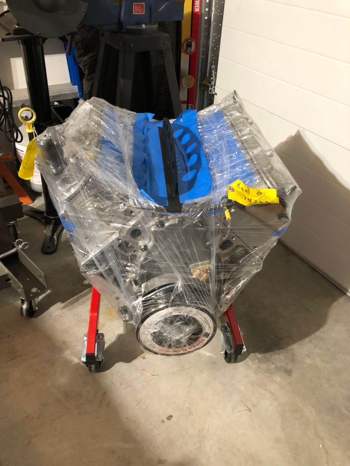

Well I'm bringing the block to a machine shop since I ended up breaking the crank balancer bolt trying to press on a new timing gear. Was on almost all the way then heard a snap. Removed the bolt and it is about an inch shorter! Thought I would remove the new sprocket and it won't budge... not sure what the deal is but I figure I'll just have the motor freshened up. Cam bearings weren't in the best of shape but the journals looked perfect and I was going to run it but since I now have a broken off bolt in the crank and the motor has 120k a refresh is in order.

Well after patiently waiting I picked up the motor from the machine shop yesterday. I will need to wait a few days to get all the specs from the rebuild as the owners son was not in and the owner isn't allowed on his sons computer. Did get some info though of which was the report on balancing. I guess is was a ways off before... I don't really understand the info on the balance sheet it is in the PDF attached..
Went with a cam motion stage 3 ls3 high lift cam, johnson 2110r lifters (7.350 pushrods), smith brother trunions, new cam bearings, piston rings (piston bore was good, just honed) heads refreshed (had dual springs/titanium retainers) HV oil pump, new timing gears/chain/retaining plate. All crank and rod bearings were in excellent condition and reused, valley oil galley ports tapped and plugged, crank machined for keyway, ATI balancer/ARP bolt, ARP head bolts. Pre-lubed and smoke tested, all new gaskets and seal. Now to get it installed....
