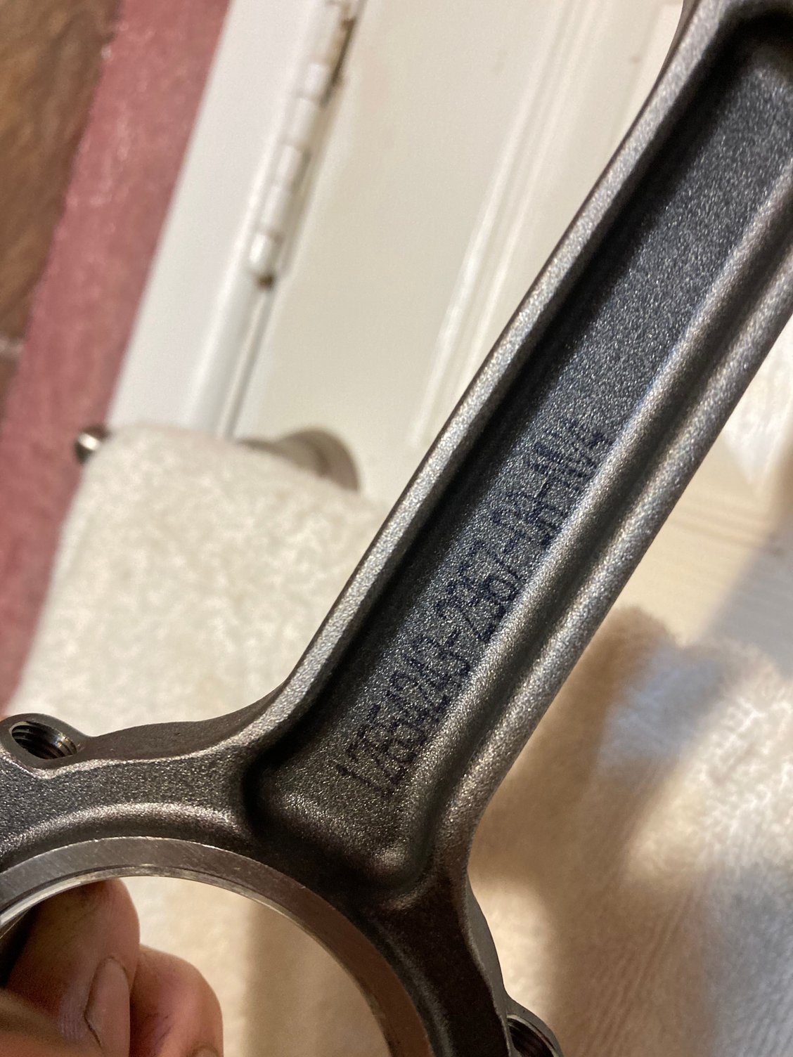

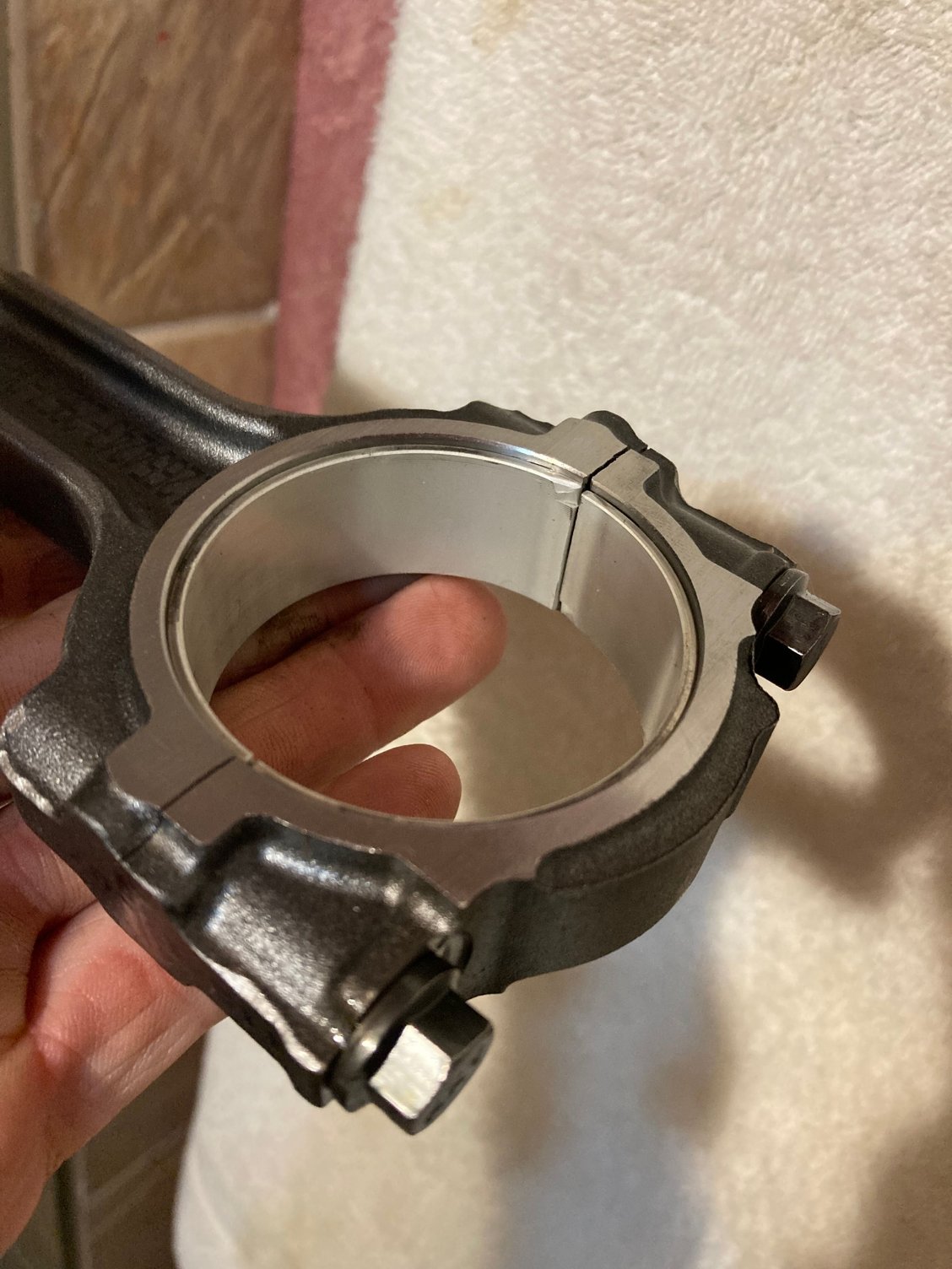

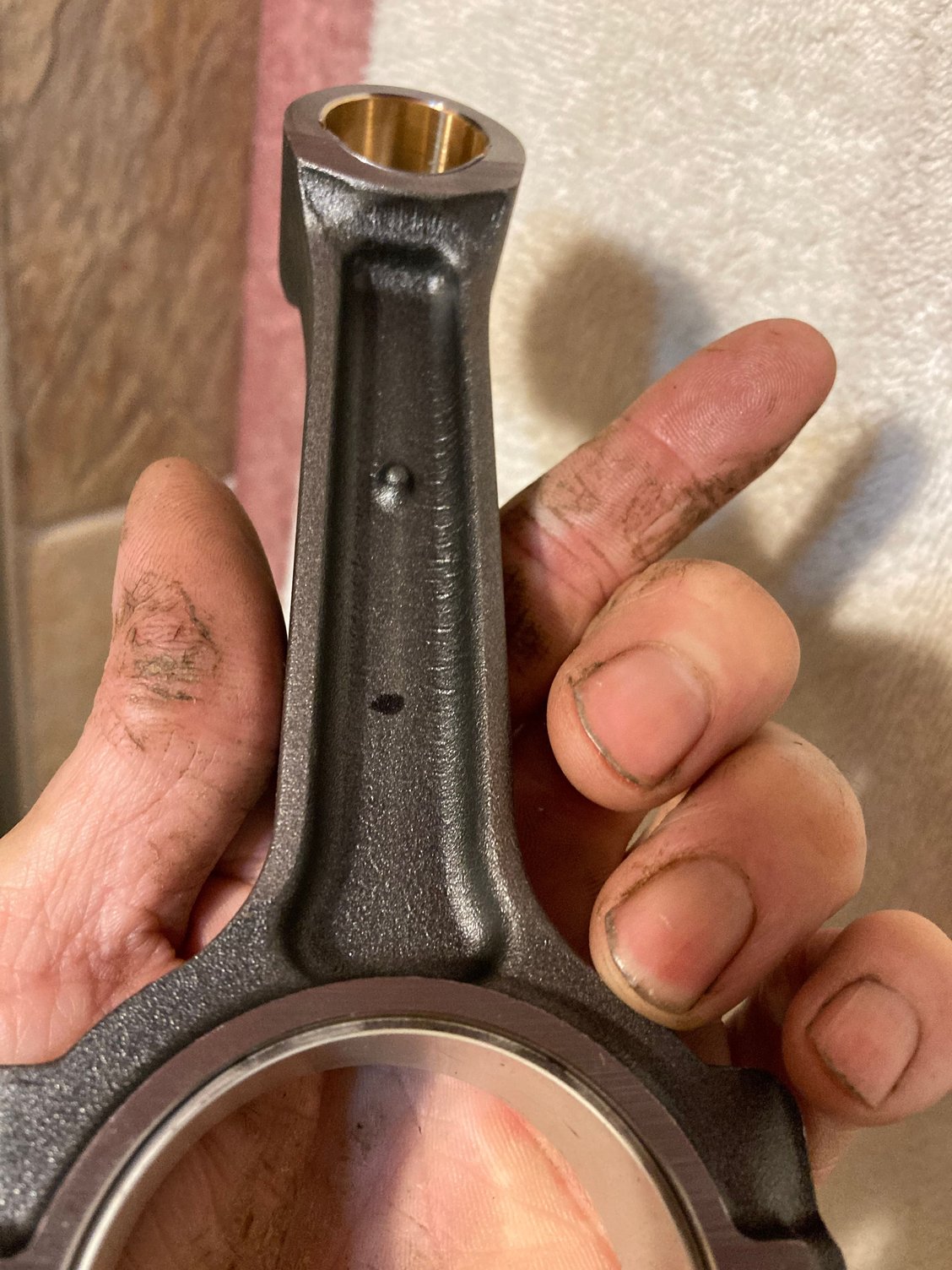

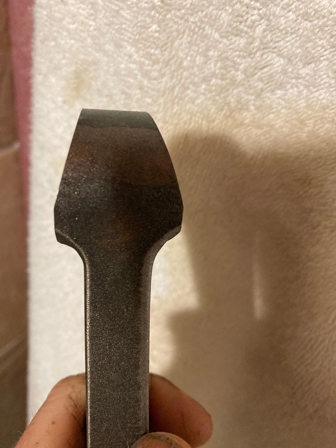

Hello, I was told that these are Gen4/ Gen5 compatible 5.3 rods. What can you tell me about them? I’m trying to build a hybrid gen 3 block with Gen4 rods and pistons.

Looks to be Gen4 dimple rods from the pics.

I’ve only seen one set of Gen4 rods in my 04 5.3 but the wrist pin area was squared off like gen 3 rods. Although these are supposed to be a later version? I can’t find any pictures of Gen4/5 rods that look like these on the internet.

Quick way to check: Get them warm, see if piston pins drop through...
gen III are PRESS fit.
gen IV FLOAT

They look like the rods that come in the LSA. They’re the only steel rods that I know of with that tapered pin end, but I can’t recall what the LT1/4 rods look like.

He said that they are GM part number 12649190.

As long as it didn't come from a 4.8L or LS7, it should fit in a 5.3L. I'm not sure what the deal is with the tapered end. I have never seen that before. You will need Gen-4 style pistons. As mentioned earlier, the Gen-3s are press fit. The Gen-4s are floating, and use a different diameter wrist pin.

This is the full part # 3847 12649190.
looking this number up I see these are for TDI direct injection engines.

Then it is Gen V. Likely a different animal....

Then that's not an LS rod. That is probably an LT rod. I wouldn't try to use it in an LS engine.

You've already heard from guys who do know. It is a Gen V rod. Not Gen IV. There are no "Gen IV/V" rods

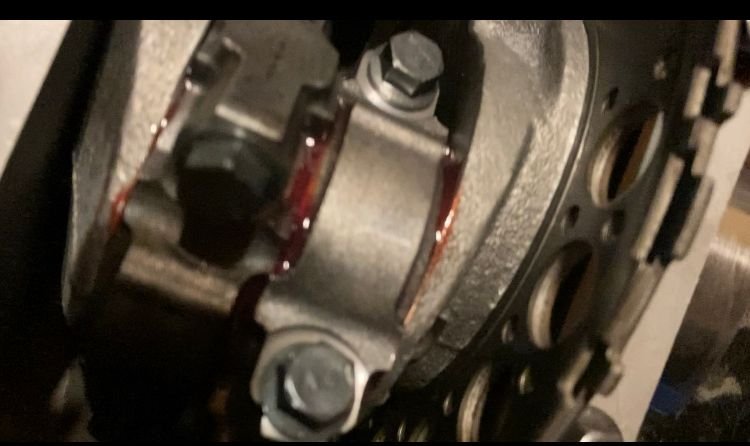

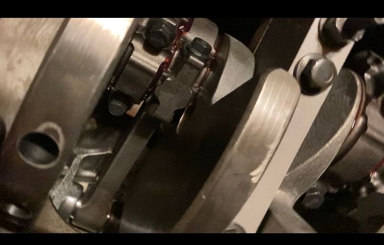

Default It’s done.
Milled Gen5 rods, Gen4 pistons, 24x reluctor on a Gen4 crank in a gen 3 block. 100% of the rotating assembly in brand new. I’m ready to finish this build.
Old Oct 14, 2022 | 06:53 AM
Posts: 7,848
Likes: 5,198
What did you have to mill on the rods to work with this setup? How much material was removed?
Old Oct 14, 2022 | 10:18 AM
Givememytoys's Avatar
Joined: Nov 2021
Posts: 18
we had to mill the wrist pin area to allow acceptable clearance.
It was around 0.0755 total removed.
They are a little wider than a Gen4 rod at the widest point of the taper on wrist pin after the mill work.
It is just going to be a mild engine as far as performance. BTR truck torque cam, flat tops and a small amount of chamber work. Hoping to get 350-375 hp at the crankshaft.
I’m more interested in the torque down low and a very well mannered engine. It’s going in a O2 single cab short bed daily driver.

To clarify here, did you hone the wristpin bushing, or mill the sides of the rod to make it narrower?
Old Oct 14, 2022 | 04:52 PM
Joined: Nov 2021
Posts: 18
sides of the rods in the wrist pin area.
Old Oct 14, 2022 | 05:00 PM
Posts: 7,848
Likes: 5,198
Appreciate the info. Great to know.
