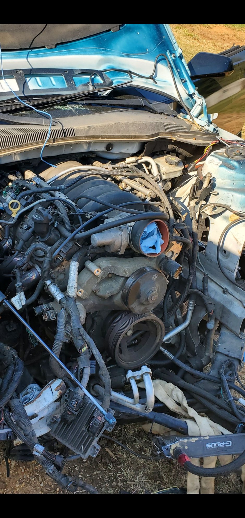

Just picked up a wrecked 2013 camaro with "LS3" and tr6060 for a steal. I haven't had a chance to pull the engine yet and confirm they haven't swapped the motor, but I noticed 853 head stamps with adapter plates for the intake. I know it's a 4th gen aluminum block by the knock sensor and timing cover, but not sure what exactly I have yet. No other way to prove it's a 6.2 LS3 without separating the transmission is there?

Is there a way to identify the block without separating the transmission? Would there be a stamp behind the water pump? Or can I pull the intake and valley cover off and notice a difference? I pulled the alternator and bracket off. There wasn't a stamp there or displacement marking. The only thing there was the number 98 with a circle around it stamped.

On the pic above it looks like the cam sensor is for a gen IV? The LS1's had the cam sensor on the back of the block.
My current LS swap is a 2012 L92 and it has 823 heads.
Here's a pic of the 6.2 from the front. I thought the cubic inch names are on the rear of the block?

that looks good! Yeah this motor throws mix signals to me. I feel like it screams 4th gen by the placement of the timing sensor and knock sensor, but the block stamp looks identical to an early ls1. If it wasn't raining right now I'd pull the intake off outside.

Just one more thing that points to a gen IV LS of some kind is the ECM shown in the pic above. It's a gen IV ECM not a gen III.
