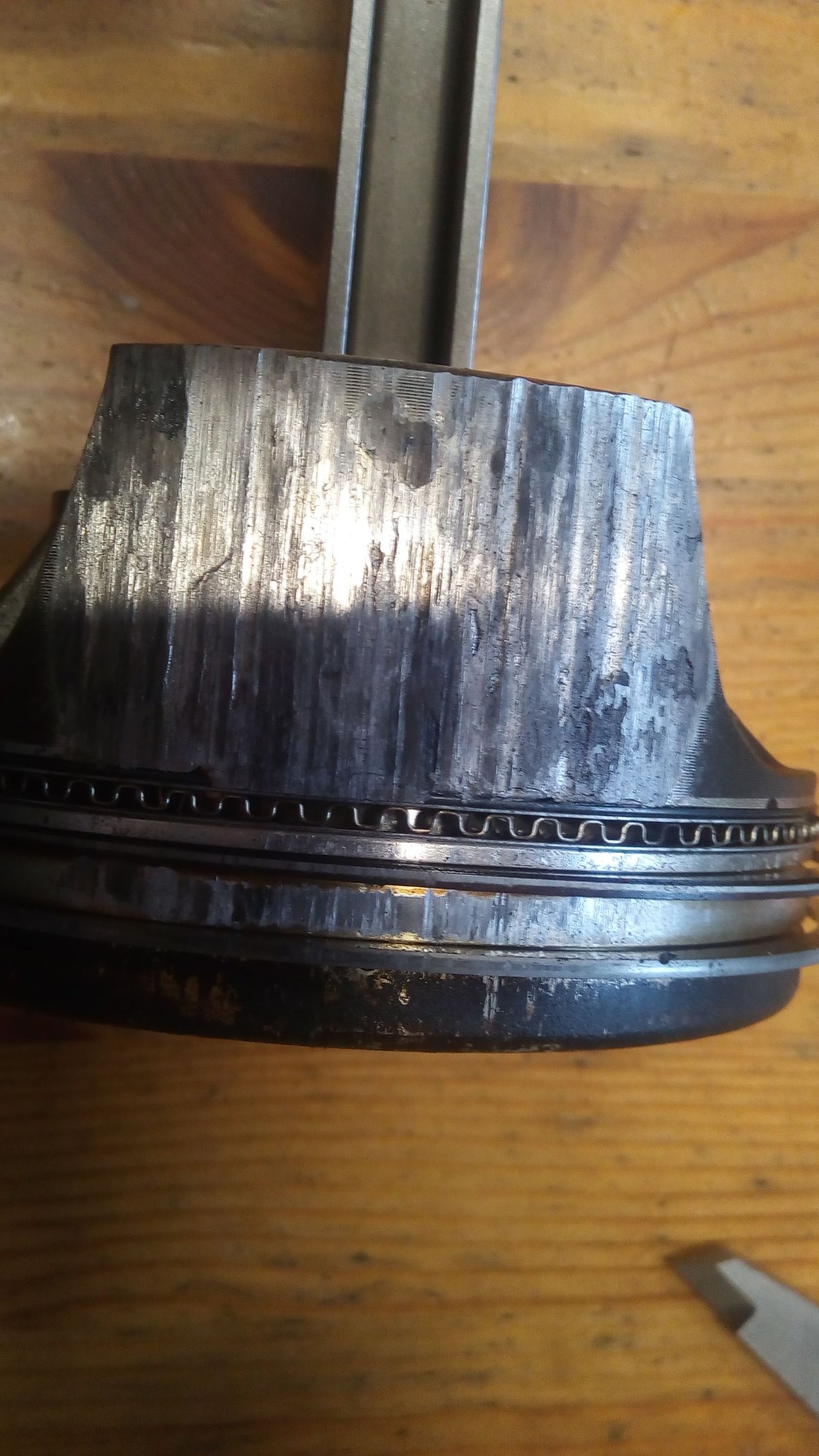

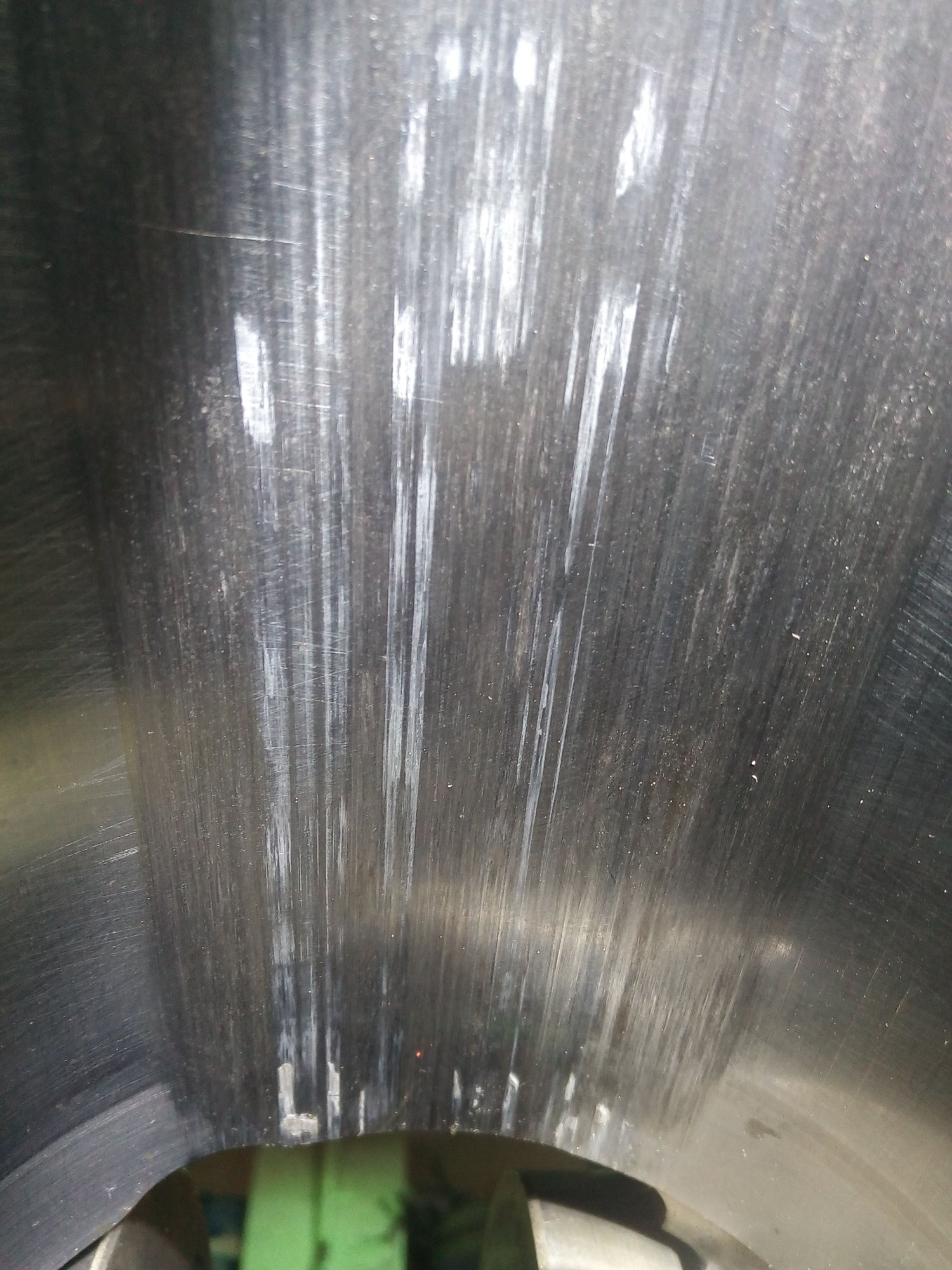

The block definitely need machining -one of bores badly scratched and 'painted in alu color' .
Dont think we should polish and reuse as it is (and we miss 1 piston of course)
Better rebore it
Better rebore it
Please post up pictures, can't hurt to get additional opinions and their is a lot of experience and expertise on the forum.

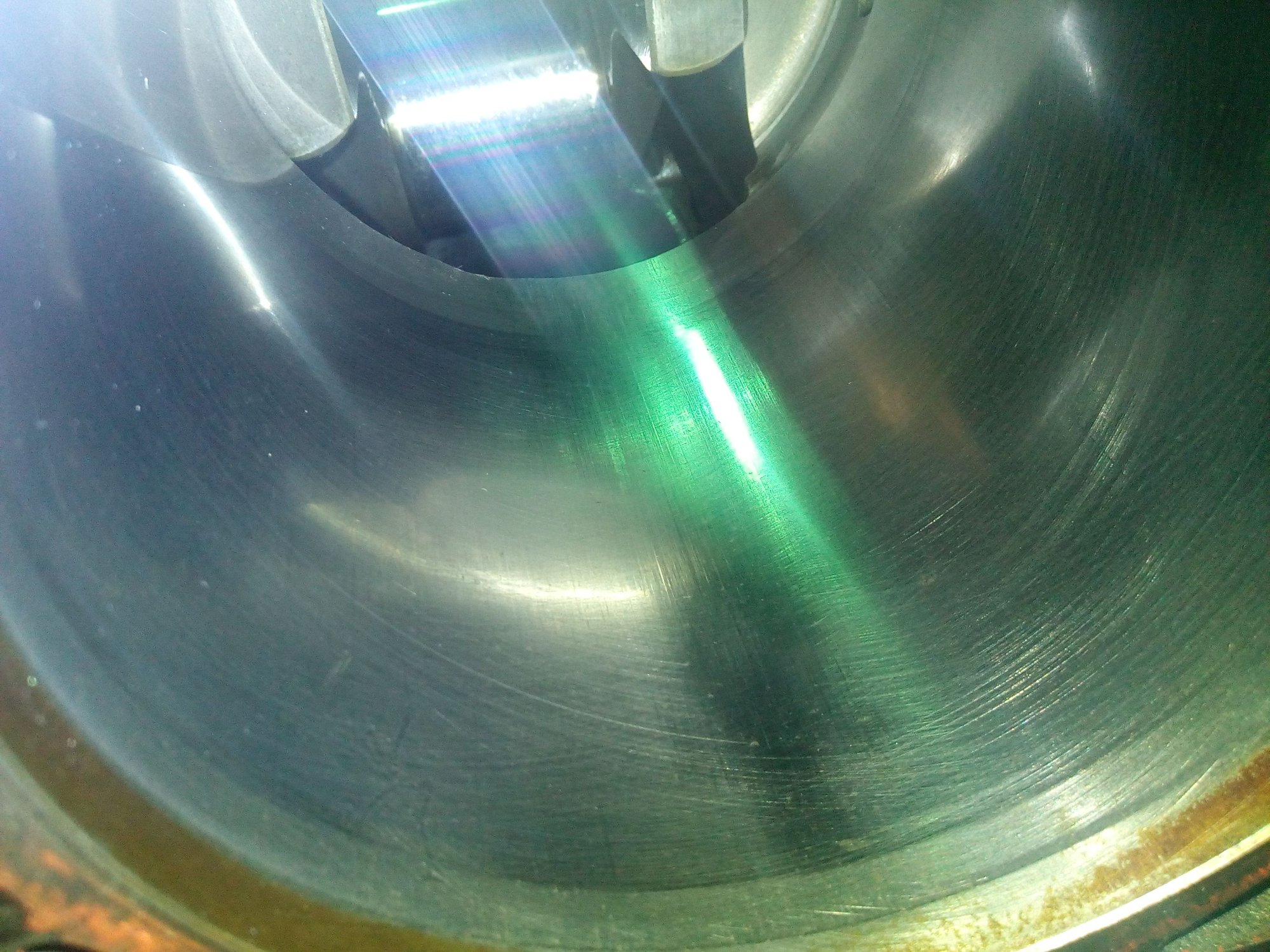

opposite side
Rods 6.125
Block 19260089 9.25 height (235mm)
Forged Dimond pistons dished +22
Bore height 143mm (working surface)
N/A (it was planned to be Supercharged later)
Better rebore it
In your first post you mentioned going out to 4.25. That only leaves 0.15" between cylinders, you sure that's going to be ok on an LSX block?
I've got a resleeved 4.185 block and had kind of always heard if the walls were ever toast it's probably done for beyond a clean up hone, and 4.2" was probably a crapshoot.
