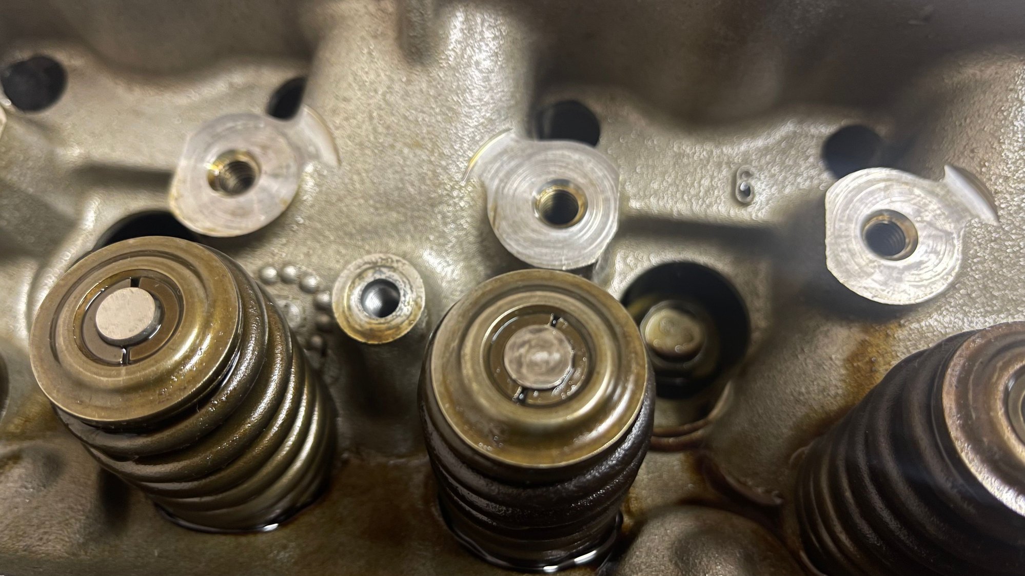

Old Mar 24, 2023 | 01:54 AM
DFR_BG's Avatar
Joined: Nov 2022
Posts: 10
From: Sofia
Hi guys late update...the engine block is in the machine shop. I ordered a new set of Summit Pro LS piston and rings SUM-136SN9045075 . Main, rods and cam bearings , head gaskets, head bolts , Melling M295HV oil pump, all seals and etc.
Infortunately i ordered a wrong intake and exhaust valves... ( TFS-32600211 and TFS-32600212) my mistake this valves is only for a trickflow heads.
What lenght i need for my 823 heads ? My old ones are 4.91 inches but on the exhaust i have a bad harm on the tips, someone has grind them before , and i`m not shure its right lenght. GM Genuine valves have 2 different sizes and i`m lil confused.
Old Mar 24, 2023 | 03:38 PM
Posts: 7,848
Likes: 5,198
Intake valve GM #12569427
Exhaust valve GM #12582719
These are available through Summit. You will have to get a valve job done and have the heads setup, for valve tips to all be same length. Choose a good shop. This is not a drop-in and go purchase.
