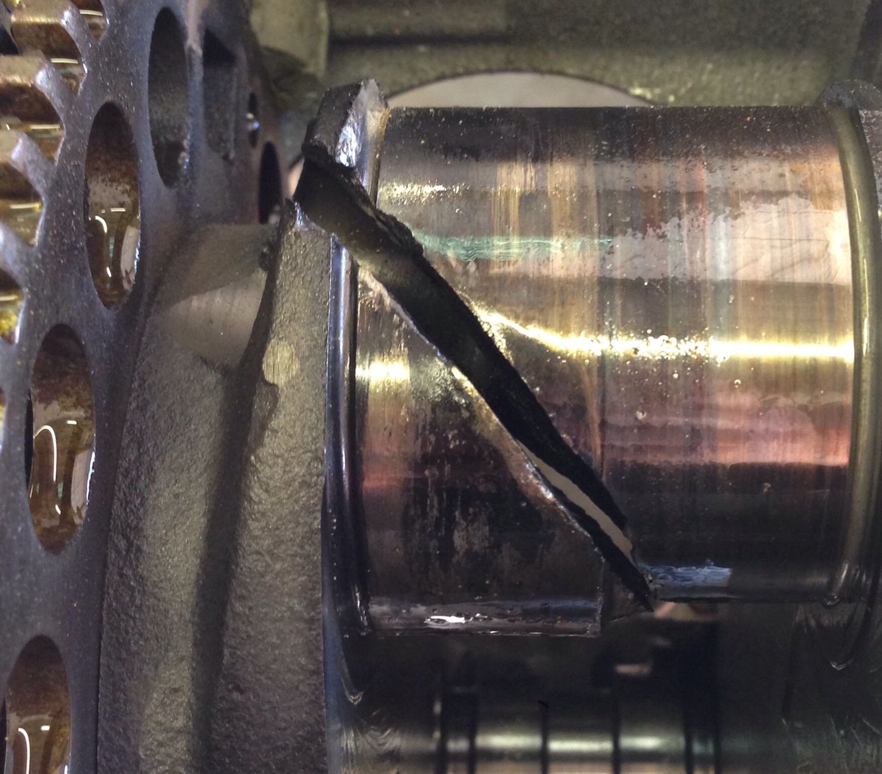

I had a stock cast crank with Compstar rods and shelf Wiseco pistons making 1000-1200rwhp for years and spinning 7500rpm+. What finally killed it was showing off.... a 1st to 4th gear burnout (T56 Magnum) showing 140mph on the speedo... moving along at around 70mph and I let off the throttle in gear.... when it hooked up the driveline shock snapped the rod journal as the force transferred from the rear tires forward. It turned off immediately.... and I coasted back to the pits... I didn't see any oil on the ground.... so I quickly started it and heard a horrible noise and then back off. Upon tear down the only thing holding the crank together was #7/8 rod journals. It snapped clean thru where the hole is drilled out back for the pilot bearing!

Ouch would be an understatement of the highest order in this case!! Wow....
