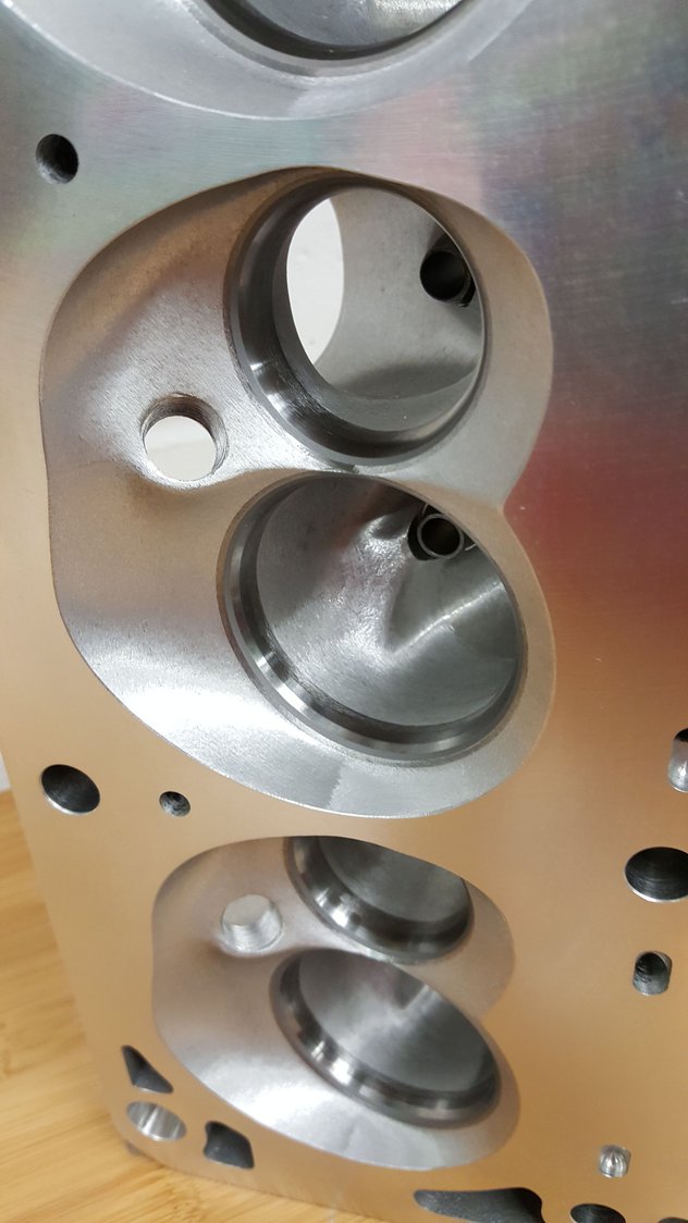

Old Jan 20, 2023 | 01:22 AM
Tony @ Mamo Motorsports's Avatar
LS1Tech Sponsor
Active Streak: 30 Days
Active Streak: 60 Days
Posts: 828
Likes: 579
Originally Posted by C409
Tony , How much $$$ for a pair of MMS 265 Heads ?
Very wide range of pricing based on porting options, valve material options and valve spring package options.
Most heads I could say the same but with the LS7 stuff its just more to choose from
My Stg 1 heads which will smoke any OEM ported LS7 heads by a large margin in both flow and performance (especially airspeed and "efficiency") sell for only $4350 !
When you factor in what you can sell a set of OEM heads for (versus paying to port them) the Stg 1 heads are really a bargain IMO
They come with custom hollow stem Ferrea lightweight intake valves and a solid steel exhaust valve. They both weigh about 100 grams (which is light).
Want more flow, high lift premium valve springs, additional porting options and larger titanium intake valves and larger hollow stem exhaust valves (the "Mac Daddy" package.....LOL) and your going to spend in the high 6K range and anywhere in the middle based on a combination of some of this optional equipment. I offer a package for $5450 that's very popular.....it comes with all the porting upgrades, premium springs for high lift aggressive cams, my CNC + (hand finished chambers bowls and exhaust ports)....basically everything with the exception of the Ti intake/ hollow exhaust upgrade and these heads make a bunch of power (630 - 650 RWHP when parked on top of an OEM C6Z06 shortblock).
See pics attached but your best bet if your interested is to get on the phone with me and we can go over your build and select the best way to build them to optimize your particular combination and budget
