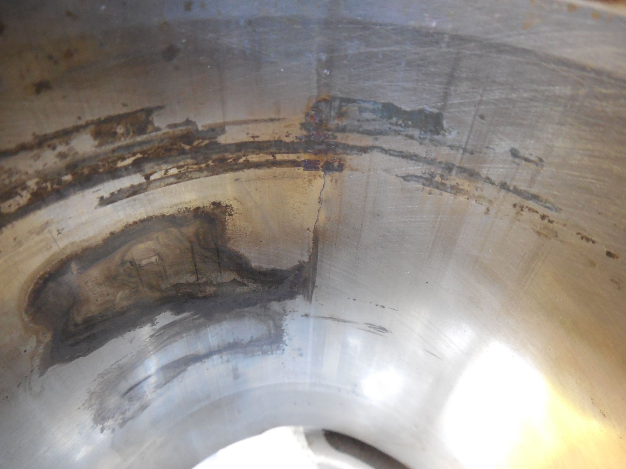

LS7 Block durability ... broken piston caused this block damage ...
Dart Little M ... This piston damage was cleaned up with .004" cylinder wall hone ... I'm still running the block ...

I'm sure the ls7 block isn't as forgiving. BUT-This was a failed piston that damaged the block, NOT a block failure that damaged the piston.
Absolutely ... it was definitely a piston failure ... Both were ... the LS7 block will make a nice coffee table ... the Little M is making passes at the drag strip . Durability to withstand something as commonly occurring as detonation .

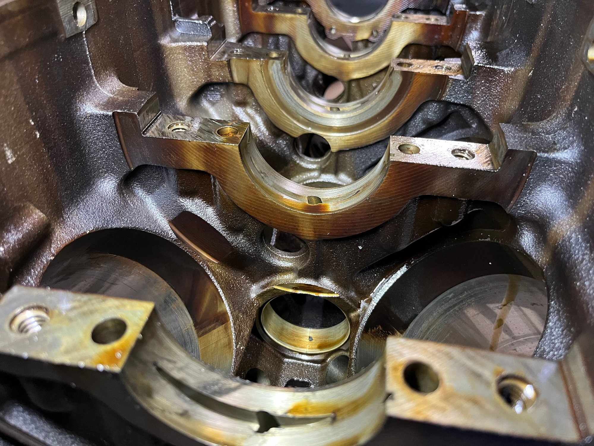

The LS3 doesn't have a "hole" drilled like the iron blocks. The LS3 has half-moon shape cutouts in the saddles. I'm not certain on the size of the iron block holes. If I had to guess, I'd say between 1/2" and 7/8". If I remember, I'll measure the one I'm about to tear-down.

So, I measured the "bay-to-bay" breathing holes in the Gen-4 6.0L block that I have. I got about 1.115". It's kinda difficult getting the caliper in there, so the measurement might be a little off. Here's a few pics that I took:
