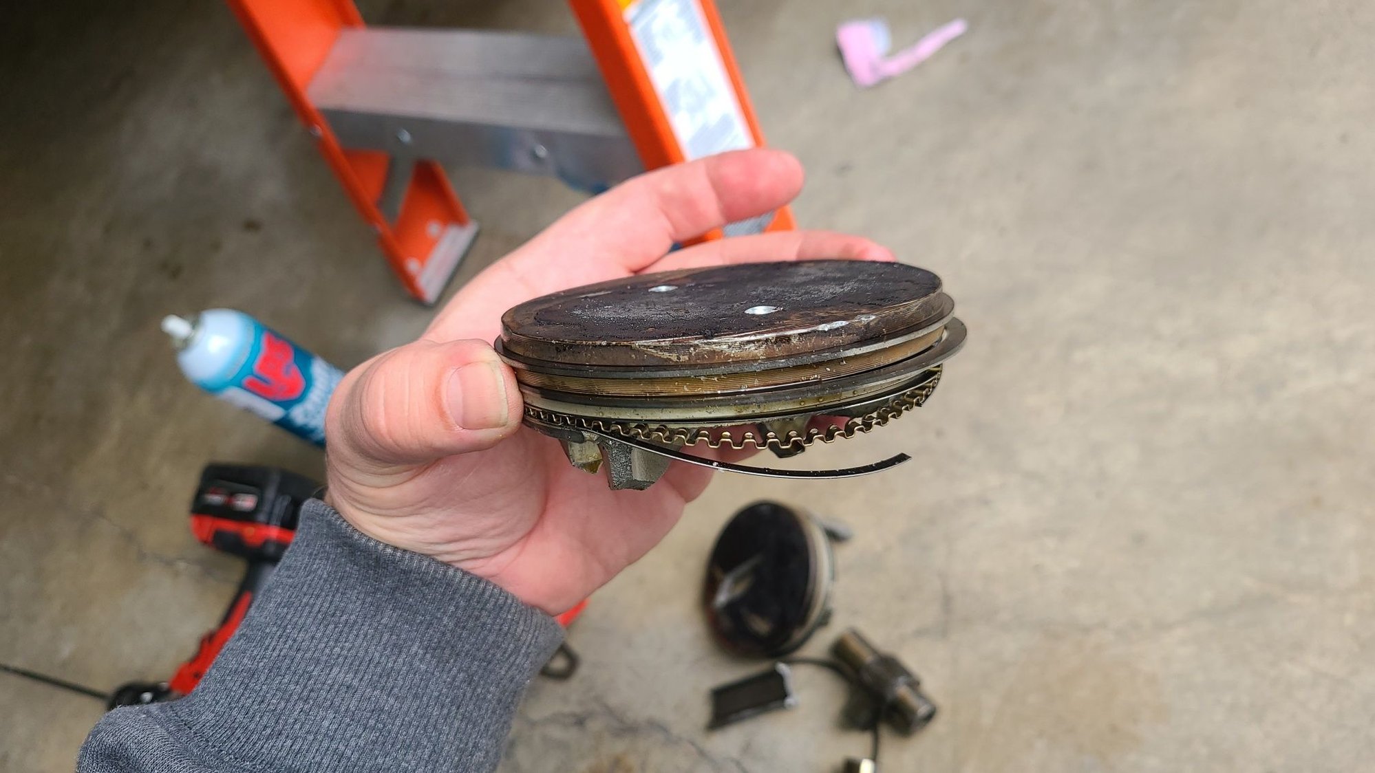

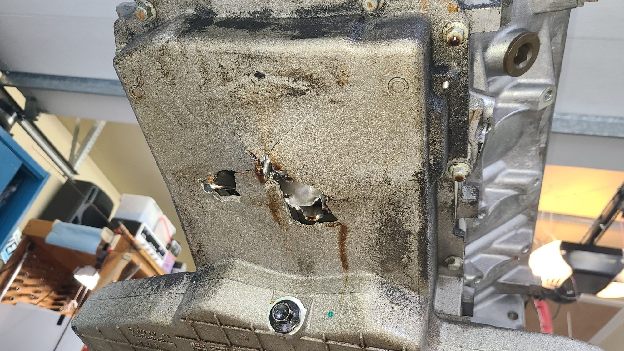

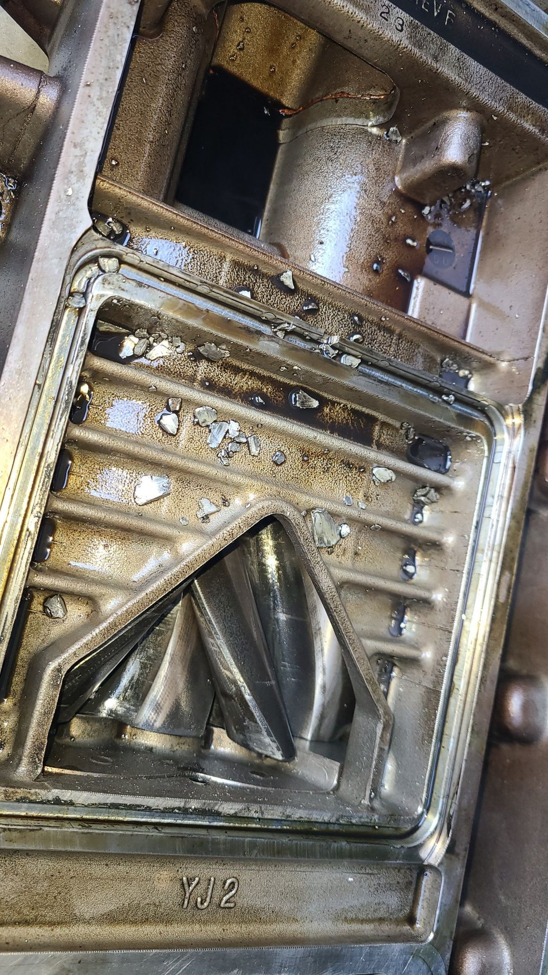

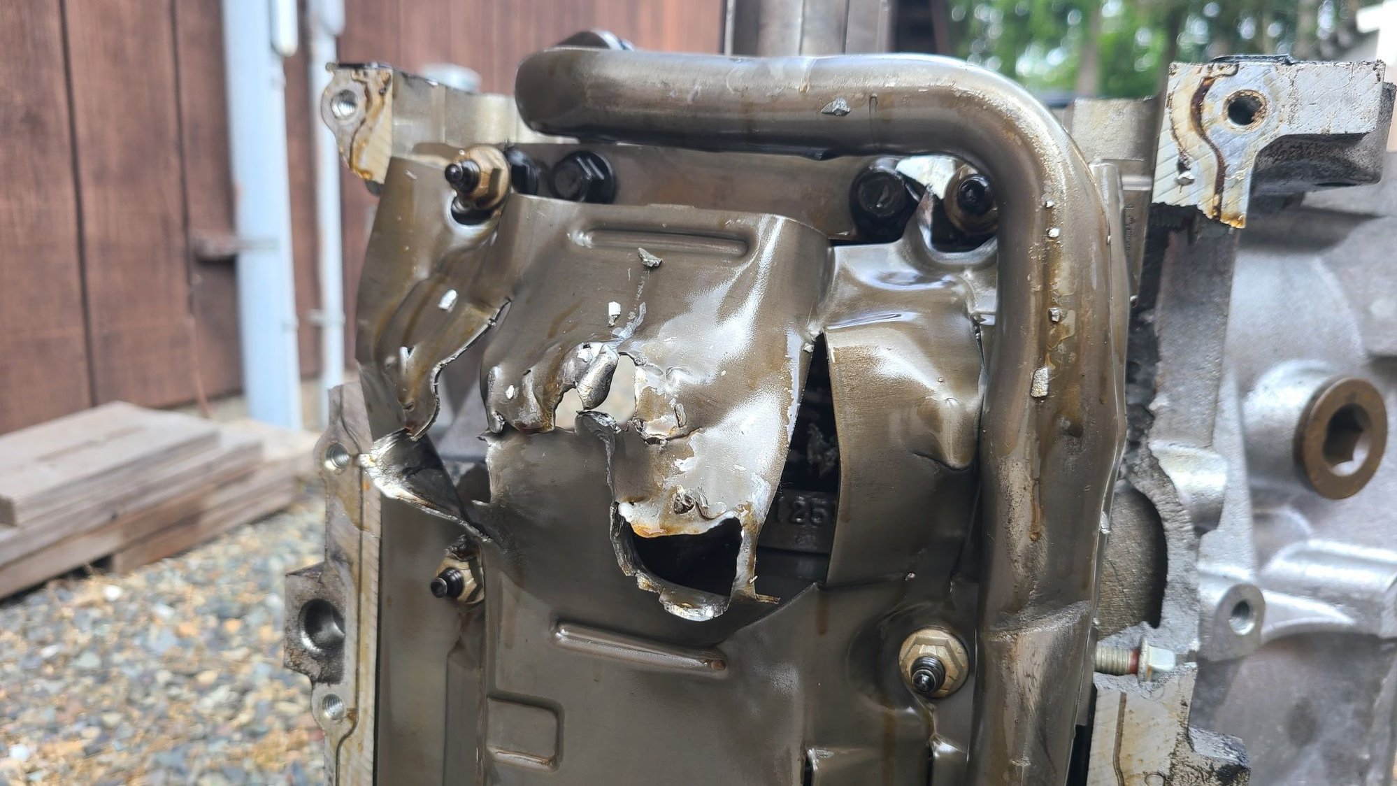

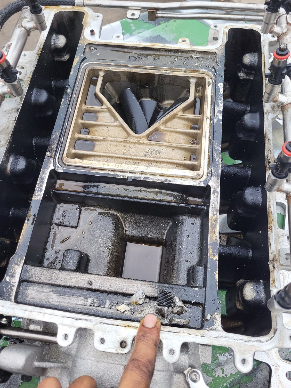

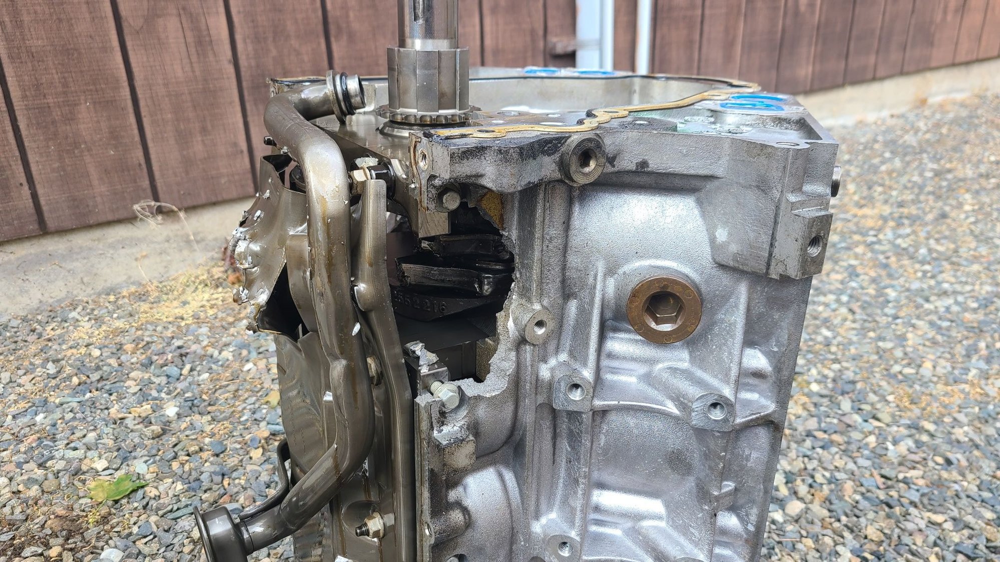

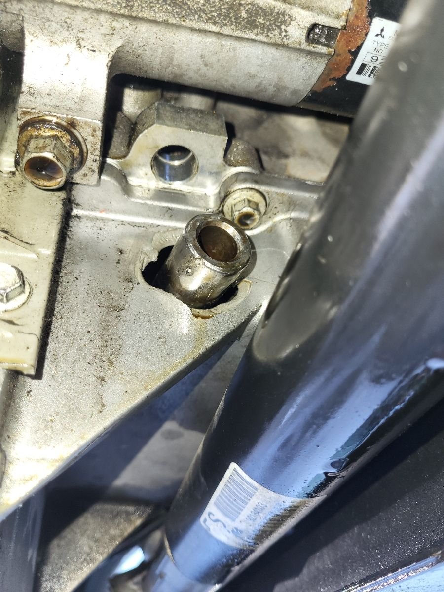

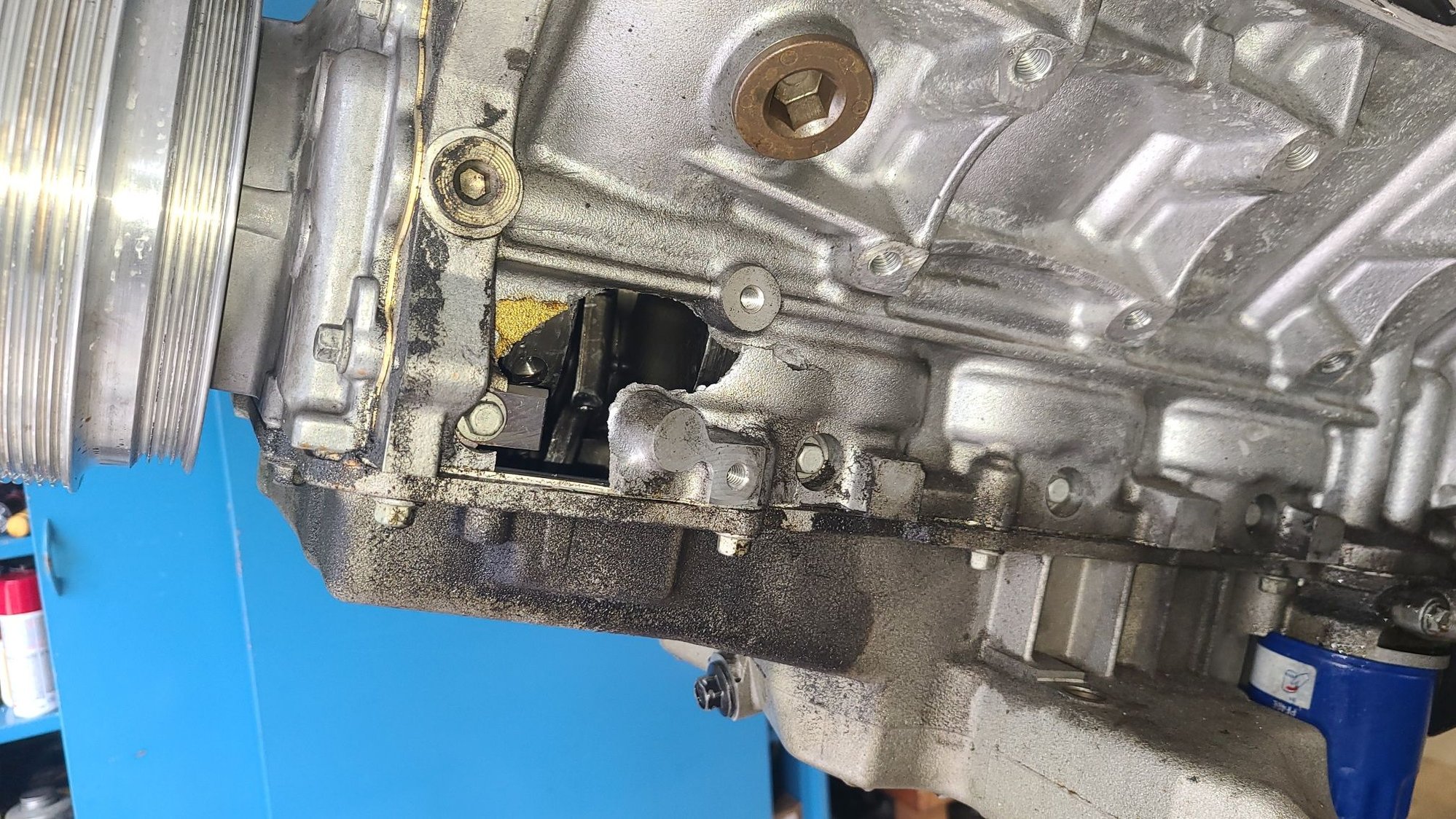

Ok so here is a short stoy. I bought the gto about 2 weeks ago. after buying it i noticed a abnormal sort of tap sound that got pretty loud after warmup (kinda a similar sound that my old semi built procharged c6 made but louder). It Didn't soud like a rod bearing to me but more of a tappy loud lifter like i've heard in the past. I dove the car about 40 miles registered it and etc. then all of a sudden it stopped and locked up at 10mph oil and and coolant everywhere. I never even took the car past 1/3 throttle as i was gonna investigate the sound 1st. I am very mechanically inclined so i started to investigate what blew up this morning and found a wrist pin had put a hole into the side of my passenger side oil pan!! then i started to teardown heads to further investigate. I took the supercharger hat off and BAM I see large chunk of cast alluminum under the hat dime size pebble diameter chunks!!! proceeded to start taking heads off and found a bent valve on cyclinder 8 and a etched piston.. I am so confused from this situation. How did huge chunks of cast get into my supercharger then proceed down into my heads bend the valve and kill the rotating assembly!! I havnt found out where the broken cast came from yet But i am assuming the supercharger destructed!?!?!? supercharger still spins and i feel no bearing damage. I have a few pics to show there is alot more details i can explain. But i am generally confused and cannot find any answers online with a scenario like this
chunks in supercharge coolant oil debri etc
bent valve and no signs of bad head gasket
piston contact
oil pan hole
b4 it blew

What a coinkidink. I blew up an LS1 LSA combination last year because I didn't do the things I should have and didn't catch on to some key warning signs.
Long story short, generally the only way you can rip a wrist pin out of the bottom of a piston is to butt the rings. I'm assuming that wrist pin in your pictures still has a piece of rod attached to it.

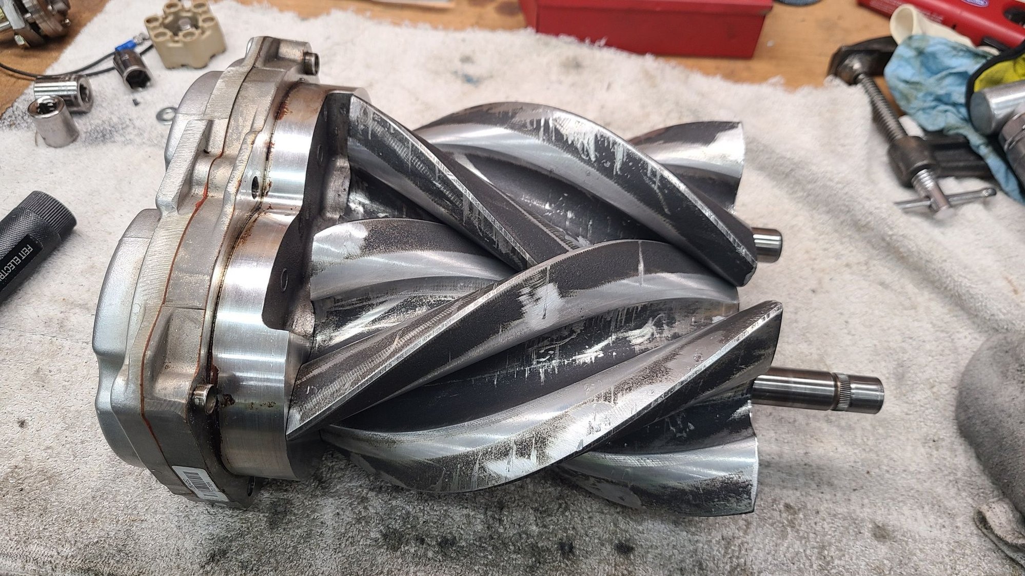

The reason that debris goes through the blower is because when the driver lifts off the gas the bypass valves open creating a massive vacuum cleaner.

One more thing to be noted when i was investigating. everything under the valve cover b4 head removal ( rocker arms, push rods, valve springs etc) were clean and undamaged with no debri, cast chunks etc.. even still remnance of clean oil. 1bent valve upon head removal. So is it possible for all those big chunks of cast to suck up into the supercharger in a split second without damaging more valves? I could litterally fill up a double shot glass with all the pebble sized chunks i found in the supercharger. I'm baffled. but I will tear the block down and rip the supercharger apart in the a.m.🤷‍♂️
Old Mar 11, 2023 | 11:18 PM
Mr. Black's Avatar
Joined: Oct 2009
Posts: 673
Likes: 383
From: South Hill, Wa
Yes in a split second. That's all it takes.
