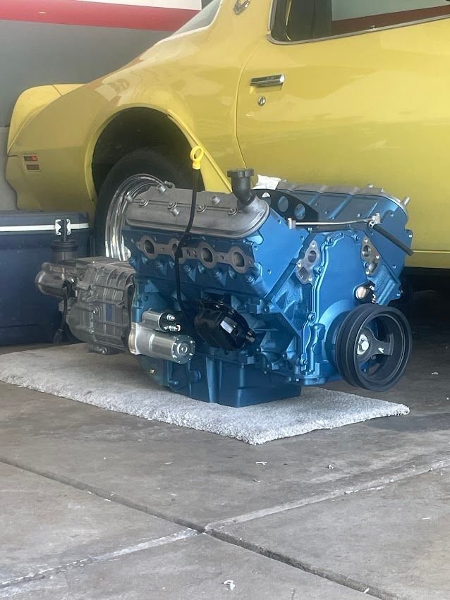

Hi All,
Figured I'd toss this in here since the build is nearing the end.
Back story:

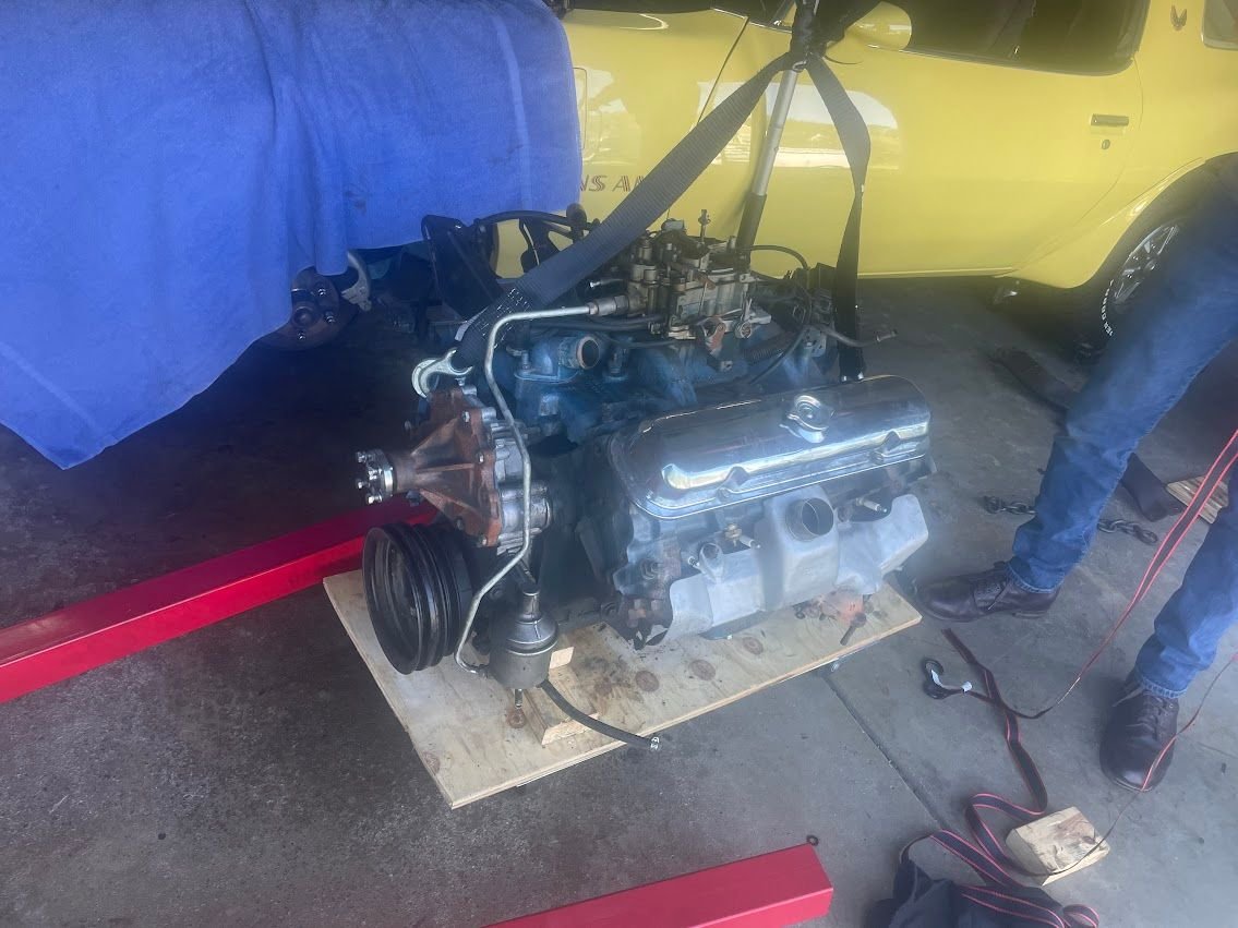

My dad bought this 1977 Trans Am 400 4 speed car from a guy in Florida, 3 owner car, 88k original miles never opened the motor up or anything (allegedly). She was a light smoker (needs rings). Leaked every kind of fluid. We crated up the original motor and trans to keep with the car.
Goal:
500ish WHP with decent torque and drivability. Keep the factory shaker hood hooked to the intake and appear factoryish with working AC.
Build:
TSP 416 CI LS3 based motor with 11.3:1 compression
Stock LS3 heads (Thanks Rich2342) with .660 Cam Motion Springs
Texas Speed 229/244 .629"/615” 110 LSA, 107 ICL (Stage 2 LS3 cam from TSP but with the LSA moved over for the rumblies at stop lights).
Holley Single Plane carb style intake with Holley Terminator X (might change the intake around later if needed).
1 7/8 Speed Engineering headers
3" true dual Pypes exhuast
Tremec TKX 5 speed with the longest 5th gear they will sell.
Vintage Air

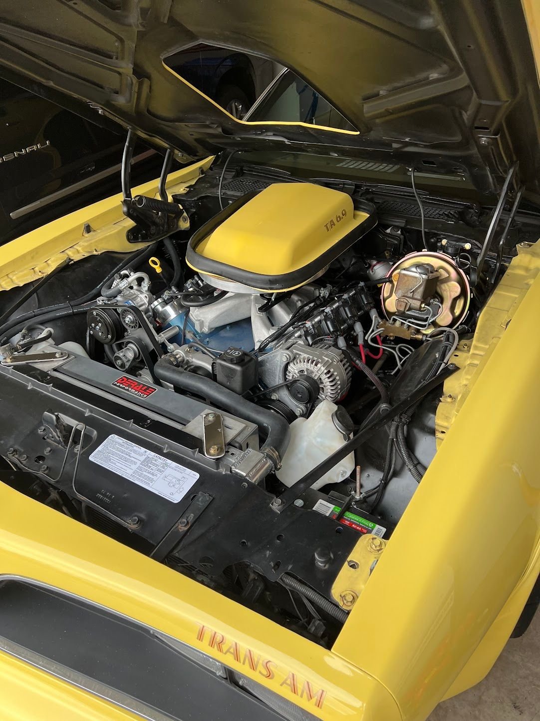

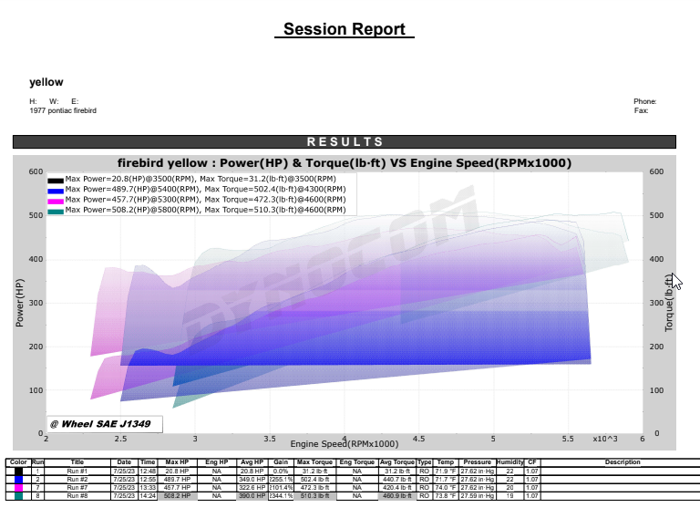

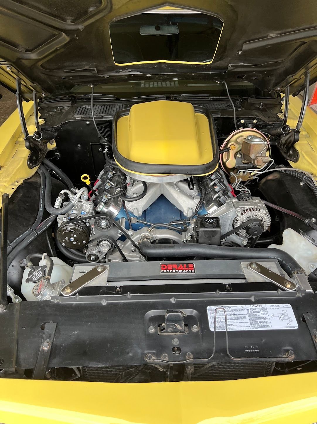

Little update on this. Car is running and driving, breaking in now.
Had some issues with non-authentic GM coils and Speed Engineering wires causing a break up. Is on a base tune as well made 508 RWHP on the dyno at 6000 where we cut the pull short due to some fueling problems that are now corrected. This was with 20 degrees of timing, and 12.0 AFR.
Going back post break in to get it the rest of the way tomorrow.

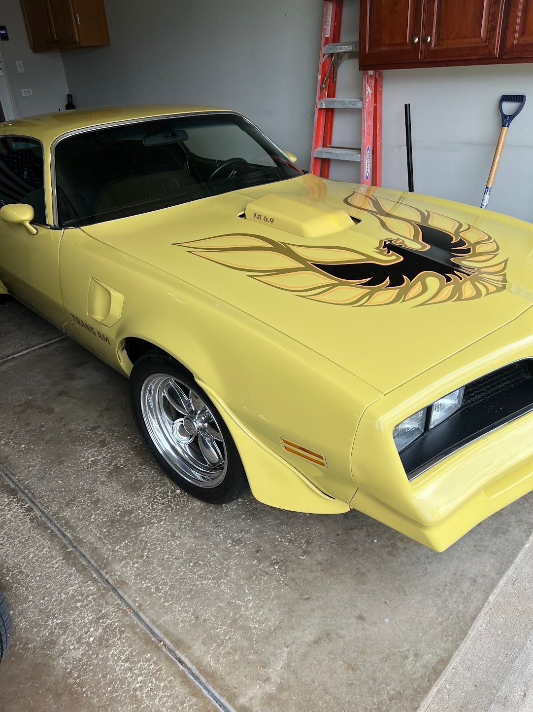

Here is the car on wheels with the coil overs on.

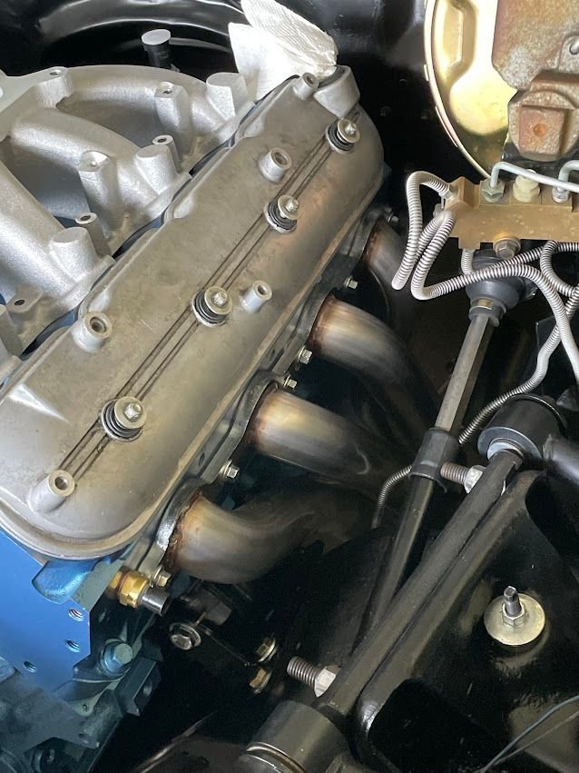

what mounts and headers did you go with?
Old Aug 3, 2023 | 09:18 AM
kmk9048's Avatar
Joined: Jan 2015
Posts: 100
Likes: 45
From: IL

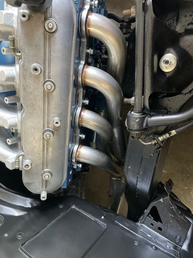

UMI 2406 mounts with Holley blackheart clamshells and poly 4th gen insides.
XFGM-10103M X-Factor trans cross member
Speed engineering 2nd gen 1 7/8th headers.
Very little adjusting was needed, it all slid right in. Fabbing the factory airbox/shaker now to fit, it actually is shockingly close just needs some adjusting.

Car ended up making 530 at the tire. Will post graph when I have it later. Now time to get the shaker working

She made a whopping 144 wheel horsepower prior on a different dyno. It was a tired 400 with 88k original miles, never opened up in desperate need of rings. It is now in desperate need of subframe connectors and poly body mounts, as when you lay into it, you can see the hood hit the fenders. Going to tackle that this weekend.
The dinky air filter also will probably go this weekend as well, was pulling 3 inHg of vacuum at WOT and taking the car out of the wide open timing table up top.

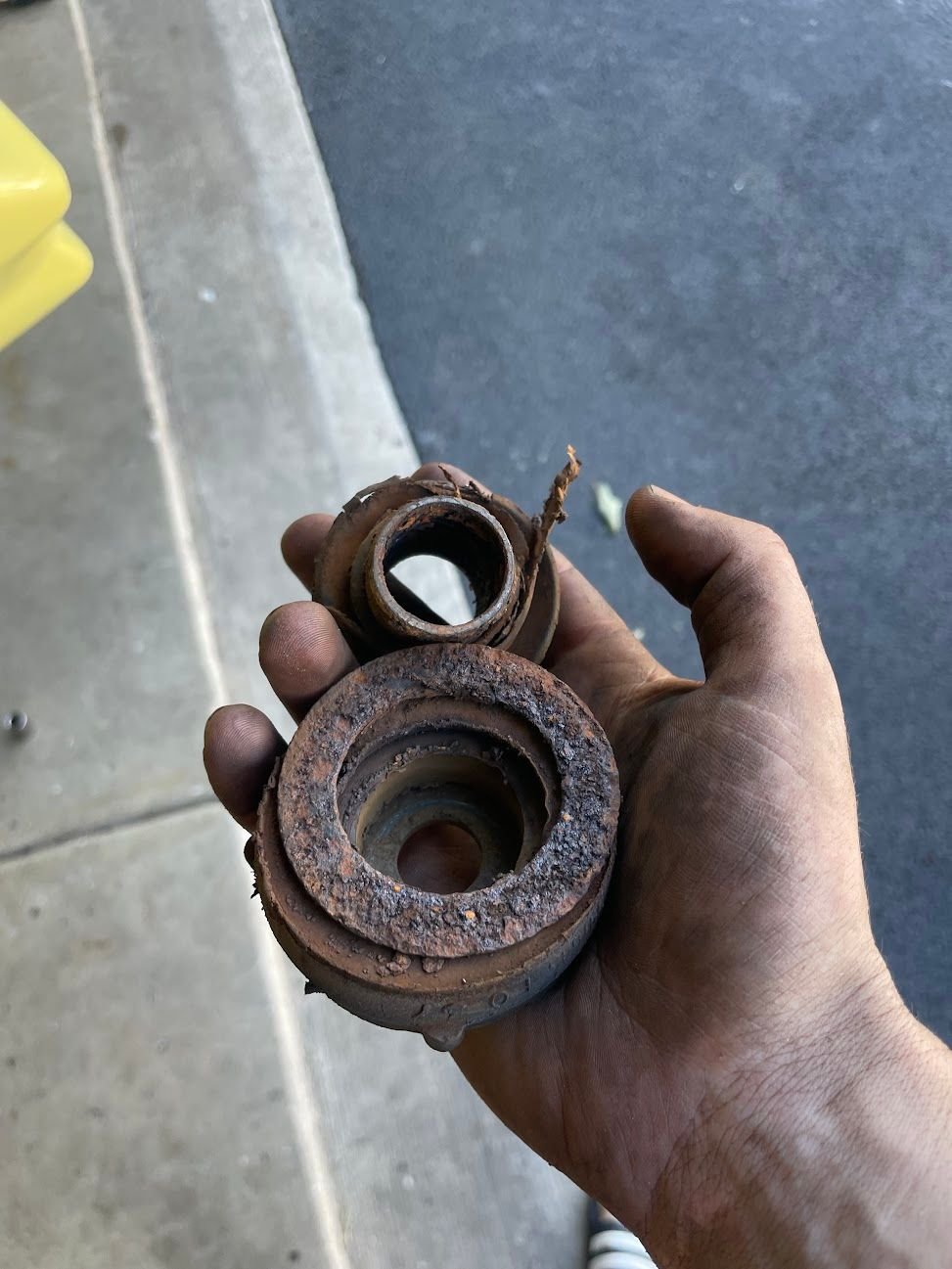

Did the body mounts on it this week. Needless to say, the body probably would have fallen off the car in a turn if we let it go any longer.....
Kicked a lot of georgia clay out of em too as it was originally from Georgia and apparently a dirt road car.
No more loud noises over bumps now

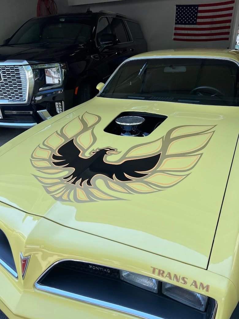

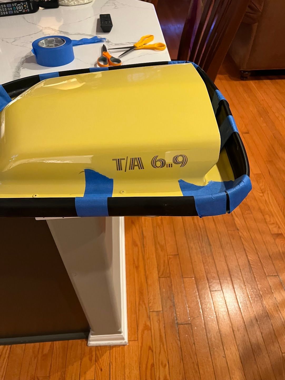

Velocity stack while the shaker hood gets worked.

I’m sure if you thought of this ,but if not you should weld up a air filter housing adapter to move it over a inch or two so you can weld ups

Little update for winter. Got the scoop worked out. Had some issues with the Holley TBI, for some reason the IAC would always go to 0 and it would either surge or shut the car off. Turns out the secondary holes on the Holley 4 barrel throttle body were sticking slightly open after a wide open throttle event. Adjusted the spring and it drives great now. Also added an extension on the throttle cable assembly so it has more leverage on initial tip in.
