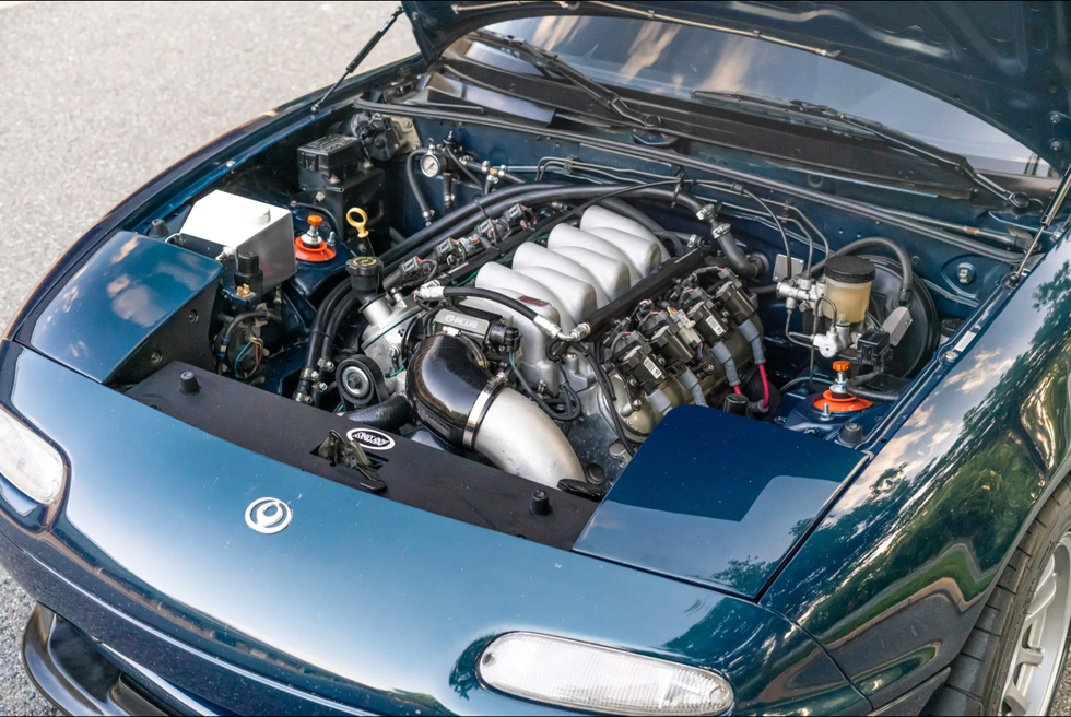

from everything ive seen, you have four general options on intake routing, over the radiator and down into the grille, to the side and down (as shown here), to the side as a u-bend, sitting just over the valve cover, or slap a radiused entry/filter directly on the throttle body and convert to a speed density tune.
With the ultra low ram I think the best option is probably to rig up some sort of u bend style intake that sits up higher in the engine bay and use some sort of heat shield and hood vent combination to draw air in.
I could route it into the factory turn signal area using a ducted intake, but I kinda need those since its a street car. Maybe someone makes a duct kit with a turn signal in it.

The clearance issues with the Miata hood are towards the front. This is my car as it currently sits. Notice the MAP connector just behind the throttle body? The hood was hitting it and unlatching it, so I cut off the latch and use heat shrink tubing to hold it together. Notice the smooth intake tube? The LSXr intake manifold raised my throttle body up enough that the stock bellows style tube wouldn't allow the hood to close ... a smooth intake tube solved that. A 102mm throttle body or similar would likely not clear the stock hood with this manifold. There is about a credit card thickness between the throttle blade motor housing and the hood. See the rubbing mark where the hood hits the 'vette intake tube about halfway down? There is slight contact there.

Does the intake you have bottleneck over the radiator support bracket?

It’s a stock C6 Z06 intake tube (the plastic part, over the radiator). It gets thinner top to bottom there, but also wider. It was a good enough intake for the LS7, and I made 471whp through it in my car … can’t be too restrictive
