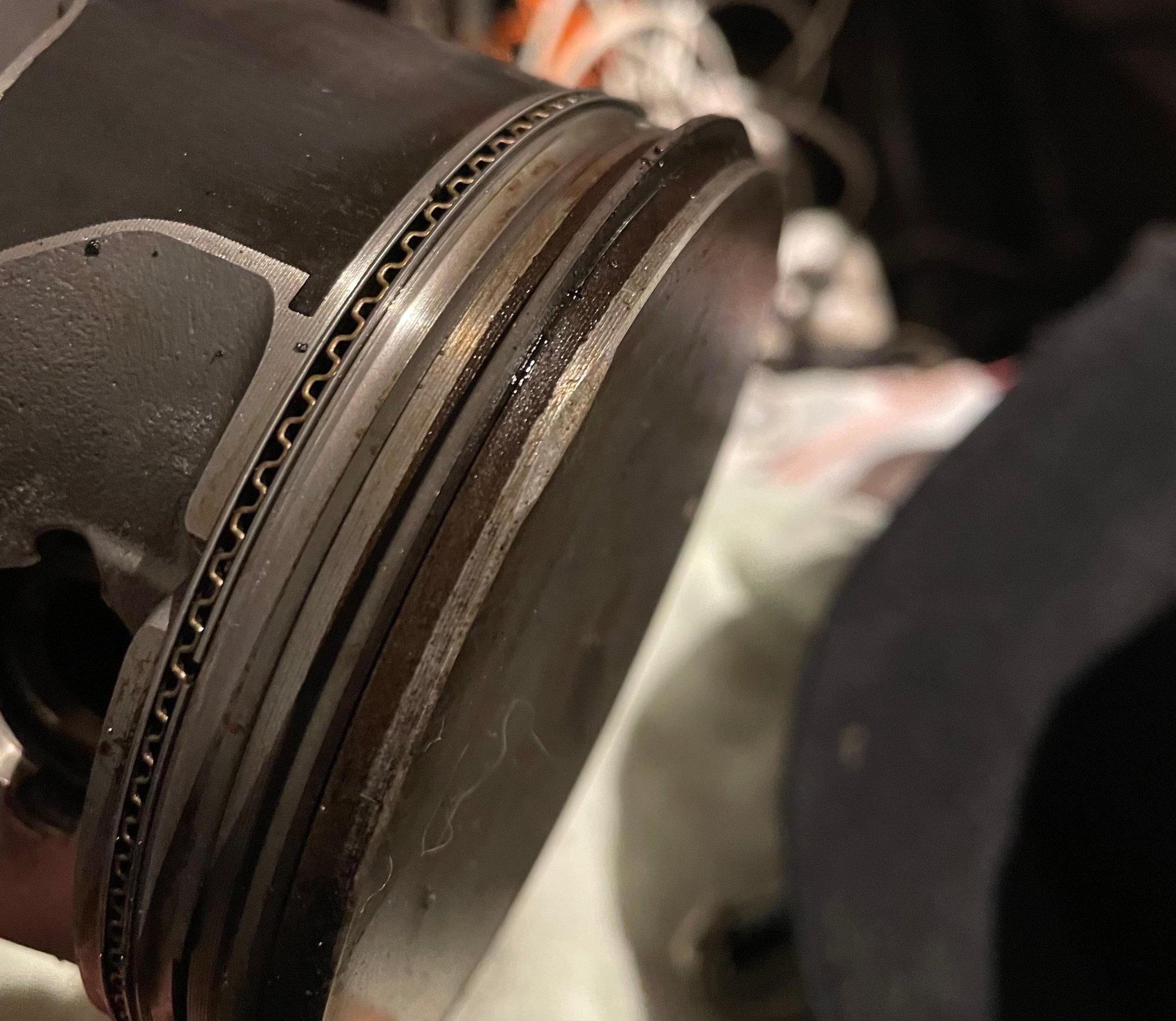

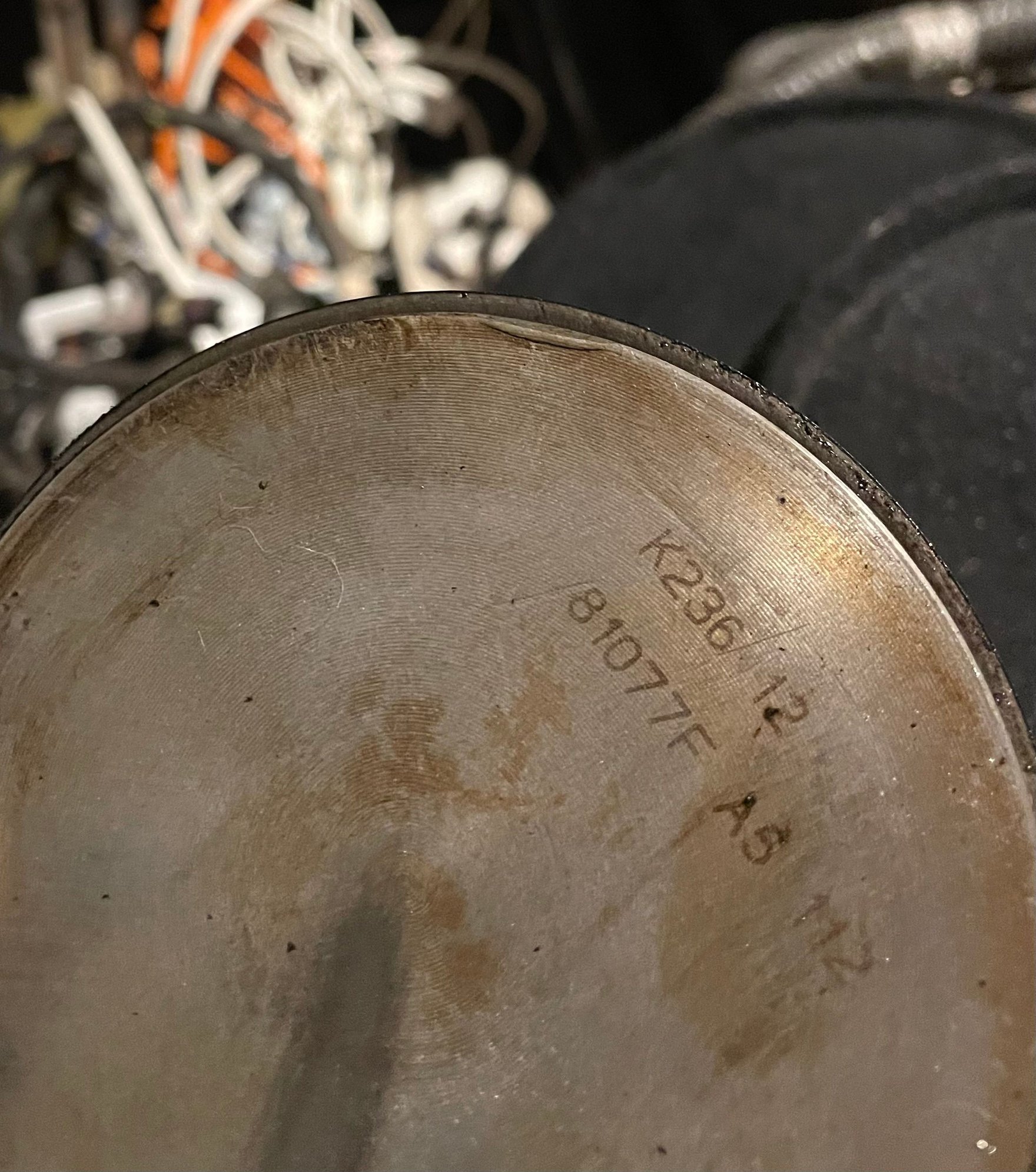

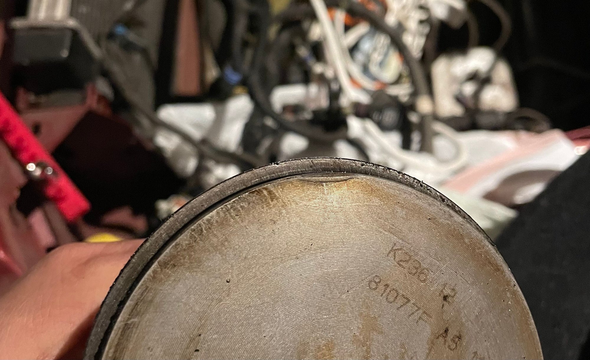

I accidentally and stupidly let a piston fall out of my block on disassembly. My knowledge and instinct tells me it’s not fine to run but I’d like some other input .

File down that ridge so it's even with the top surface and you should be fine.
Agreed. Don’t forget to clean everything really well.

Thanks for the responses ! As far as filing it down,should I use a traditional file and then sand with XXX grit ? Or start with XXX grit sand paper and finish it with XXX sandpaper?

Just use a file. It will be smooth enough. Prolly won’t take 3-4 passes. Done.

Make sure ring feels good and has same clearance as others. Don’t want to use it if ring land got pinched.
Good call sir. Great advice.
