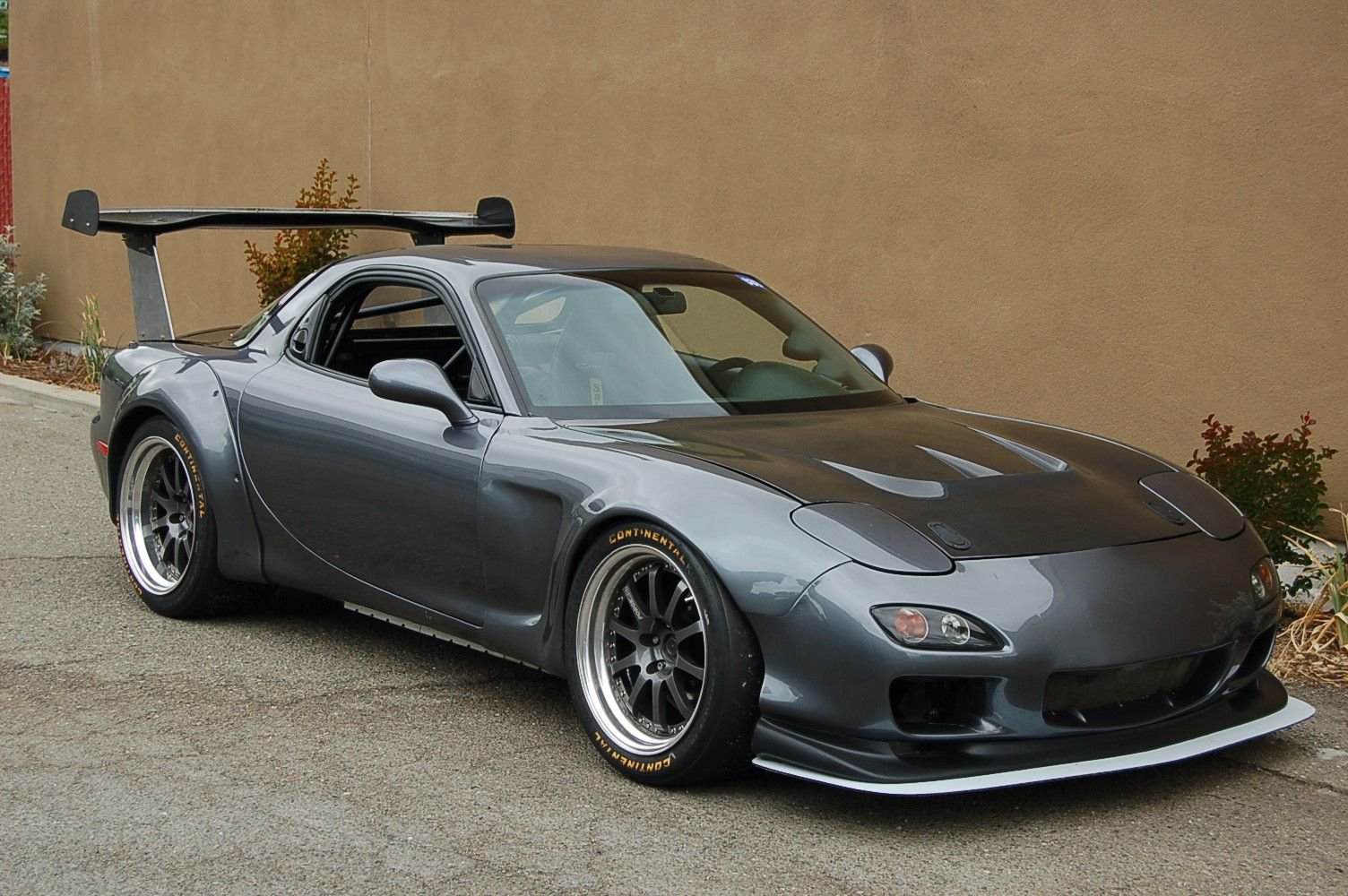

I've bought a bunch of LS2 shortblocks all with rod knocks.... GTO and Corvette. I don't know why they have this issue. Luckily most have just needed a couple rods and rings/bearings. A couple have needed a new crankshaft.
I run the RXT plus aluminum flywheel in my 416/LS7 small bore headed (600rwhp or so) 2900lbs with a/c RX-7 road race/street car and my '69 Chevelle with 1000rwhp (not tuned yet) turbo LS ProTouring setup (1200HD RXT version) without issues. Yes at 1800-2000rpm if you lug the engine in a gear or two higher than needed and tip into the throttle barely....
you can get engine harmonics/vibrations which rattles the clutch discs.... if you actually try to do it.... just don't do it. Upshift a gear... On the freeway I cruise around 2200rpm+ anyway (75mph+). Bang for the buck they are great clutches. Low effort pedal pressure and really non grabby (need to break them in properly) even the 1200HD version.
