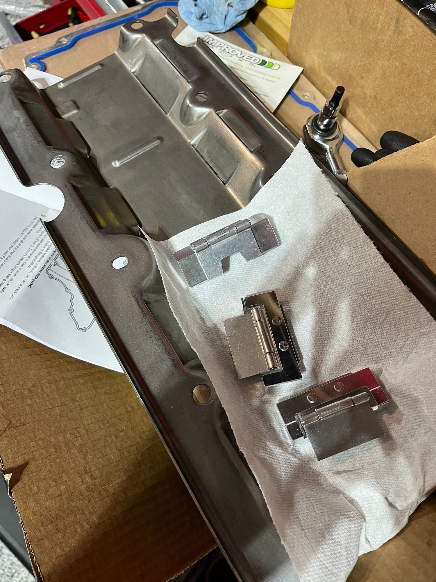

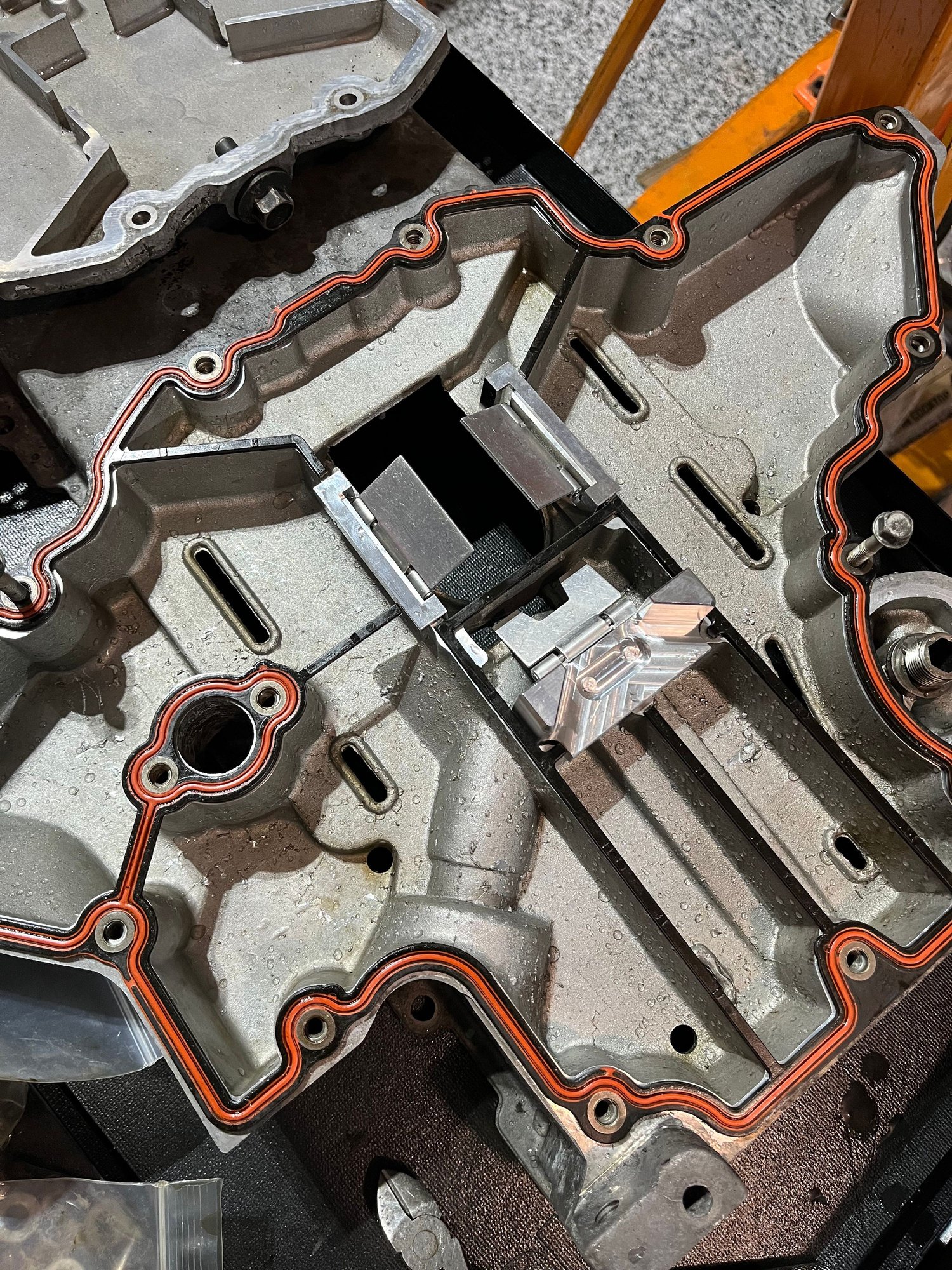

I chose to go with some cool tidbits that should be worth it in the long run. C5 Batwing Oil Pan w improved racing baffles is my favorite. Added the pickup brace (this one was really hard to install for some reason but got it eventually. I went with a 4 port steam vent kit too as I was told it cycles coolant from spots that would normally sit and possibly boil. And photos of how the dart windage tray kit looks like.

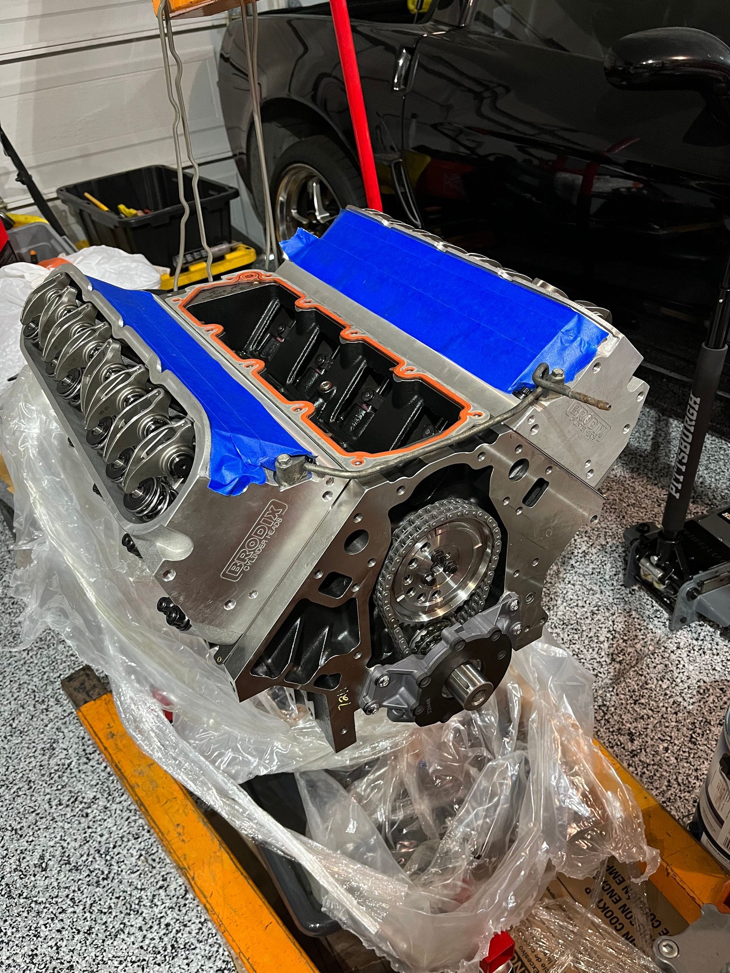

Well, I pretty much finished up last night.
Front cover went on with ARP bolts, used black rtv outside of the gasket for a perfect seal, where the pan meets got extra so there’s no hiccups there. The rear cover went on with ICT Billet bolts, and they were too long. Like only 1mm maybe 2mm too long and were bottoming out without sealing the cover up. Annoying. I found some washers, drilled all 12 of them to fit, and went on my way.
Pan went on, took me a second to figure out how to get all the bolts in. You have to like, tilt the pan up to get the bolt holes to line up properly, then you can snug them down and torque.
All the sensors are pretty easy reach so I might reuse some old ones I’m not too sure yet.
I do need to buy a C5 dipstick though. Super awesome that the dart shp block has a provision for that. Photos!

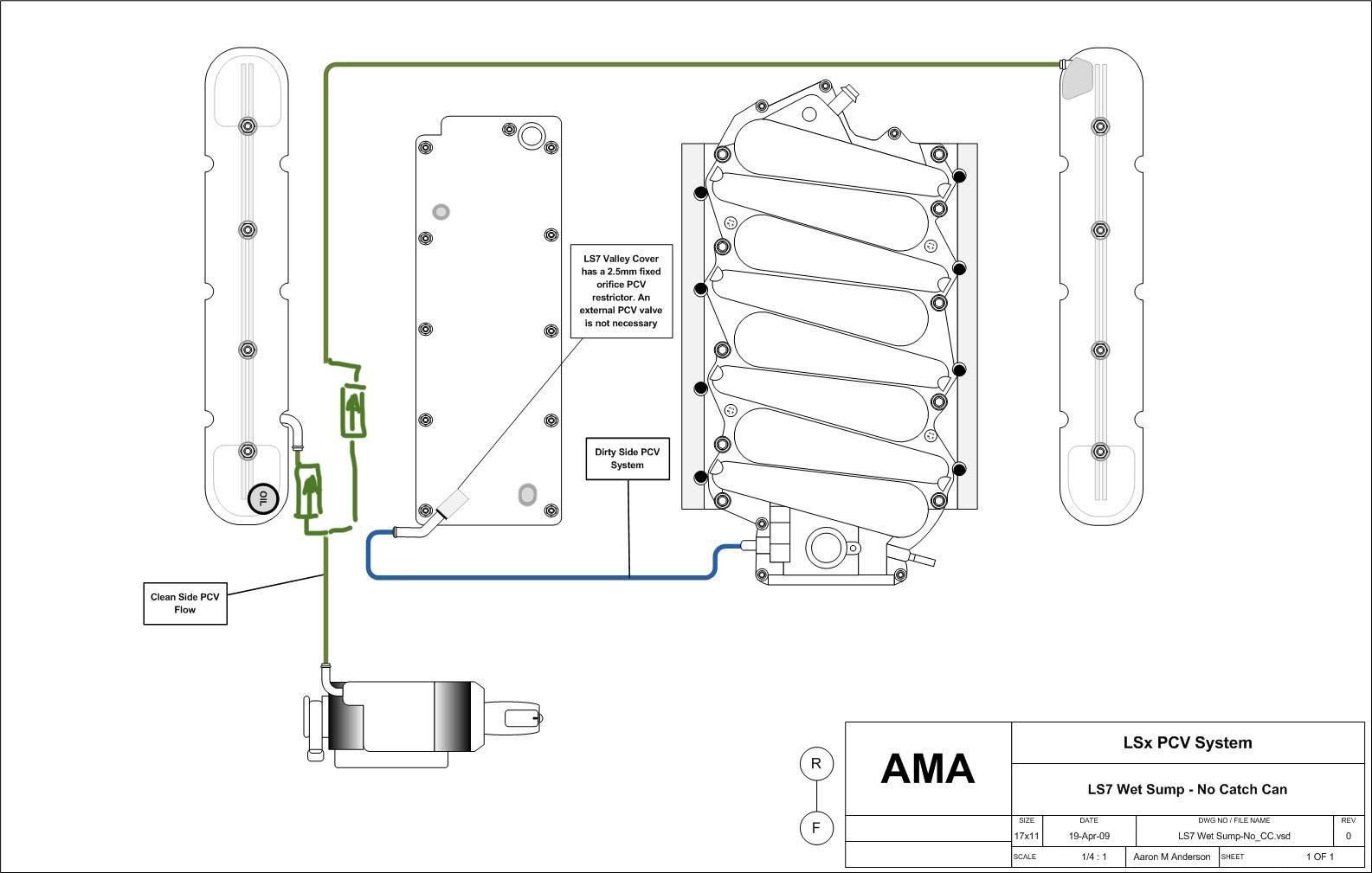

Next will be pcv lines. At the moment I'm not going to run a catch can until after I get the engine in. I included a diagram of how I'm going to set it up the pcv system.

PCV system. If you see an issue yell at me
Might run a valve on the dirty side just to make sure the flow is correct at all times.
Arrow box represents a valve.
