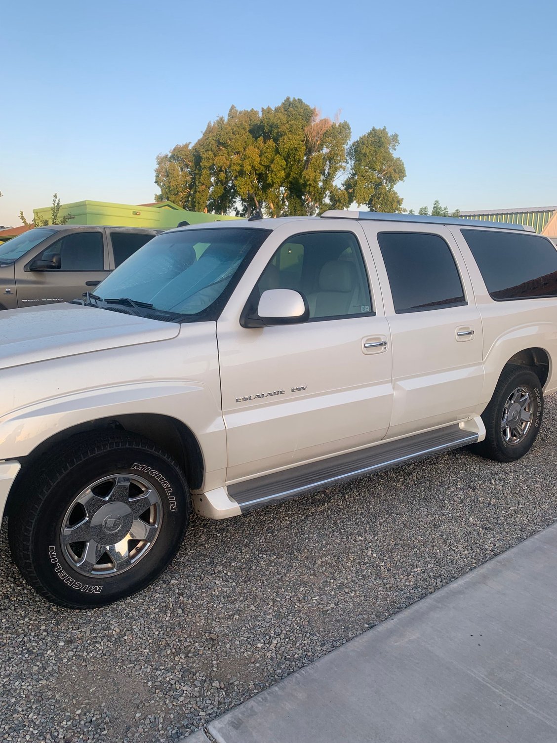

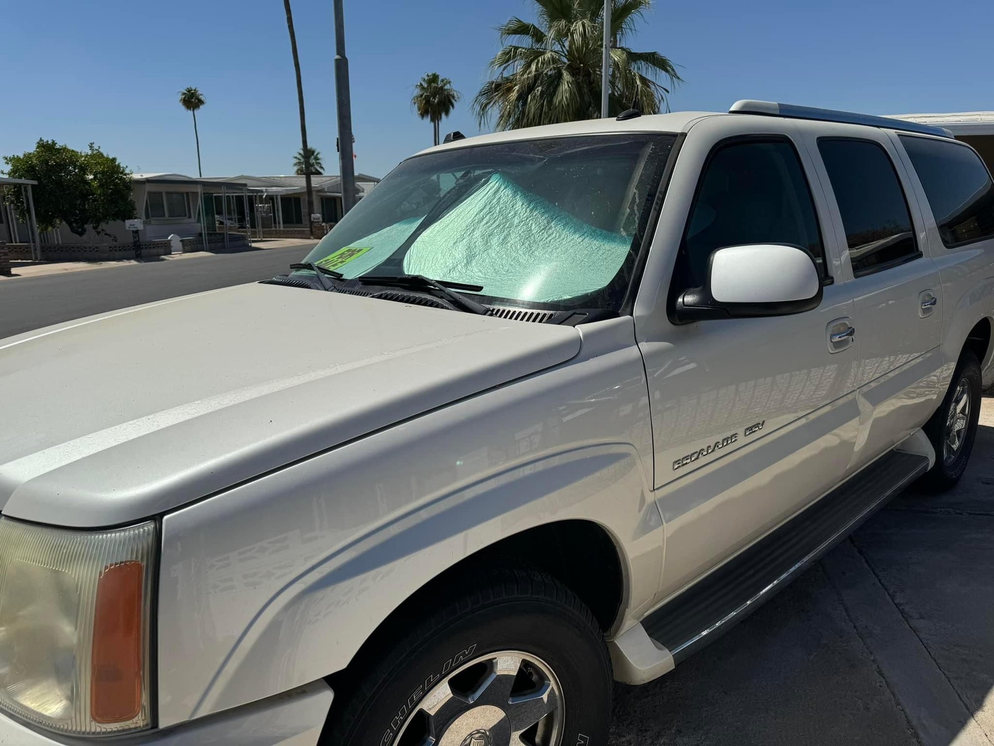

Hello everyone, I am new to the forums. It’s been a while since I’ve been in the American auto forums. My grandfather recently passed and he left me his 2005 Cadillac Escalade 6.0 AWD LQ9.
it’s just over 100k miles in pretty good shape. I plan on using it as a family vehicle with some possible towing in the future.
I am aware that the transmissions in these need some up keep. Having that said is there anything any of you would recommend for this vehicle to get some extra torque/HP?
I plan on getting a better air intake mini-fold. Can anyone guide me into some headers and exhaust recommendations? Or some mods that would add me some extra HP that doesn’t require internal upgrades. Links and website information is highly appreciated.
THANKS!
