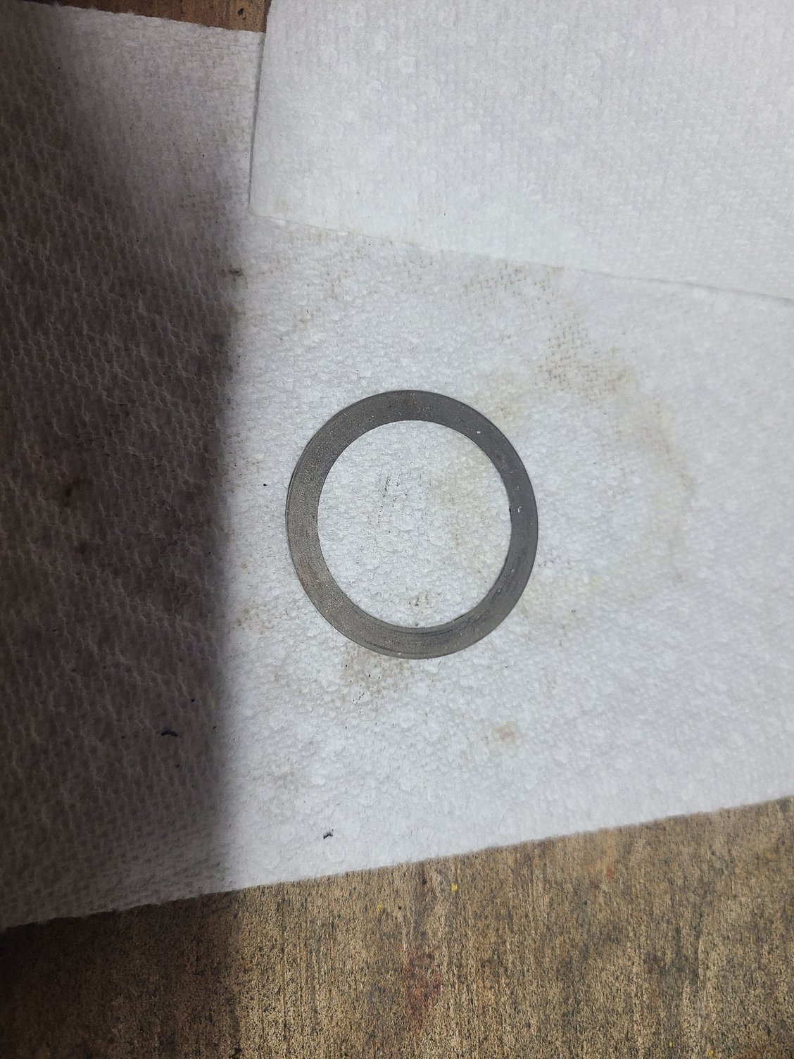

Forgot where this .0055" thick washer goes. It either goes on before the timing/oil pump drive gear, or after it between the gear and balancer. Im guessing the latter of the two. Wet sump LS7. TIA.....

between the gear and the balancer
were you have a key crank you don’t have to have it
It’s for a non keyed factory crank

Thank you, very much. That's what I thought, but wasn't 100% sure. Short term memory isn't quite as good as it once was. But that's the only thing I haven't been sure of, at least so far! So I think I'm doing OK for an old guy....
