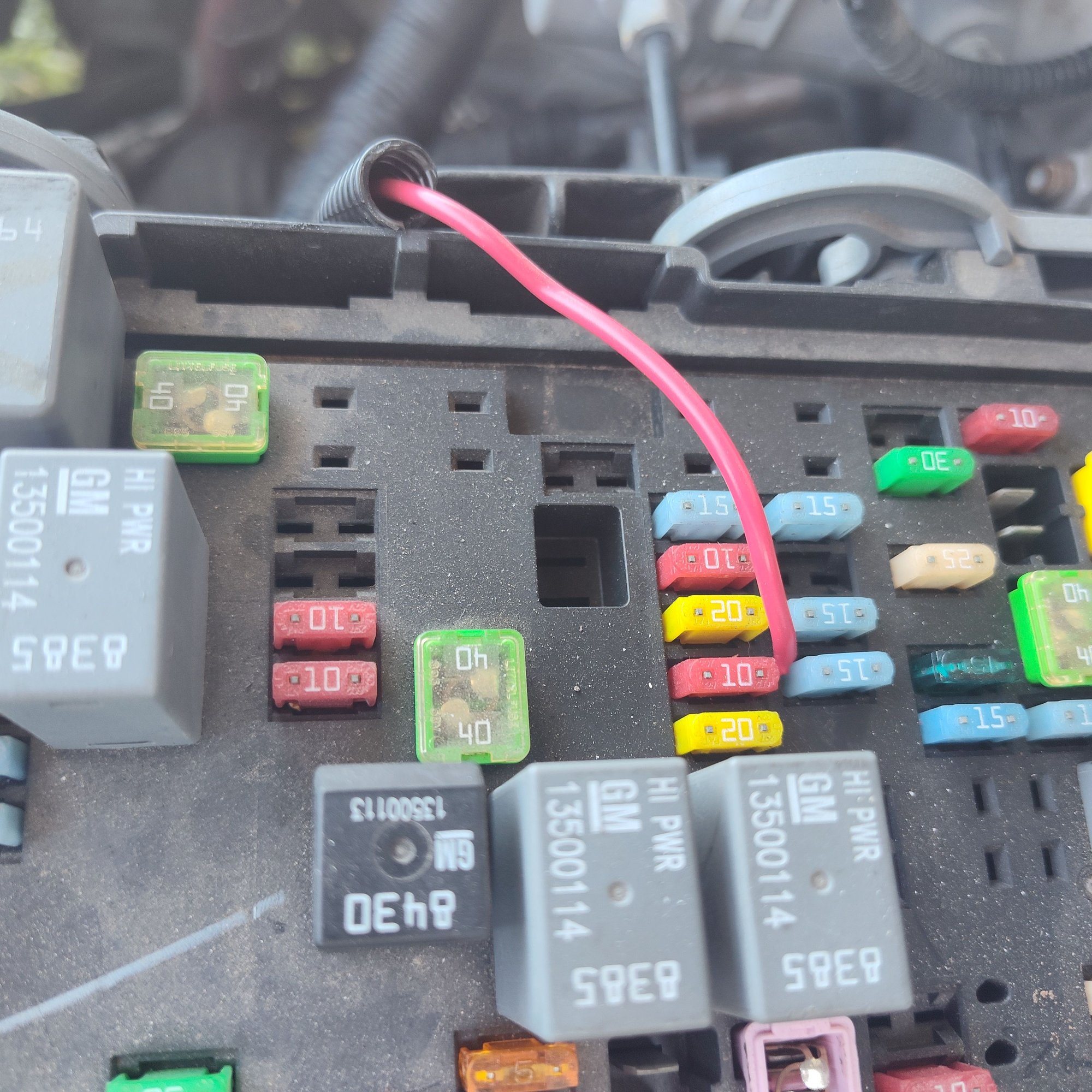

My P0700 was resolved when I noticed my trans cooler fan wasn't working. My fuse checking of TCM Batt showed good but the signal wire is going to the TCM-IGN and shorted it out giving no power to the solenoids.
Kinda weird considering I have had that thing running fine no issues for a few months then all of a sudden after reinstalling the engine an issue. Must check that further along with the oil pressure which can wait a day or 2.
12-1500rpm produces near 40 so I feel safe with it idling at 20psi as long as it doesn't continue to drop. It's interesting to see with HP tuners how timing affects oil pressure by a small margin. More load induced by higher timing steals a bit of pressure I assume because of the lifter pump up behavior?

Where should I wire this thing so that it doesn't pull the ignition signal from fuse 19 for the TCM ignition as in what circuit would be safe to pull two amps from? Or is the issue the way that I wired it without a dedicated ground for the control unit. Since it has a common ground with the relay going straight to battery I figured that would be safe.
I have it wired like number two in the diagram sort of.
