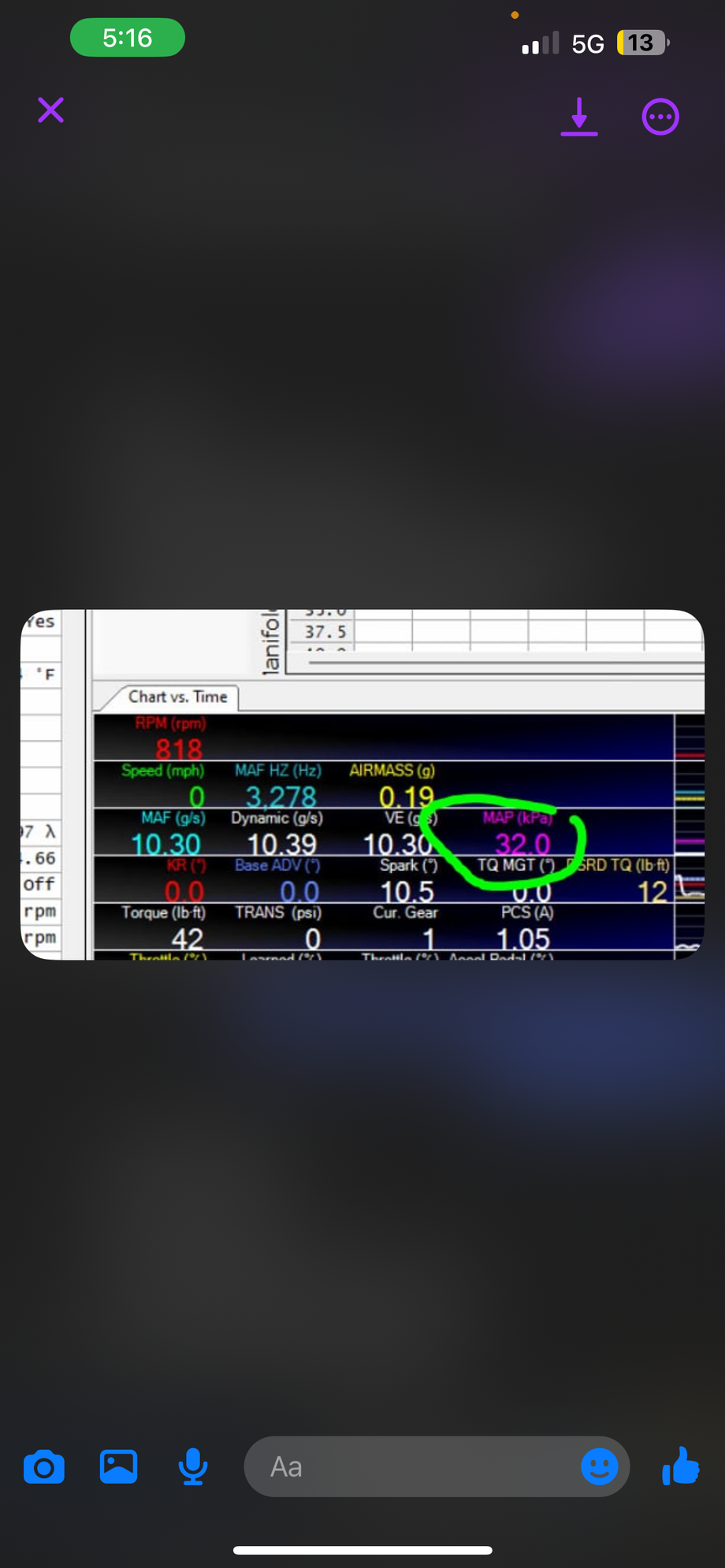

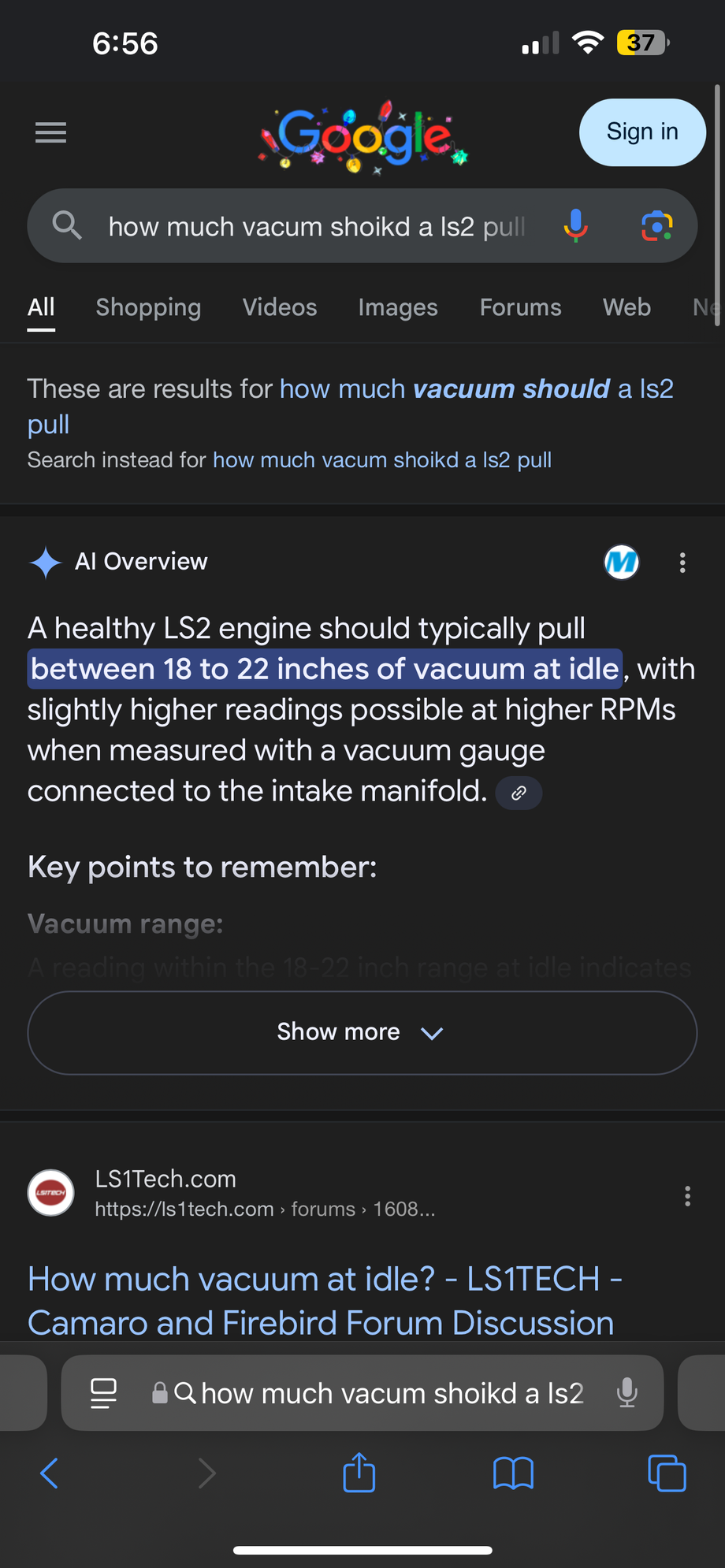

So I just got my entire car together and tuned (2005 c6 ls2 a4) and while tuning it we discovered the btr stage 2 cam that was bought in 2020 seems to be smaller then stock the way it’s not loping out at all and the way it’s pulling vacuum and the way it’s driving so now I have to do a quick cam swap but I’m unsure of which cam to exactly go with my specs that would matter are

The kpa my motor is pulling with this supposed stage 2 btr cam
The kpa a stock ls2 would pull
The kpa a stock ls2 would pull (don’t mind the crappy spelling for the google search LOL)
