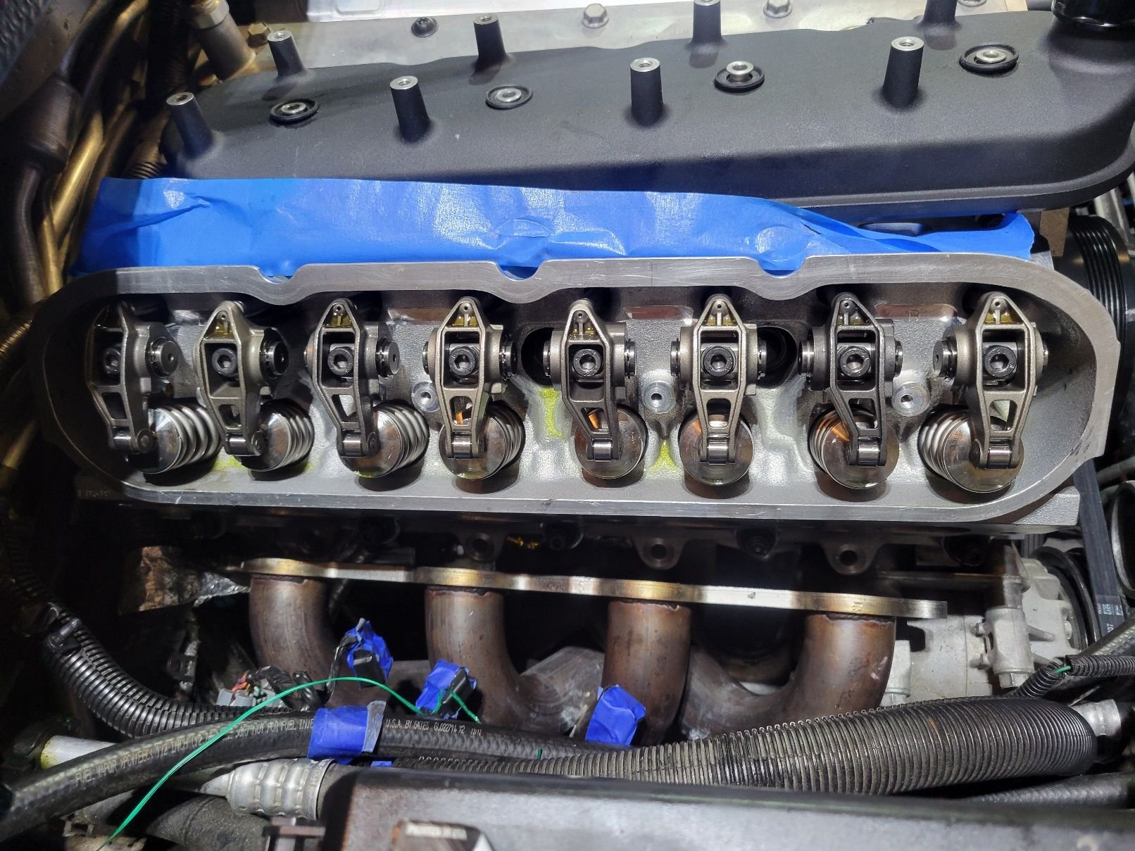

On my LS7 steel TSP Roller Tip Rockers it was a direct bolt on the preload was the same with the OEM rocker. With the roller tip you need to add a little more spring pressure for the extra weight. From what I could see it was like another 30 pounds of open spring pressure.

TSP direct bolt on, no new pushrods needed (same preload and good wear pattern). The shaft system is nice I have Brodix heads which have a more robust pedestal which is why the shaft system is nice for OEM heads.

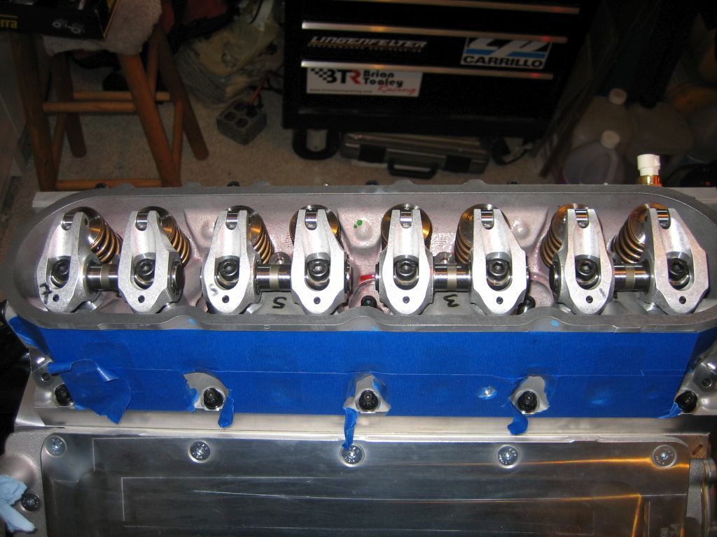

I'm very happy with the Yella Terra Ultralight rockers since my valve lift is around 0.650" -- more stable with two rockers sharing a shaft.

which bolt size are you running? Stock or MMS oversized?
