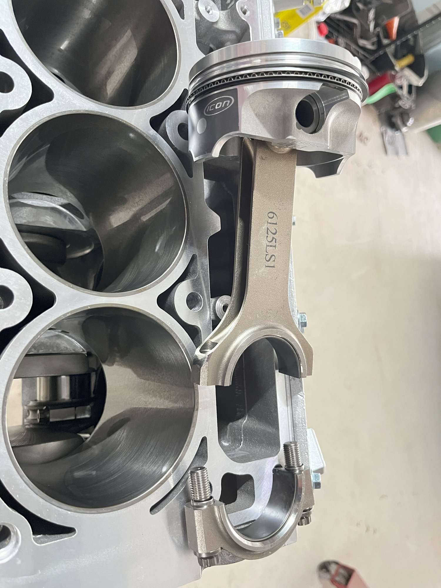

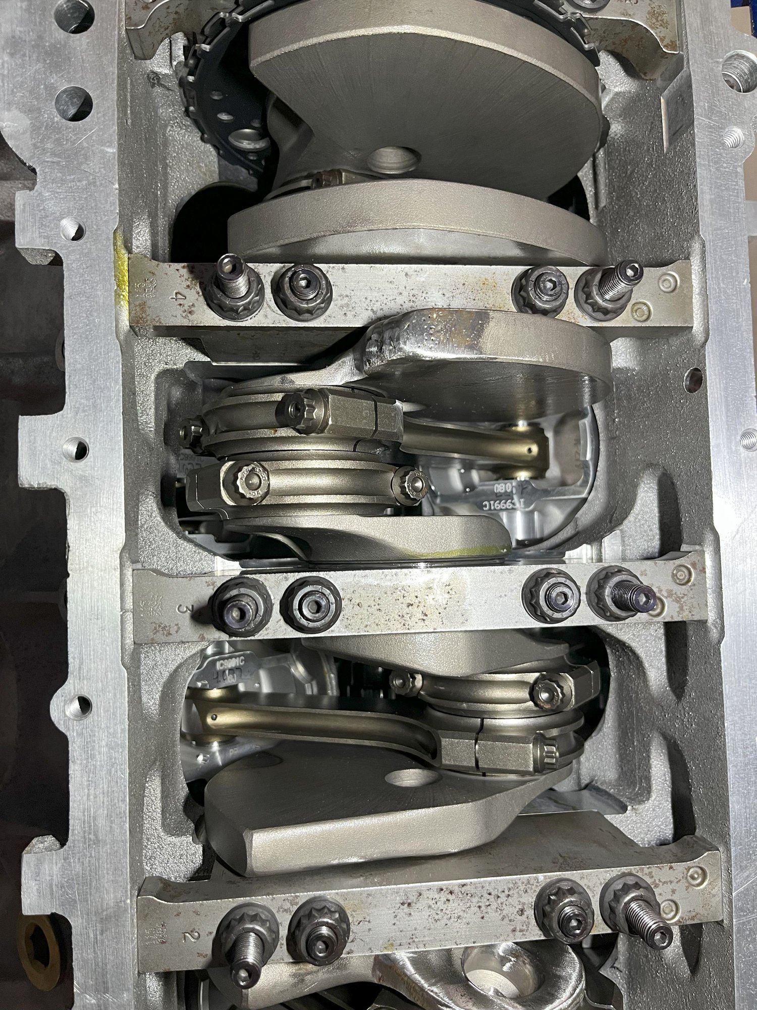

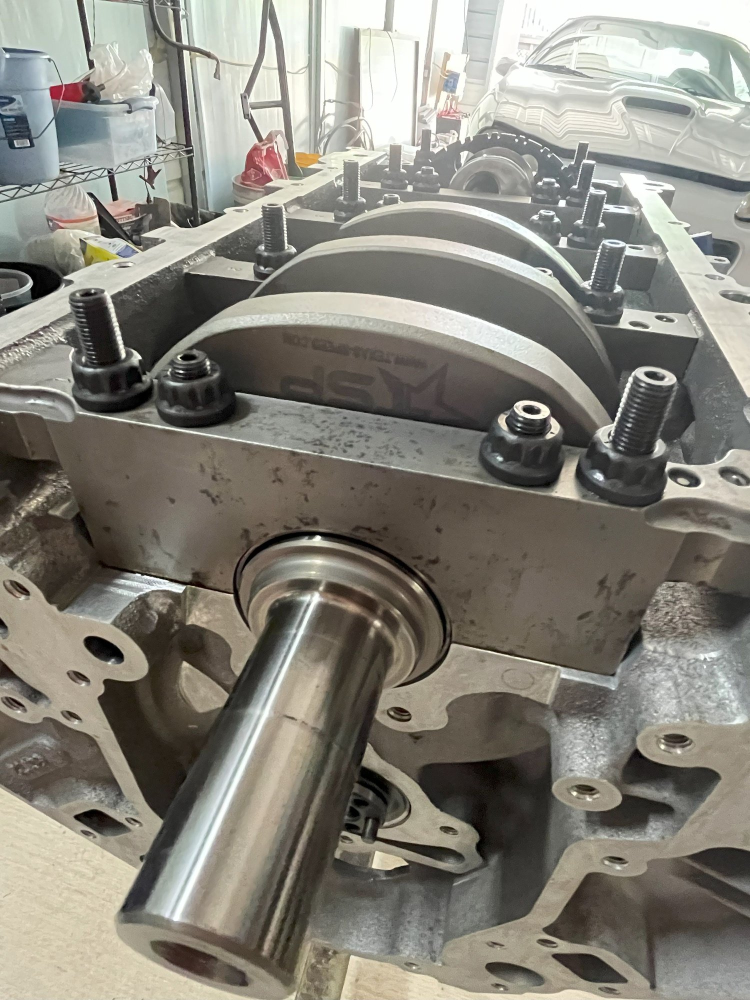

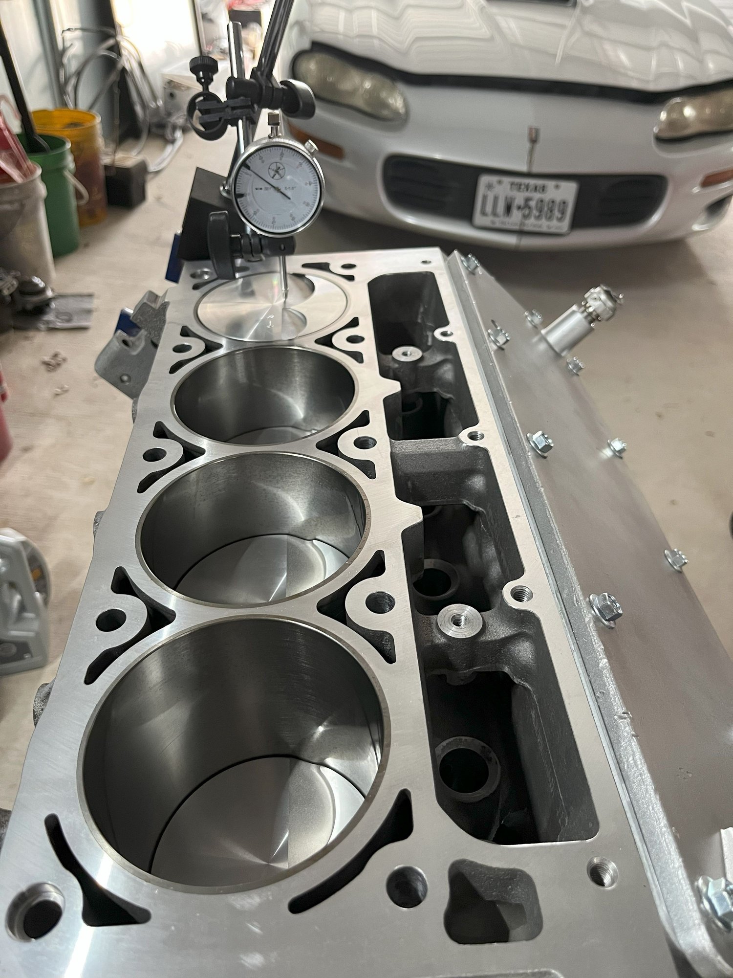

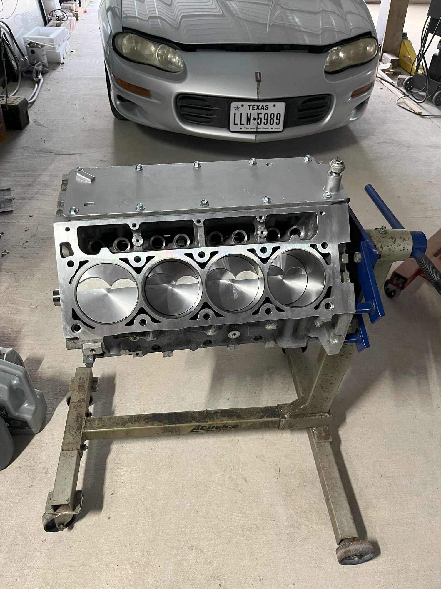

UPDATE:
I finally found time to get the block back to the machine shop. They fixed the issue and installed the cam bearings for me. Now, the cam slides right in and spins like it should. This budget 418 build is back underway. Here's a few pics:
cam installed
cam installed
new cam retaining plate
new 4
new 4" crank installed
forged pistons and H-beam rods
going together
going together
bottom end almost done
checking deck height

Old Apr 30, 2025 | 09:05 PM
Posts: 7,827
Likes: 5,172
Urinator, best case scenario is you found TDC with that magnetic base mic setup, but you can’t find deck height with that tool. You need a deck bridge to be accurate, in finding deck height.
Old May 1, 2025 | 06:28 AM
Utinator's Avatar
Joined: Dec 2017
Posts: 1,030
Likes: 219
From: San Antonio
yes, you are correct. I was getting TDC with the magnetic dial gauge. I don’t have a bridge, so I use a metal ruler and feeler gauge to check the gap. Turns out, theses pistons are right at zero deck.
