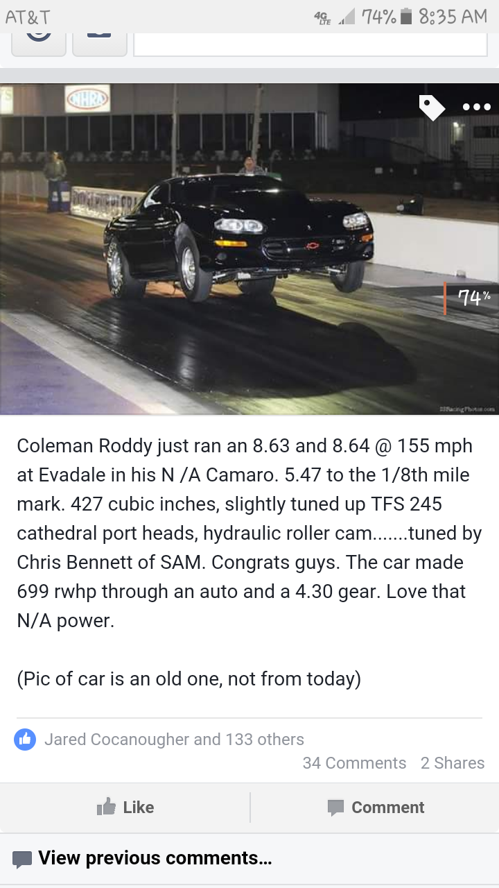

Check this out

Very fast but a 7.0L vs a 6.0L is not a fair comparison. I think we can admit that all things being equal (stock vs stock, cnc vs cnc, aftermarket vs AM) rec port heads have the advantage up top and cath port have the advantage down low and typically with compression.
I also think with your current cam, you would have had better gains with your rec heads than you did with the other. Its just a better cam.
