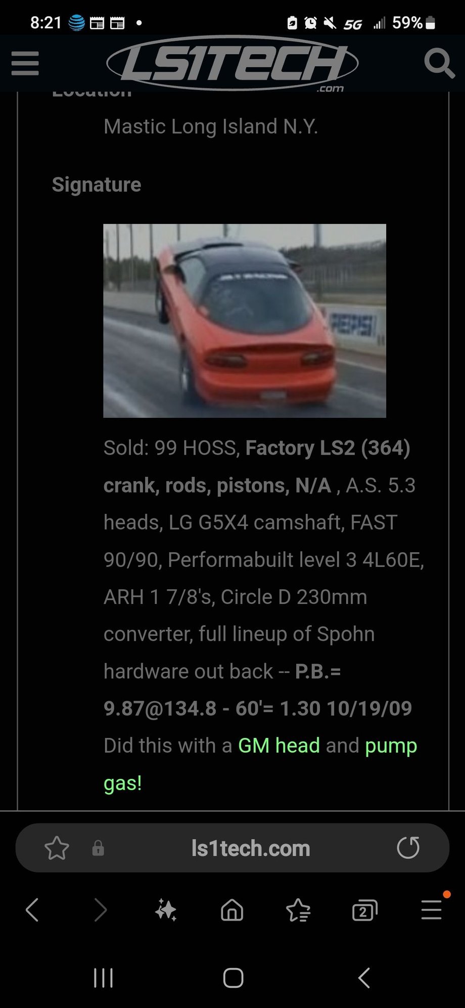

I have done my home work on this topic. The FASTEST two hydraulic roller stock bottom end LS2 cars have both run cathedrals. One is ZZRacer at 10.2s at 130 plus amd the other car run 9s.
naturally aspirated.
Show me better results and i will swap my top end again.

IIRC, and I think I do, Alan Futral had a 346 LS1 6 speed in the 9s (first 346 6 speed in the 9s) back in the early 2000s, and in that time period they had to be cathedral. Cathedral ports haven't gotten much love since the LS3/LS7 heads have been released. They can still be a very formidable street/strip weapon.....
