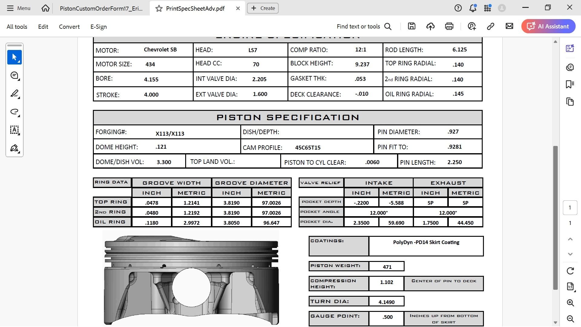

Am I reading my piston specs correct?

If I am looking at this right, I have dome top pistons with +3.3cc piston volume? If I remember correctly, they did look like they had a dome top.

Eric, the “dome” you have is basically canceling out the valve reliefs, making this a true flat top piston, per say. In other words, you have 3.3cc worth of reliefs, and 3.3cc worth of domes. Very common for compression engines.
​​​​​​…..edit….who made this piston?
CP-Carrillo.
