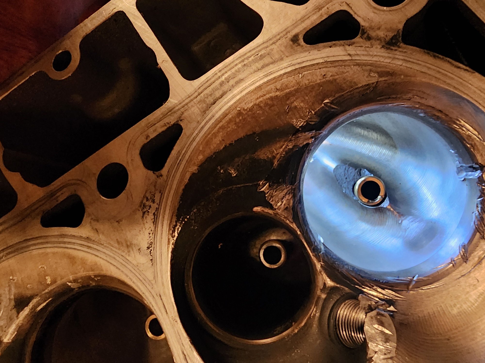

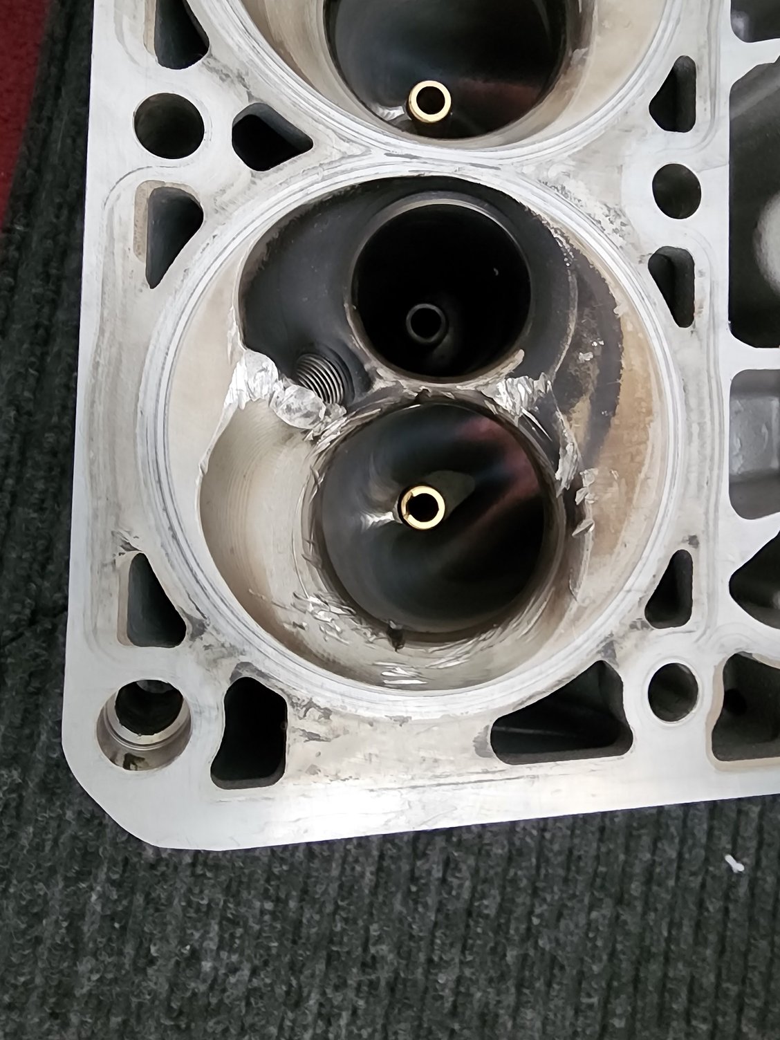

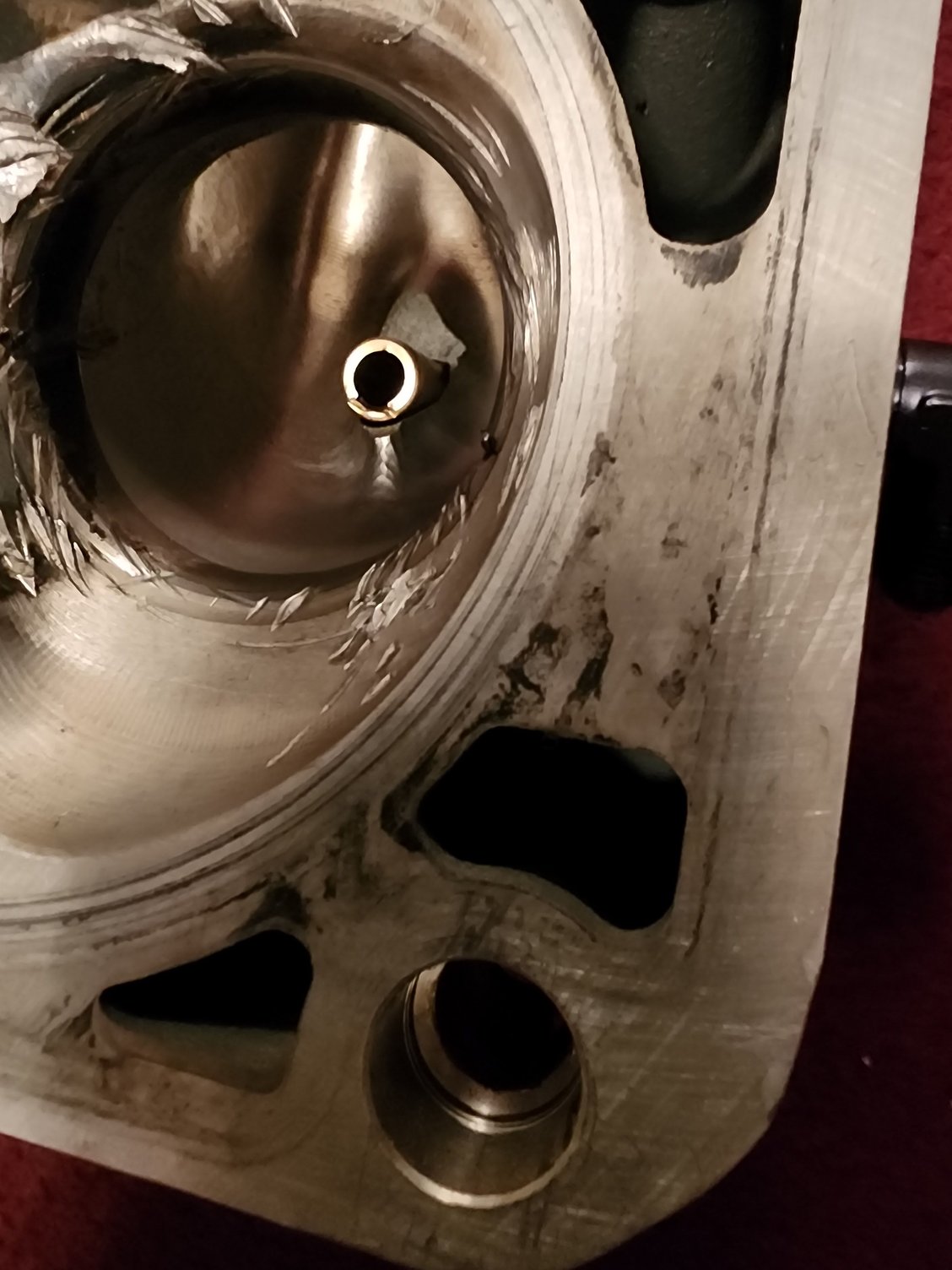

Here is a pic of the damage ... both seats would need to be replaced but the chamber wasn't dinged up as much as some that I've seen. The tricky part is repairing the "wing" off the guide in the intake port. I approached Greg Good and he wasn't interested ... he's got enough to do as is. Pretty CHE guides!

Honestly you might be better off looking for a replacement head. By the time you invest into repair it will more than likely be the same if not more in cost. I'd contact Bryan over at LME and see what he says.

I thought of that except that the heads were ported by Greg and that might be difficult to duplicate. A replacement head would need to have the CHE guides installed and the angle milling done then have the porting redone. Obviously, doing one head would be cheaper than starting over, but I'd be in machine shop jail for quite a while either way. This head needs some welding, a couple of guides and valve seats replaced ... automatic reduced sentence ... maybe.

That guide where the wing needs to be repaired is going to have to be replaced any way so it should be a non issue to weld it up and shape it back before a new guide goes in.

That’s honestly not too bad, I’m surprised Greg won’t help you. Maybe tell him you’re in no hurry? Heck, I’d fix it but it would be winter before it’s ready.
