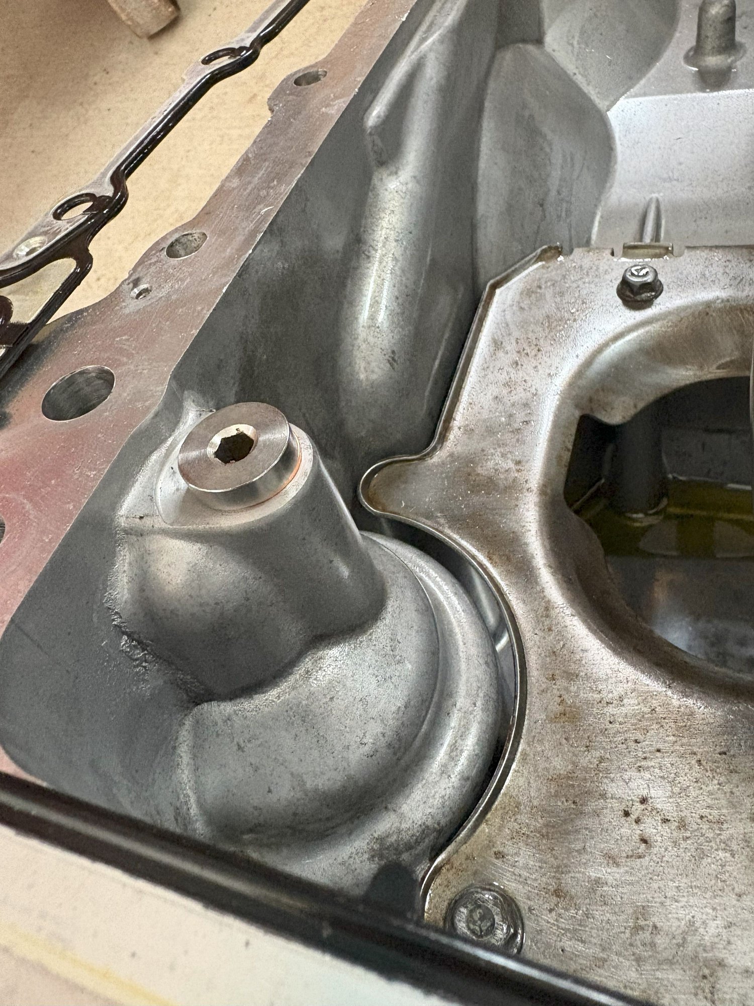

Ok, I installed the plug in the oil pan. I got a 2-pack in case I ever need to do this again. I also put the oil pump back together and bolted it on the engine. That's when I noticed the problem. This is one of those, "I can't believe I didn't notice that" kind of moments. I'll just post the pics and let you see for yourself.
Oil pan plug
Oil pan plug
Oil pan plug
Oil pan plug
That's where my oil pressure was going!

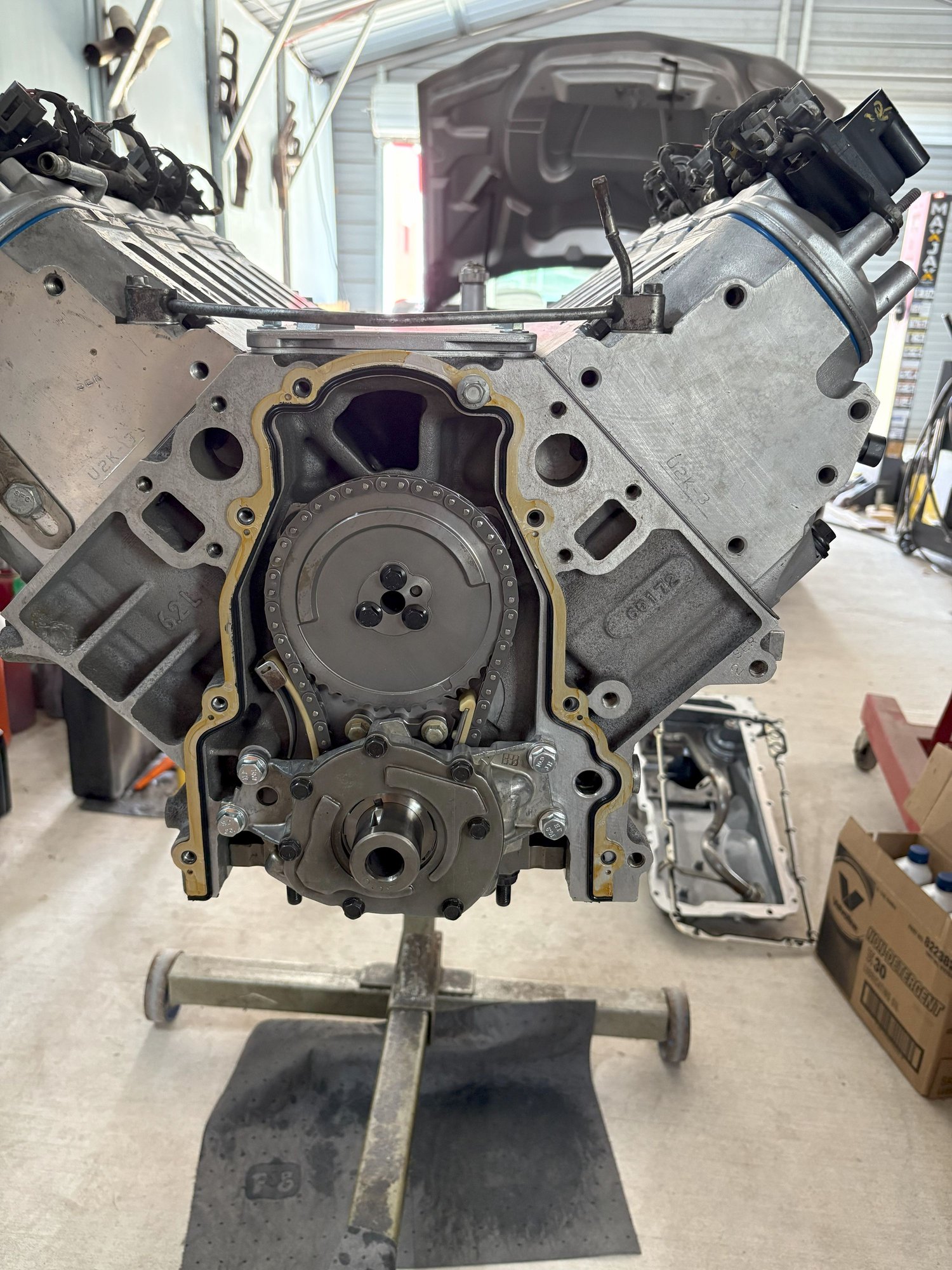

I have seen a number of those springy timing chain tensioner fail...I would recommend the solid style guide

x3 on that style of tensioner... seems that in every kind of engine that uses those, they're a maintenance and/or failure point.

Front Oil galley plug 9427693
LS2 Style chain dampener 12588670

I ordered the 9427693 plug from a local Chevy dealer. It should be here in a few days.
I got the spring style tensioner because it was listed as a fit for my engine. I looked at several of the "block" style timing chain dampeners, but none of them listed the 6.2L as a compatible fit. I didn't think there was a difference in hole pattern. I don't know why there are no 6.2L engines listed as a fit. The first 2 gen-4 engines I took apart still had the original spring type tensioner, and they were still functional. This engine was already disassembled, so I don't know what kind of shape the tensioner was in. This won't be a high mileage engine, so I'm not worried it.
The LS2 style has a bolt spacing of roughly 1.7 inches. It was the LS1 that had a wider pattern and is obsolete. I think it was around 2.185

The spring tensioners were designed for engines with VVT, as cam timing from a firm chain is imperative in a VVT application. Did some engines get the spring tensioners that didn’t have VVT? I’ve never seen one personally. I buy aluminum blocks, and do a fair amount of high end LS builds for clients. Sometimes I’ll buy a core for the block and if it’s a VVT engine, it will still have the spring tensioner in there. I’ve tore a lot of those down and the tensioner is broke, and the spring from it is in the oil pan…it’s common. I’ve had a couple where the failed tensioner caused undo wear on the chain, from the chain rubbing on the steel frame of the tensioner, and the chain is broke. Save yourself the trouble and buy the LS2 damper block. It’s stable and does a good job at keeping chain harmonics down. It’s fits your block, zero issues. Here’s a pic from one of my builds…

Almost every truck engine I've taken apart in my shop has had a broken one

I got it plugged up, so it should make some pressure now. I also slid a couple washers under the oil pump spring for good measure. I already have the spring chain tensioner in there, and I'm not replacing it now. I appreciate the input, but I'm not replacing it this far into the build. I'll keep it in mind for the next build, which will likely be the LS1 that's in my car now.
all plugged up
all plugged up

Are you saying there was no Welch plug in the oil galley??!!!
He didn't say it, the picture did....
But yes, it was missing the plug.

Well, he did say thats where his oil pressure was going, so I guessed correctly. That would really suck...
