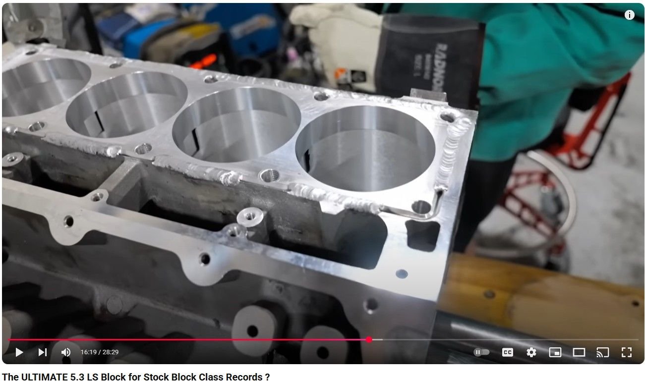

So in his latest video at about 14:16 he gets back into the block discussion about the deck.
Now I am pulling the next part a little out of context but he makes an important statement starting At 22:14 He states: "Some one has to help us develop all this stuff as far as some one has got to want to pay me to do it."
He does also mention that he has a few customer lined up for this process already. So he will be developing them.

1” billet deck……… is that the size before you mill the deck flat or after the milling? After milling, the is the deck height now?
Any fears of having your pistons out of the hole too much now?
Does he stress relieve the block ?
id still rather buy a new block.
Old Sep 6, 2025 | 03:27 PM
  #33
1FastBrick's Avatar
iTrader: (16)
Posts: 9,760
Likes: 656
From: JunkYard
You would have to ask Steve Morrison. It depends how far down that plate goes into the block. He leaves it a little high so he can surface after welding. Once it's all done, he mills it to the standard deck height of a normal LS block. Then final machines it for sleeves. Should be no issue with pistons too high or low in the block.
I dont know if Steve Morris stress relieves the block like Steve D. at R.E.D. actually does and some other companies claim to do. I has shown to be beneficial when doing that much work to a block.
Also, I have been thinking about it and There is no reason he couldnt make a 6 bolt deck plate and cut the block accordingly. He just chooses not to.

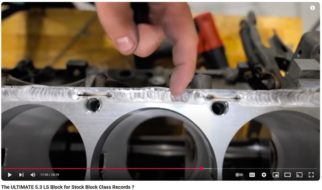

Steve is a smart guy, and I enjoy his tech often. My mind can’t get away from the billet plate being perimeter tig welded, which isn’t a deep weld at all, and then it’s put on a surfacer and cut down a couple 2-3 thou to make it all flat…just not enough weld penetration for my liking. Maybe Steve cuts this plate with a bevel edge and he’s “building up” weld penetration by making multiple passes with the tig? I hope so. Anyone here know Steve personally?
Old Sep 6, 2025 | 08:49 PM
  #36
1FastBrick's Avatar
iTrader: (16)
Posts: 9,760
Likes: 656
From: JunkYard
He is cutting a bevel on both the plate and the block for welding,
How Ever, I agree. I still don't believe he is going deep enough. He is only welding in a single pass and then a top pass to make sure its not under cut. No Pre or Post heat on the block from what I saw in the Video.

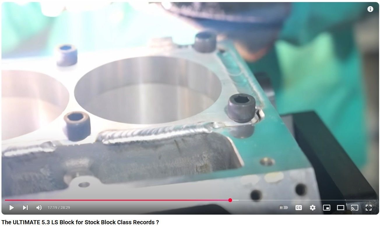

@Che70velle Look Close at the corner you can see it beveled on both the deck and the plate. Here some screen grabs for you.

Thanks for posting that. Meh…even with the bevel I’m not sold on the integrity here. That’s anything BUT a stock block at this point. The Darton sleeves are much stronger than stock and even out at 4.155” in a boosted build, they are plenty strong enough to contain a crazy amount of bewst. Seems like a great opportunity to have a coolant leak behind the sleeve, where that billet plate meets that cast aluminum sleeve, when up to temp. Instead of a single GM coolant tablet as I use with Steve’s RED blocks, maybe put several in this deal and pray for containment. But as I said, Steve Morris is a very smart guy. I’m pulling for him here.
I probably come off as condescending in some of my post about this... But I also do believe he is a smart guy.
In my opinion, I think he needs to go deeper with a root pass. I also believe he needs to stress relieve the block.
If you watch Gerald Brand at Brand Racing. When ever he does something on an aluminum head to a structural area, he peens the weld to relieve the stress.
