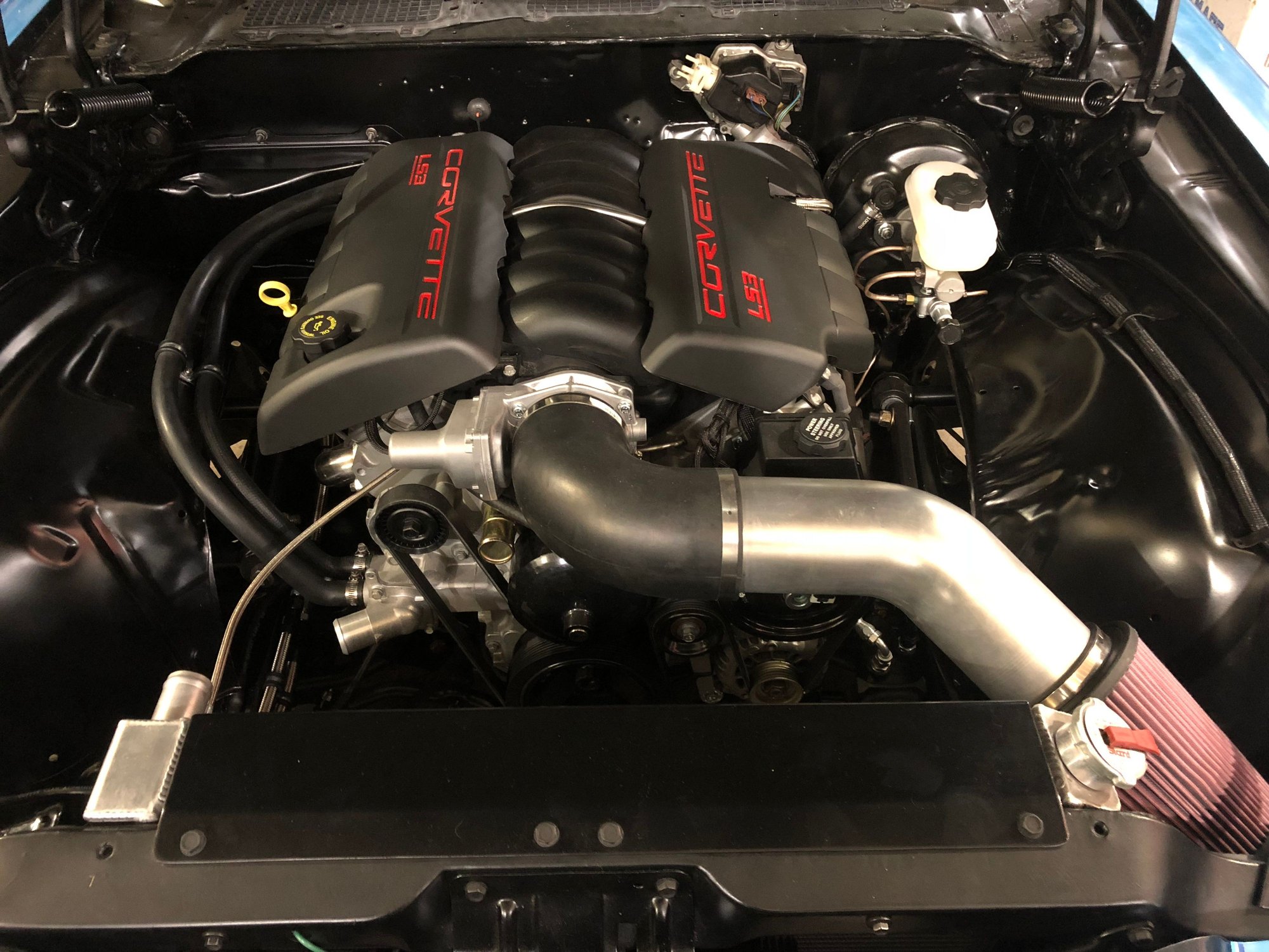

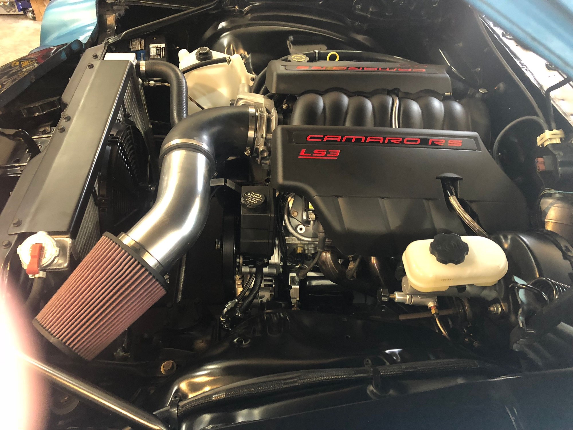

I've done a couple L92 LS swaps. No DOD L92's. Both were low mileage engines about 25K on each.
I went with a Texas Speed vvt delete. Texas Speed cam. 225I 230E .600? lift. Upgraded dual valve springs/retainers and push rods. Retained the stock L92 lifters non-DOD lifters.
Sourced a used LS3 intake, DBW throttle body and 42 lbs injectors.
Howell and Speartech ecm's/DBW throttle pedals and engine wiring harnesses. One from each. Both needed a proper tune after install.
Pic of my current 80 Camaro with a L92 swap. And my orange 73 Z28 with a L92 swap.

Nice work on both swaps!

Thanks for the kind words.
The 73 went down the road a number of years ago to make way for other projects.
I still have the 80.
Great project that I bought about 4 years ago. Note the inserts on the coil covers I made.

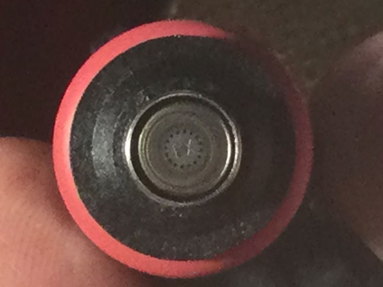

Hey Matt, On my G8 I'm swapping to the L77 injectors, still 42# but with 16 holes instead of 4.
How comes, is there any advantage to 16 holes over 4? Or are these just what were readily available?

The atomisation is better. They can handle E85. The finer spray means a more complete burn of the fuel. Better mileage cruising, more power WOT.
