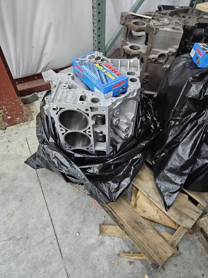

I am having an engine built for my Corvette. Presently it has the factory LS3. I am looking to get into an engine with forged parts and maybe a few improvements/upgrades.
The block is, or used to be, a 5.3L and is now sleeved and bored to 4.125".
ARP studs for the mains. Line bored.
DART Pro1 LS 280/68 heads that will get some touchup.
Callies CompStar rods and 8 CW 4" crank ---> 427 ci.
Diamond pistons. The compression will be 11:1 or so.
No gold plated/Gucci parts. Just a modest little build so I can relax and enjoy getting on it now and then.

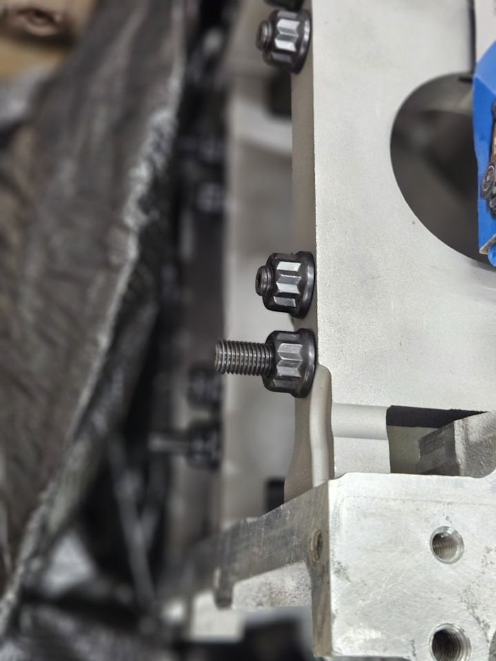

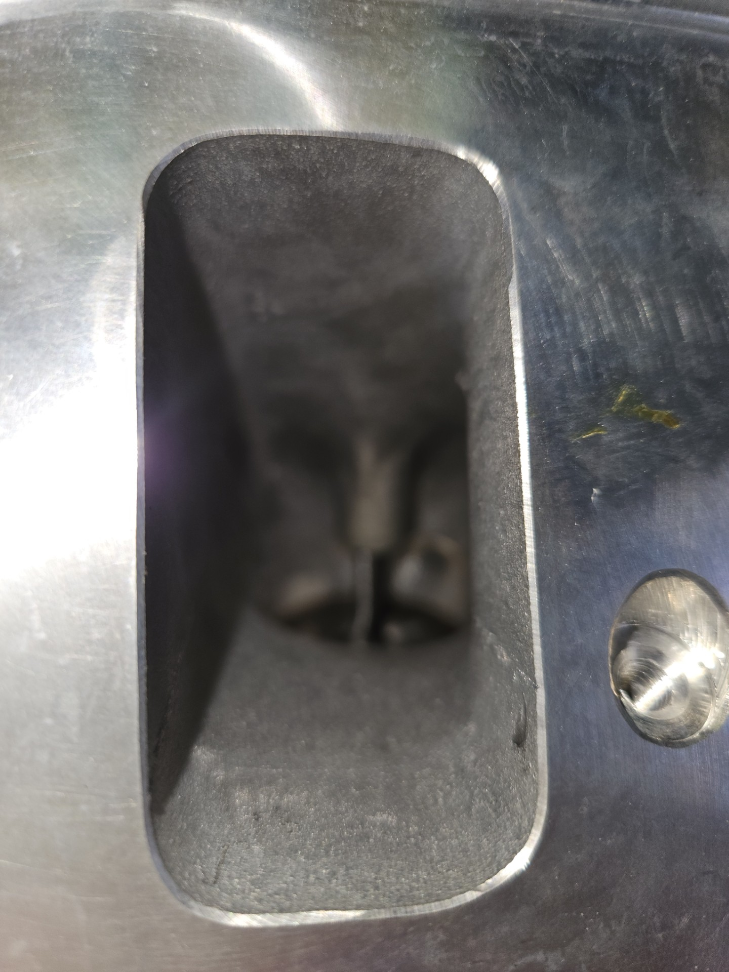

I finally got a good look at the engine today. When I picked it up from Bischoff it was well wrapped in plastic and I left it that way.
Casting number 12601900
Date code 72611
5.3L aluminum block
CompStar dual keyway 8 CW crank and extreme rods
Diamonds Modern Muscle forged pistons, 11.375:1 static CR
Dart Pro1 LS 280 heads
Ferrea valves, BTR springs
Morel 5290 tie bar lifters
Front of Bishoff 5.3L/427 sleeved block
DART Pro1 LS head intake runner
DART Pro1 LS head 280 intake runner
BTR rockers w/TK002 trunnions
AMP dual roller thrust bearing timing set
