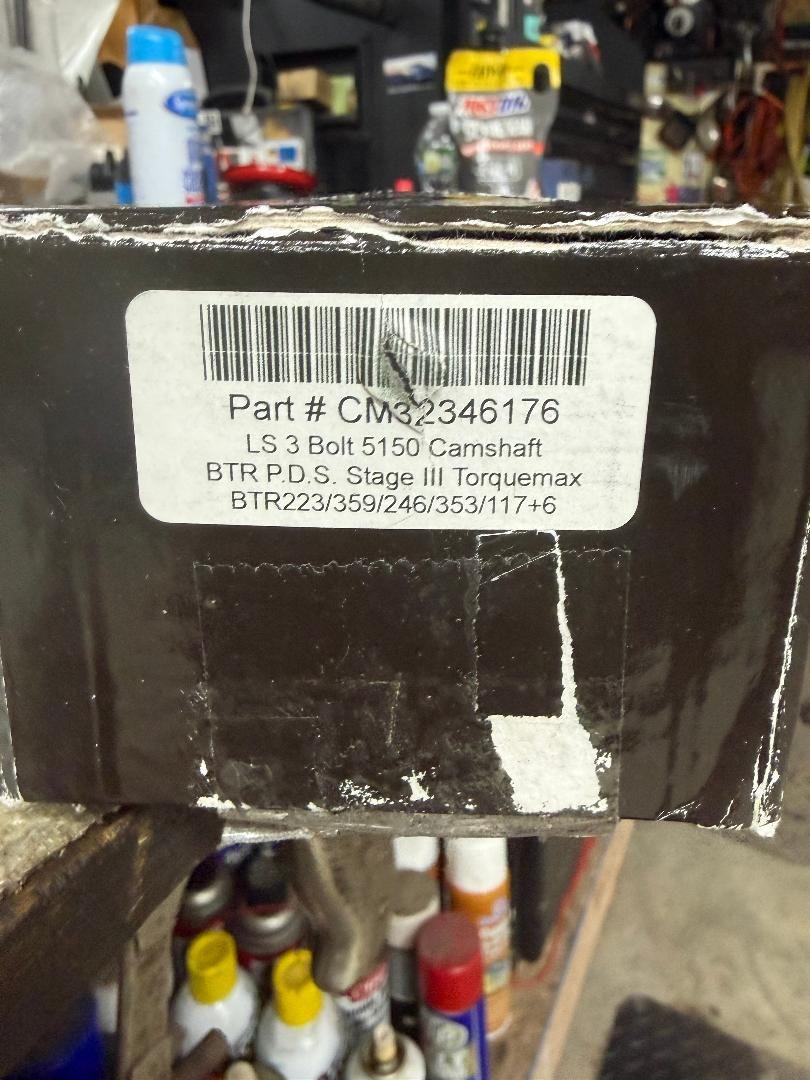

Old Jan 14, 2026 | 03:41 PM
  #35
Joe's 2SS's Avatar
Joined: Dec 2025
Posts: 37
Old Jan 14, 2026 | 03:42 PM
  #36
Joe's 2SS's Avatar
Joined: Dec 2025
Posts: 37
So above I posted the BTR Stage 3 Torque Cam V2, I made a mistake and don't have the V2 I have the original, Can you tell me if this is a decent cam and how it compares to the GPI Stag 2 PD cam I linked to above.
I also sent Blower to Kong for porting and ordered a NW 103 TB.
Old Jan 15, 2026 | 09:42 AM
  #37
old motorhead's Avatar
iTrader: (10)
Joined: May 2006
Posts: 1,534
Likes: 243
From: SE TEXAS
If you already have the BTR cam, run it. With overlap at around "0", manners/drivability should be good with a decent tune. It has enough duration to make good power. Also, lift isn't extreme so valve train life shouldn't be compromised. I'm sure the GPI cam would fit some circumstances. I wouldn't use it because of the big overlap numbers and higher lift than I'm comfortable with. I don't think it's a good fit for you either.
Old Jan 15, 2026 | 10:12 AM
  #38
Joe's 2SS's Avatar
Joined: Dec 2025
Posts: 37
Gotcha, I am not looking for some crazy chop or fuel smell issues or bucking and surging and what not.
Old Mar 21, 2026 | 08:50 AM
  #39
Joe's 2SS's Avatar
Joined: Dec 2025
Posts: 37
Hey guys,
SO I am getting ready to start the work and I am still struggling with Cam selection. The BTR PDS Torqumax Stage 3 that I posted in Post #35 is the one I am leaning towards at the moment since I have it, But I would hate for $400 ( Cost of new cam ) to make my car un enjoyably. I am looking for a well running enjoyable car with good manners, with a proper tune do you guys believe that is achievable?
Thank you
PS NW 103 and ported Kong SC have been added.
