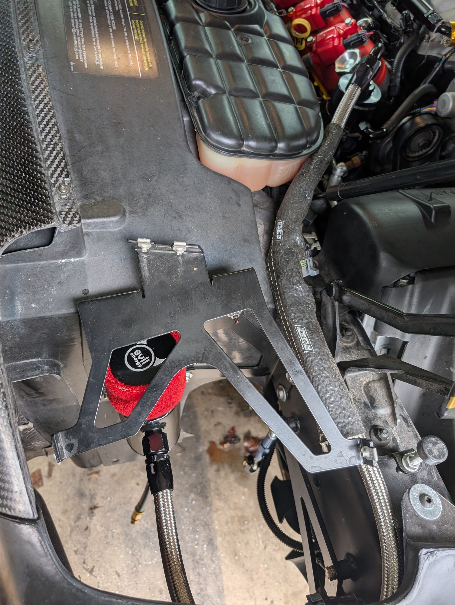

Originally Posted by spanks13
The baffling is way better than any aftermarket solution. I don't know if I can link it here, but they're available from michigan motorsports for $150 a pair with gaskets and bolts. The baffle design is similar to LS3 valve covers, but the top of the cover is bumped up to accommodate a larger baffle volume without impinging on the rocker arms. The underside clearance is the same to an LS3. Also nice that the coil packs bolt directly onto them without a bracket, so they're a bit cleaner looking.
You can see the oil/vapor needs to travel from one end of the valve cover to the other. The red cap is the factory quick disconnect. There's a company selling press in 10AN fittings. You remove the stock fitting and drill out the hole to 9/16" and press in the 10AN. The factory fitting is for 3/8 lines, but the ID is less than 1/4".
I've had Holley, BTR, modified BTR, and now these. Road racing and autoX is a royal pita for oil control. I'm at the track again this Saturday and really hoping I can get through the day without oil drama lol.
And yes, we welded an exhaust extractor into the exhaust pulling on the top of the catch can. MightyMouse sells a remote exit that replaces the air filter with a 10AN cap. I had the can overfill a couple times with the exhaust extractor and all I had was some oil residue on my rear bumper instead of half a quart of oil inside my engine bay lol. Honestly got very lucky that nothing hit the headers and decided to flare up. MightyMouse recommends relocating the breather behind the car or into the airbox for road racing and I see why.
Sorry for the derail, this hits close to home lol. I feel your pain OP.
Optimized image
I switched to Summit LS3 style covers last year as I was filling the can more and more after I added aero. I too have a MM catch can, but instead of routing it to the exhaust it goes to another vented can. I also added a drain to the MM can to drain back into the pan after a session. When I added the aero I was filling the can and spraying oil like you after 2 TT sessions. With the current setup I never had to empty the second can. It was always dry (I would get some condensation once in a while but no oil).
If you follow the -10 hose it goes from the can under the headlight area back to the pass side head.

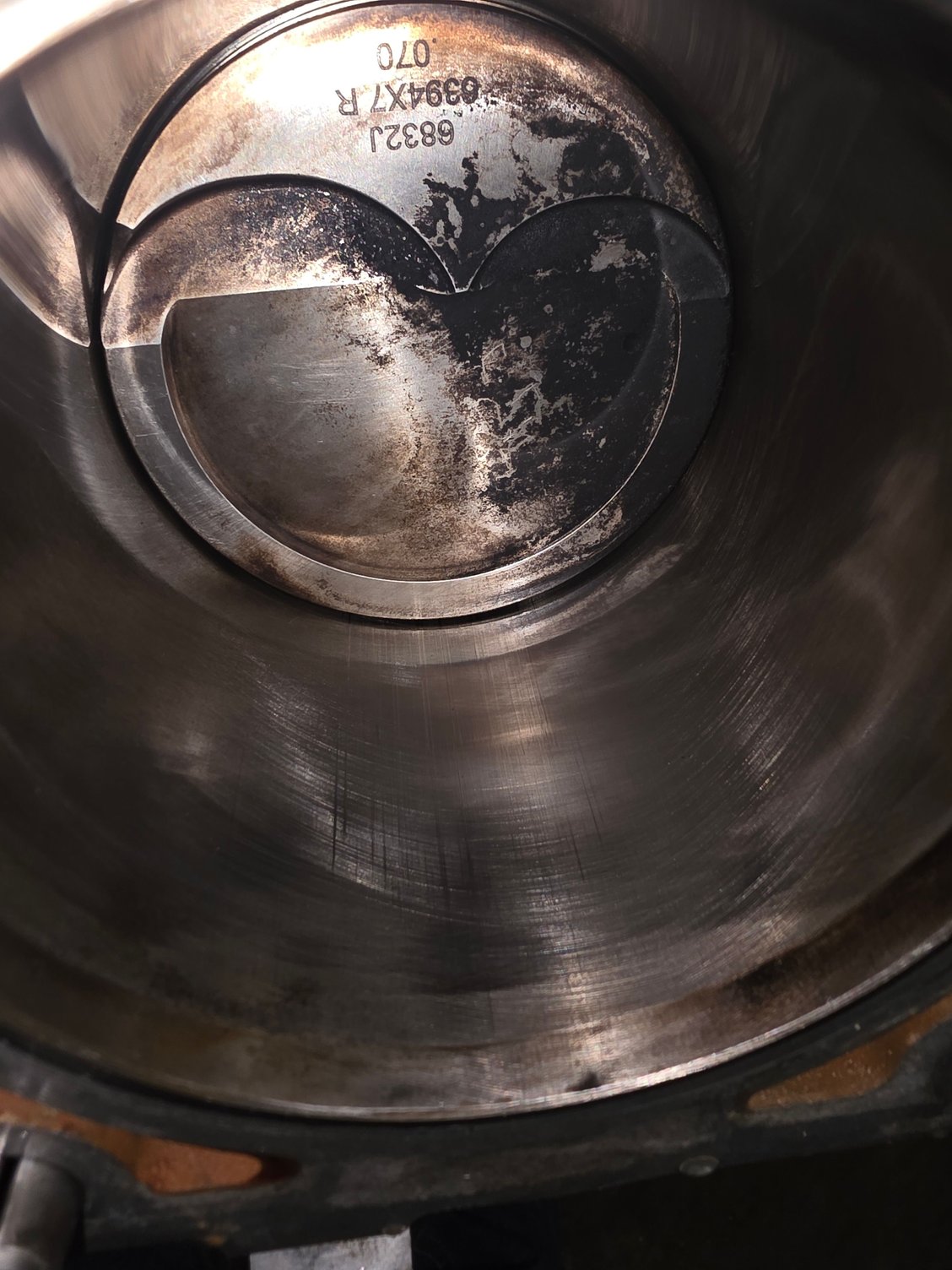

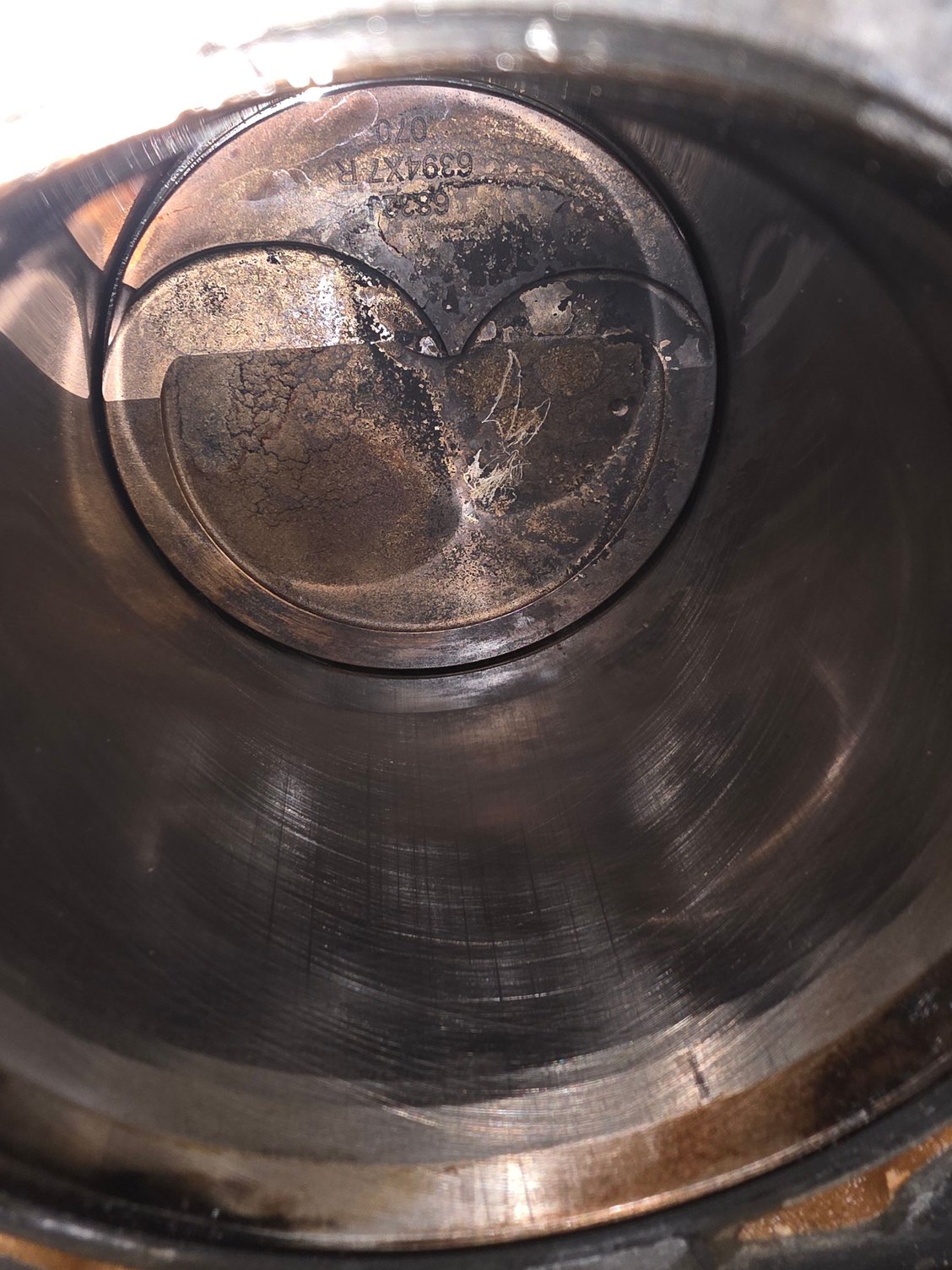

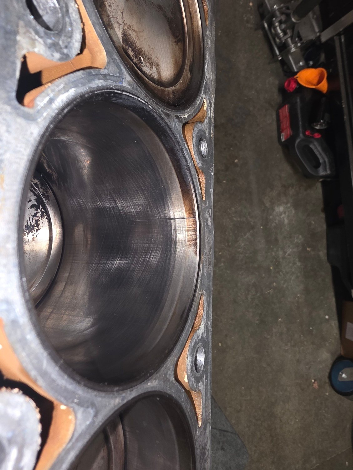

Old Feb 28, 2026 | 08:17 AM
  #38
65LSXNOVA's Avatar
Joined: Apr 2021
Posts: 245
Likes: 107
From: New Athens IL
#3 barely catch that scratch with my nail
#1 and #8 cylinder 10% and 16% leakage on those.
Old Mar 1, 2026 | 07:36 AM
  #39
Double06's Avatar
Joined: Apr 2012
Posts: 766
Likes: 284
From: Potomac, MD
hard to tell from photo but about 2 inches down does it look kind of shinny with the hone marks mostly gone? In the 6 o'clock or 12 o'clock position of the piston.
