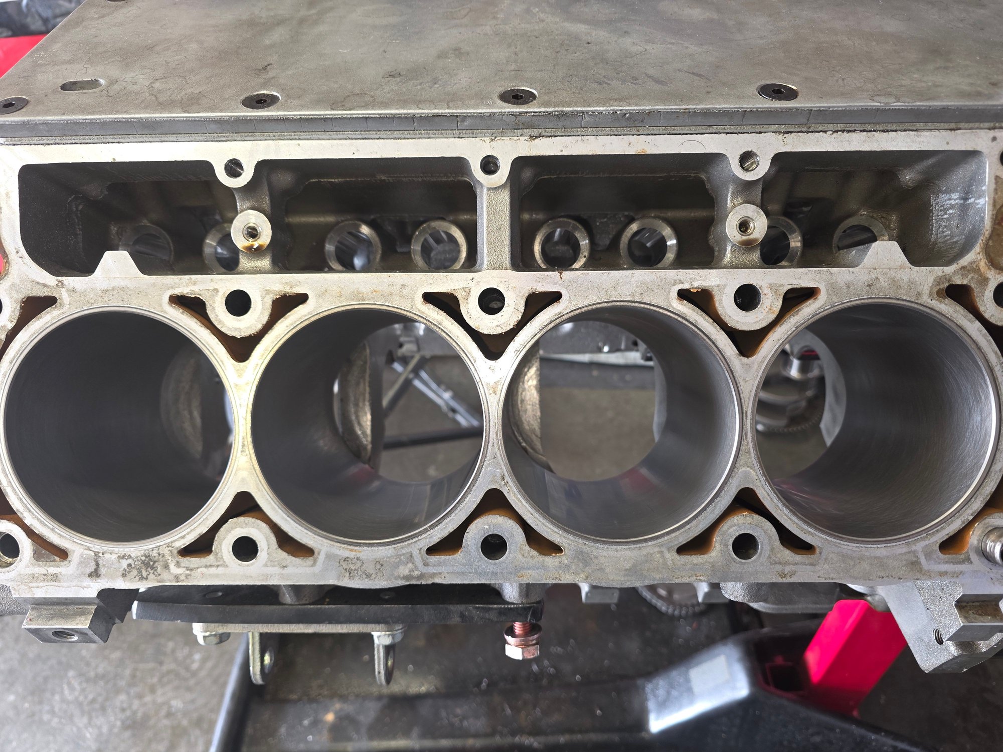

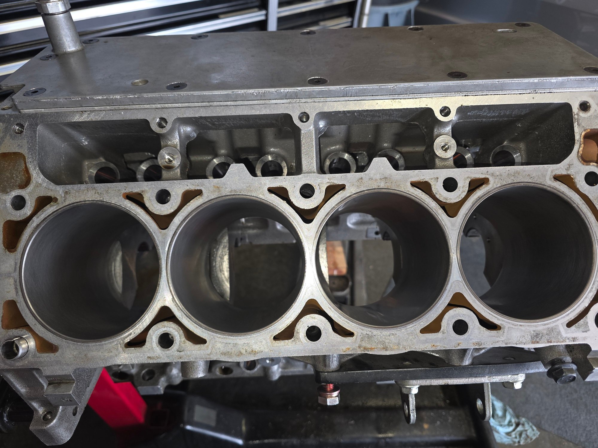

Im at a cross roads right now. After doing a leak down on my 416 I tore it down and found a few scratches on the bores but nothing too bad. The block is already 4.070 and I see it has some core shift of the sleeves.
im thinking two different thoughts, 1 say **** it and diggle ball hone the block and re-ring and bearing it and send it. Or 2, sleeve the block from someone like R.E.D and put new pistons and rebalance it.
I know the 5.3 048 block is the better option to sleeve but I dont have one, but i do have this LS3 block.
I dont have a ton of time as the car has to be ready by late Sept for SICK 66.
If i sleeve it, i think id go 4.125 bore so im not so sure the core shifte will matter as much, but i could be wrong in my thinking.

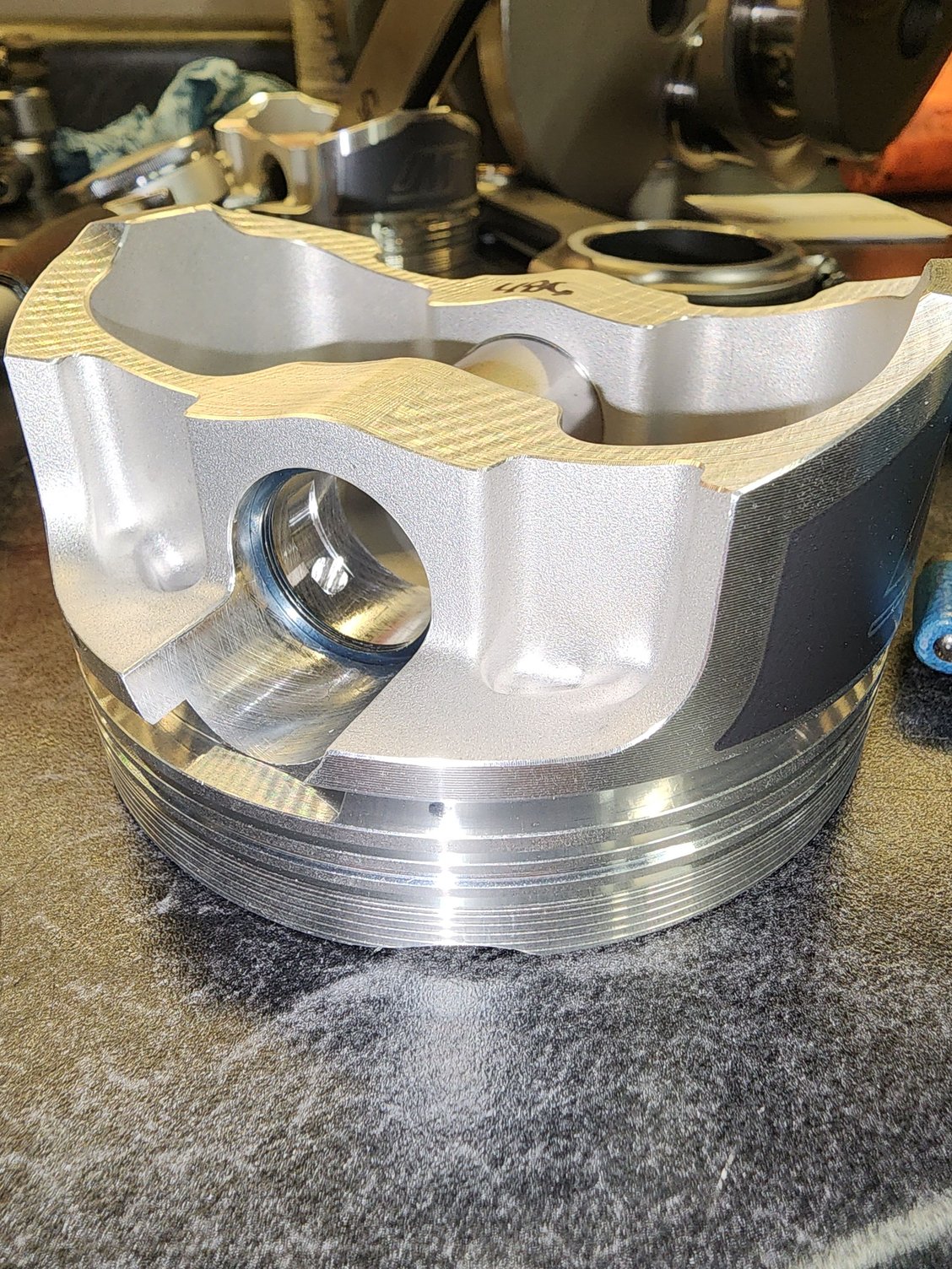

here is my wiseco pistons 4" stroke 6.125 rod and a 1.115 ch

There you go. I have seen some piston sets come with "oil support rails" to try to mitigate the oil ring flexing. How effective it is in reality, idk. I just know the longer I do this, the more I believe in what Hi-O said "Don't screw up what GM gave you". I'm planning my LSX build and I'm either going to figure out a better rod/custom piston combo on a OEM type LSX 454 4.125 crank or just put a 3.900 crank and off the shelf 6.125 rods in it and go. I won't build another LS for myself that has a pin hanging out in the ring land. Doing this is way too much $$$, I want to maximize my fun.
